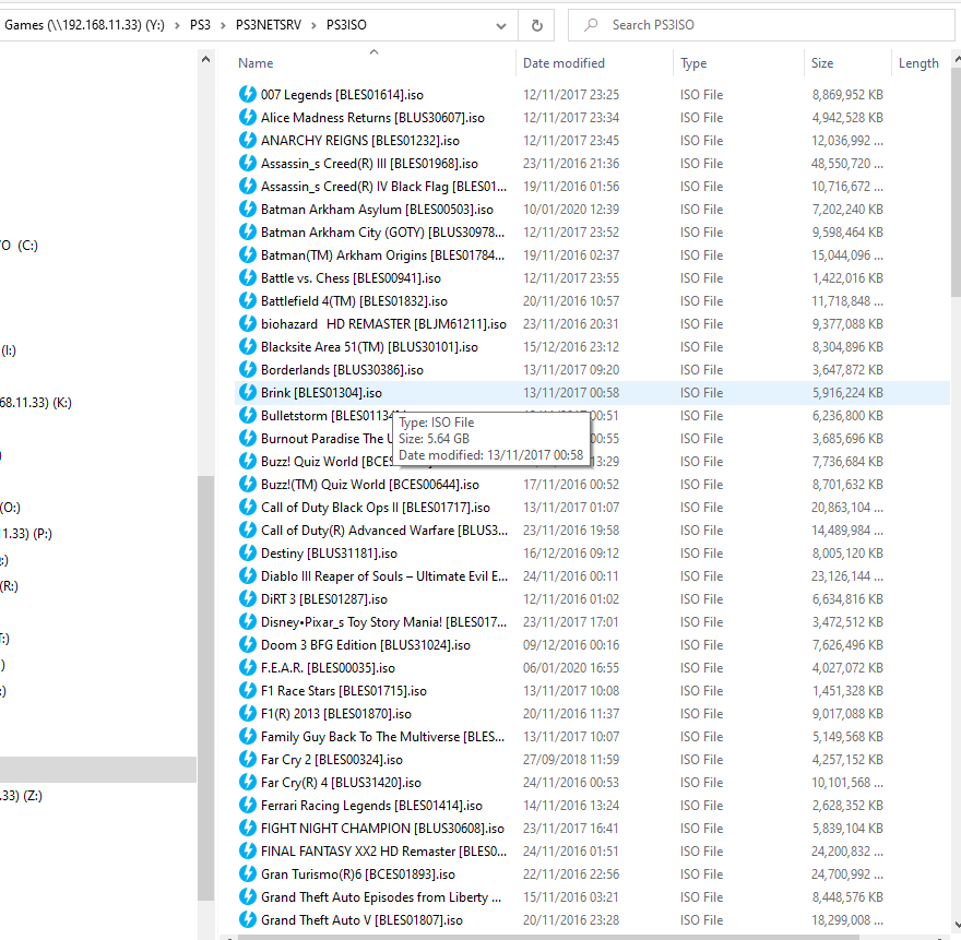

Hey guys, to all that are trying to get Shawly's up and running, here is what I did to get it to run.
1st, add Port variable of 38008
2nd add Data Path called /games and point it to the folder that holds your ISO folder (which must be called PS3ISO, this is where I was messing up), not the actual folder with the ISO's in it.
3rd go into WebMan setup and turn of scanning of LAN, and input your Unraid server IP address.
4th Save and restart PS3
PS.  This is where I ran into issues.  It may be due to having almost 8 TB of ISO's and over 900 titles, but IRISMAN crashes, and I can only access the games via WEBMAN web setup under games/net.  But even then it only showed 180 games.  I'm going to reach out to Aldostools and talk to him about it, and see if there is a size/quantity limitation or something.  But if you have a smaller amount, maybe it will be fine.  To test whether the docker is an issue or ps3netsrv, I'm going to install a Windows VM and test it that way and see what happens.  Just wanted to help out anyone trying to run this, because it took me several hours to figure it out with the help of Shawly himself, who was awesome by the way.

Could you possibly show me a picture of your docker config? I still can’t get it to recognize my games. Thanks
Yeah, i wouldn't mind seeing this also! seems i got the folder structure right, wouldnt mind seeing an example layout just incase im double nesting by mistake.
Thanks Dudes.

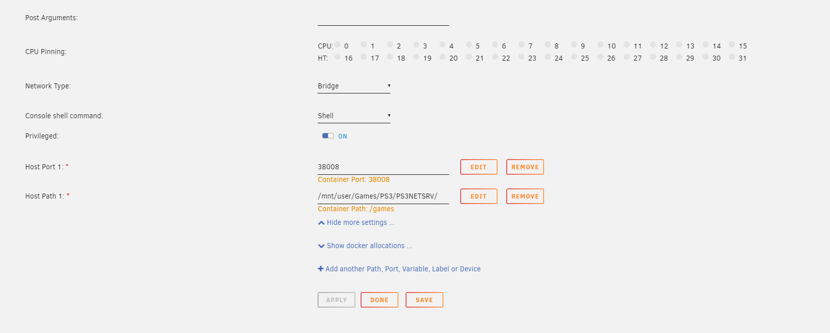

Heres mine

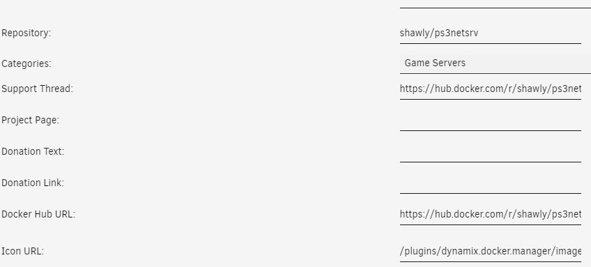

Could you post a screenshot of your template for docker as well? Thanks so much for this by the way!
Not much to it to be honest, here is the only part of the template that is configurable
