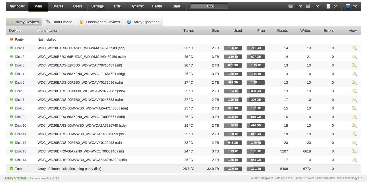

when i looked the Web GUI, i found all drives to be green...i un-assign the parity drive and started the array to see what its condition is and found it to start into a work-able status (see the attached screen-cap).
*however*, as you can see, Disk 13 has a high number of Reads and Writes, probably left from the failed attempt to rebuild it from parity, and looking at the contents of my system through Finder, i can see that Drive 13 is the only one that has a "lost+found" folder on it that contains 63 cryptic folders with about 12GB of dis-jointed data-fragments in it...not a huge amount, in the big picture, but i guess any lost data is not a good thing, considering i don't really know what most of it is.

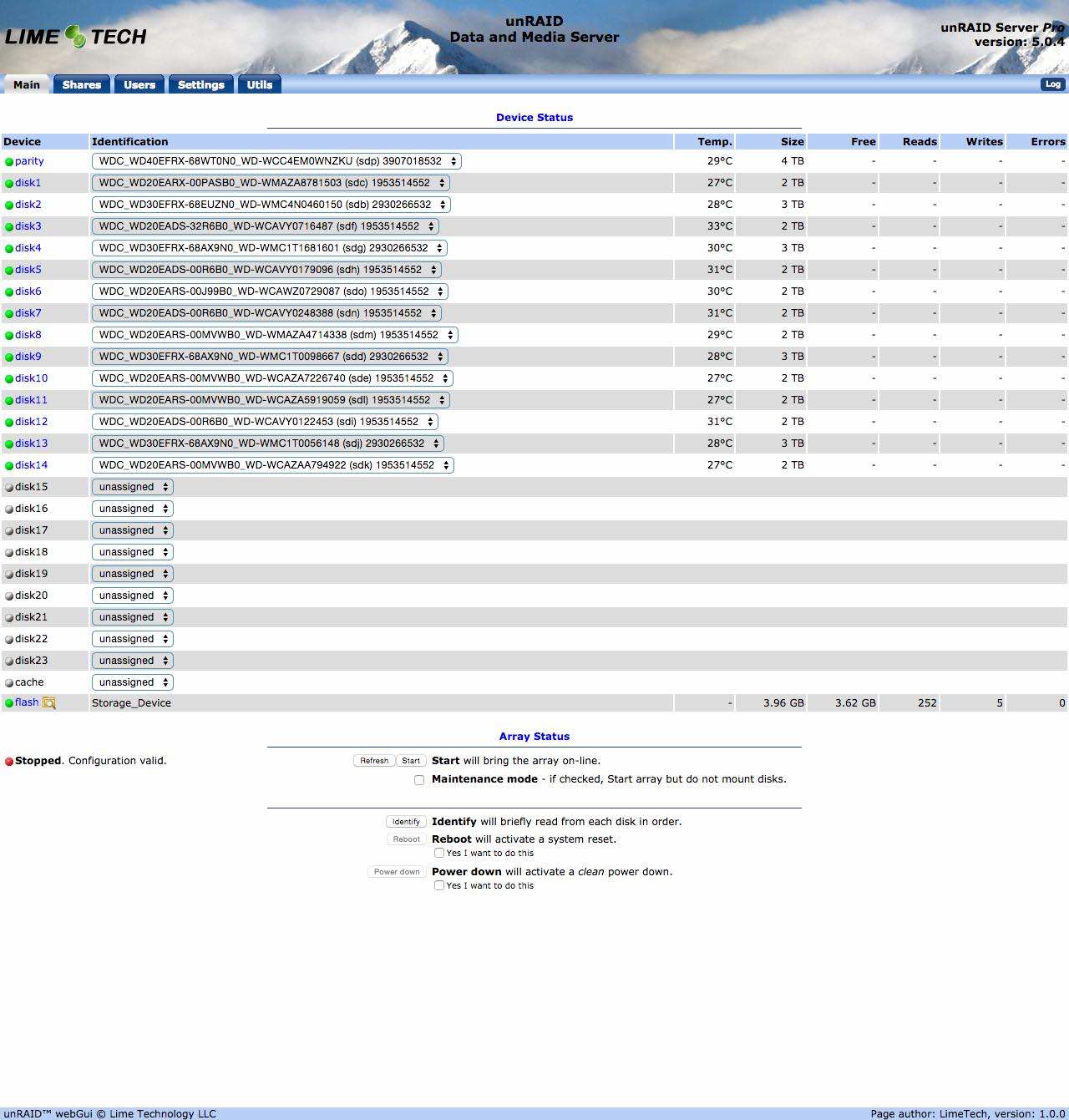

hmmm...i hope i didn't make another mistake, but here is what i did since my last post:
> waited for Disk 13 to be backed up to an external disk
> did a "New Config" and re-assigned all disks as they had been
> (here is where i got very apprehensive) the instructions for rebuilding a disk say to first type the command - in my case "mdcmd set invalidslot 13" - then  click the "Start" button in the Web GUI...*however*, since the default option in the Web GUI is to Start the array and immediately do a Parity Sync, and the option to trust parity is not enabled, i was worried that if i followed the instructions i wouldn't get a chance to keep parity as it is and rebuild disk 13 from the *old* parity, but rather have the "lost+found" data from disk 13 written to the parity...so in order to tell the system to trust parity i *first* started the array with the "parity is valid" option and *then* tried to execute the "mdcmd set invalidslot 13"...i wasn't too surprised when nothing seemed to happen, so after waiting 10-15mins i stopped the array again, then tried to execute the command again...but again, nothing seemed to be happening.
now, i still haven't touched Parity...it says "Parity has not been checked yet" in the Array Operations tab, and for now i un-checked "Write corrections to parity disk" next to the "Check" button, but i am not very confident at all that i did this correctly or that i haven't closed a door here  that would have allowed me to do the re-construction of disk 13 to what is on the old parity drive...but i do have hope that it may still be possible...it's just that i know so little about the command line that i do need your help to get this invalidslot command to work for me...if it isn't too late.
i'll leave it as is for the night...i'm hitting the sack, but hope to continue this in the morning, if i get the instructions i need...again, sorry if my inexperience got me on the wrong track again.

i do not have a keyboard and monitor on my unRAID yet, so i executed invalidslot from a command prompt that i used to telnet into the server.
and like i said, the "Trust Parity" option, as you call it (it said "parity is valid" next to an empty check-mark box in the Array Operation tab) was grayed out, and since the instructions seemed to assume a proper protected state with valid Parity, i was concerned that if i didn't have that first, it would start rebuilding parity first.
be that as it may, the fact that "Parity has not been checked yet" should mean that i still have the same Parity information that i did before i did the New Config, no?
*if* that is the case, and since the invalidslot command doesn't seem to do anything (at least i see zero feedback in the telnet session of the Web GUI), how could i "fake" a state of Drive 13 that would trigger unRAID to want to rebuild it? i know that, in theory, the invalidslot command should be the most direct way to do this, but if it isn't triggering anything in my particular situation, what's the next best method? shouldn't it be possible to just "clear" or "format" the drive outside of the array and then have it be rebuilt as a replacement disk for the old Disk 13?
i have no idea why that command didn't seem to do anything, and i did not navigate away from the Array Operation page since last night, when i executed that command...i did read those instructions very carefully and did notice that "IMPORTANT:" addendum...trust me, i've been extremely careful with every step, but i am aware that due to my lack of experience, there is always a chance that i mis-understand certain steps...and the one last night, where i didn't want the array to start before Parity was trusted, may have been a wrong step.
I've never done this with Dynamix ... so I tried it tonight, and it does NOT seem to behave in accordance with the guidelines Tom gave.
I tried several different approaches to force a rebuild, but simply wasn't successful.  I did the following, which is about as close to Tom's suggested steps as you can do in Dynamix:
(1)  Went to Tools - New Config; checked "Yes I want to do this" and clicked on Apply
(2)  Went to Main and assigned my disks (including Parity)
(3)  Went to Array Operations and checked the "Parity is already valid" box
(4)  On the UnRAID console (you could Telnet since you don't have one) I typed the mdcmd line to set the slot invalid
(5)  I Started the array.
The result was an immediate parity check (which I immediately aborted).
I tried that several times with slight variations ... but was never able to force a rebuild.

unfortunately, the behavior under the stock Web GUI is just like under the Dynamix Web GUI: nothing happens.
when i hit the "Start" button, the array is started and in an all-green state...if there is any rebuilding going on (which i strongly doubt), there is no feedback given in the Web GUI or the terminal window.
Parity still shows as "valid", but the system knows that "Parity has not been checked yet.", suggesting a Parity check, which i will *not* do until after a successful rebuild of Disk 13.
