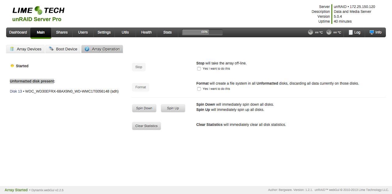

HELP!! unRAID 5.0.4 with 1 drive unformatted, parity drive 2 errors
Phew, i'm a bit stressed...my girlfriend arrived at Berlin airport from San Francisco last night, where she checked in my carefully wrapped up unRAID server with 15 disks (32TB)...first thing that went wrong: luggage was lost...this morning we got the call and suitcases (hers and mine).
Brought the system to my office here, and right off the bat the parity disk couldn't be found (all other disks showed up fine)...opened up the case to check connections and found one SATA connection at the drive cage had come loose...made sure it's in tightly, brought the machine back up, parity disk now showed as present, all other disks as green, but parity showed as having to be re-calculated...so i started a parity check and when i returned an hour later, the parity check had stopped, with an error.
Unformatted disk present:
Disk 13 • WDC_WD30EFRX-68AX9N0_WD-WMC1T0056148 (sdh)
the disk was definitely present and green when i started the parity check, but now this.

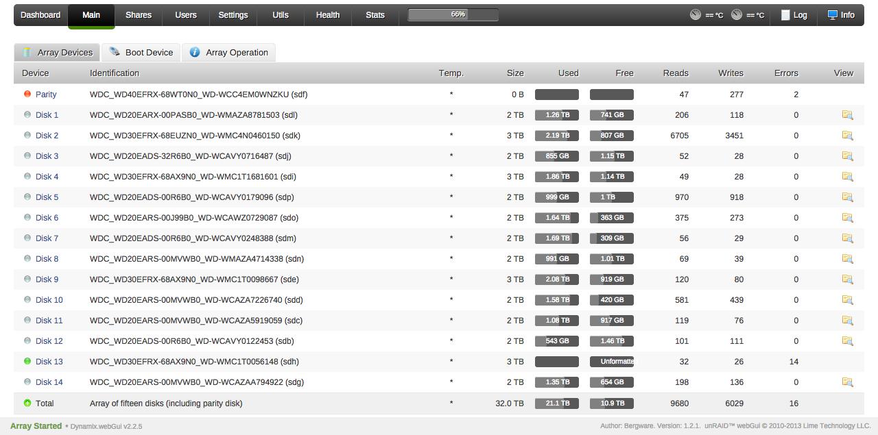

when i look at the Array Devices panel i also see that missing disk 13 shows 14 errors and Parity shows 2 errors.
needless to say, i am now a bit freaked out about what to do next...or rather, i'm afraid of doing *anything* before i haven't consulted the forum, as i always did all these many years.
what is the safest way to proceed now?
i attached the screen-caps of Array Devices and Array Operation and the newest Syslog.
i hope somebody can give me a pointer as to which way to go next!

Hopefully this is just another loose connector or cable.
But unfortunately you've already lost any possibility of re-building the disk, since you did the new parity sync.
So I'd do one of two things:
(1)  Reseat the cables for disk #13, and if it's in a hot-swap cage, remove it and re-seat it.  [Not a bad idea to do this for ALL drives since the system was shipped]    Then do a New Config and assign ONLY your data drives to the configuration ... and see if it's now shown okay.    If so, confirm that you can "see" all of the data on your array okay -- and then assign the parity disk and let it do a parity sync.    When the parity sync completes, be sure to do a parity check to confirm all was okay.
If that doesn't resolve the disk #13 issue, then I'd do this:
(2)  Do a New Config WITHOUT including the problem disk and let the system do a parity sync.  You may still want to do the reseating of drives/cables and configure without parity first ... just to confirm all is otherwise okay.    Then I'd connect the problem drive to a PC using the free LinuxReader [ http://www.diskinternals.com/linux-reader/ ] to access it, and copy any data you can recover to your newly configured array.
Not sure how you packed your system; but for future reference, I always remove all drives and pack and ship those separately from the system.  Puts much less stress on the case and better protection for the drives.
Note that if neither #1 or #2 works, you've simply lost the data on drive #13.    Your mistake was in starting the parity calculation after it had initially been "missing".    You COULD have done a "New Config" at that point (after reseating the cables) and used the "Trust Parity" option to force UnRAID to use the existing parity drive.    [i assume you did a parity check BEFORE packing the system for transit to confirm all was well before disassembling it.]

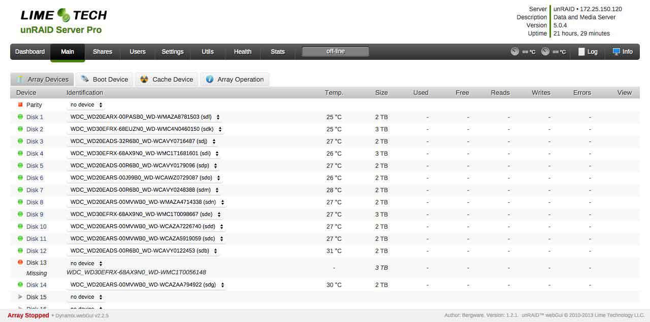

ok, back at my system.
first things first...before i did anything, i took another screen-cap of what the array looks like in my WebGUI (screen attached).  then i did a clean shutdown, triple checked all SATA cable connections and re-seated drive cages 13 (Drive 13) and 15 (Parity) and booted it back up...
after the server came back up i was quite surprised and encouraged that i got what looks to be a rather promising array state (see second screen-cap, and for good measure i *wanted* to attach another syslog, but right now i don't seem to be able to see any of the shares in my finder...i thought tha Flash share always showed up, even if the array wasn't started, but right now i don't seem to be able to connect to the SMB or AFP shares of my unRAID and am afraid of doing anything that could compromise my current state).
having learned *something* from my actions yesterday, i will *not* do *anything* until i get further instructions from the seasoned forum members here...please let me know what step to take next...i hope this is the break i was hoping for!

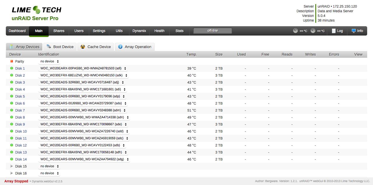

dammit!! because the drives started to show severe overheating, i closed the case up again and put it upright, and when i looked at the WebGUI again i saw that the Parity drive now disappeared again (see attached)...i didn't think that i could hurt anything by putting the server back into a position where cooling would work properly, knowing that it might be many hours before i get further instructions.
did i mess up again?!

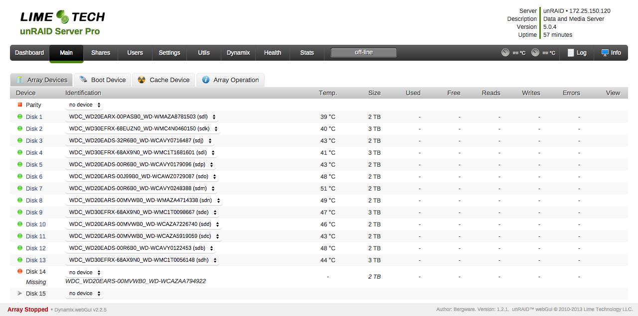

And now Drive 14 is also showing as "missing" (see attached), and temperatures *still* hover in the high 40's (celsius) with Drive 7 at 51...good grief!
what would be the safest way to get a syslog off my flash drive to share with you? i'm afraid to put the machine on its side to open it up and get the flash drive from the motherboard, into which it is plugged.
my gut says "clean shutdown, check all cabling again, re-seat drive cages again and boot up again", but i'm not going to listen to my gut until i get your input.
damn, this is stressful!
PS: i ended up taking the Flash drive out and putting it on my Mac...the latest syslog has ballooned to a mighty 139MB, but here is a link to a compressed 5.9MB version on my dropbox: https://www.dropbox.com/s/4343m98mvu41l93/syslog-20150126-193319.txt.zip?dl=0
If this high temperature condition is a new thing, You really need to figure out why you have this problem.  Are all the fans (case and CPU)  running?  Is there a lot of dust and dirt inside the case.  (I assume that your power supply is rated for 100 -240 volt input or you have reset the switch to to 240 volts.)  High temperatures can cause electronic devices to become flaky.
not totally new, but it hasn't been quite this bad...i'm trying to make it back to a protected and complete array, then i am evaluating how i might be able to back up the entire data pool and tweak this case to be within proper specs again.
and yes, it is a 110-240 supply, auto-switching with all fans running and a mostly dust-free interior...i'm still cleaning it up more, but i think the high temps are mostly due to sub-optimal drive cages and fans, which will need an upgrade soon (maybe an entirely new case with less but bigger drives).

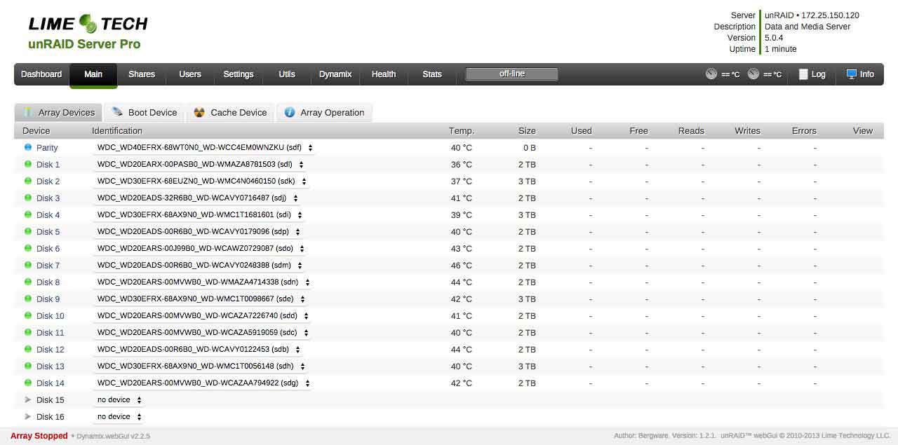

OK.  Let's take a minute and look at the situation.  As I reviewed your screen captures, it appears that the 'defective' drives keep changing and/or then appear and disappear.  Drives don't just change from good to bad and back again in a normal situation.  Since you have fifteen drives in your system, one possibility is a power supply issue.  Remember, you went from 120 volts to 240 volts and that probably changed the conversion efficiency of the supply.  An another thing, does the power supply have a single 12V rail or is a dual rail supply?  (Single rail supplies are recommended for servers with large numbers of drives!)  Flaky 12V rails have caused problems that look like this for people in the past.
I would also bet that ALL of your drives are good and the data is there on each drive.  You might want to consider rebuilding your physical system and simply use those drives in the new case and drive enclosures.  (I, personally, would recommend using front loading drive enclosures so you can change drives without having to open up the case!  This prevents problems that have occurred when moving cables to change one drive loosens a cable to another drive.)
