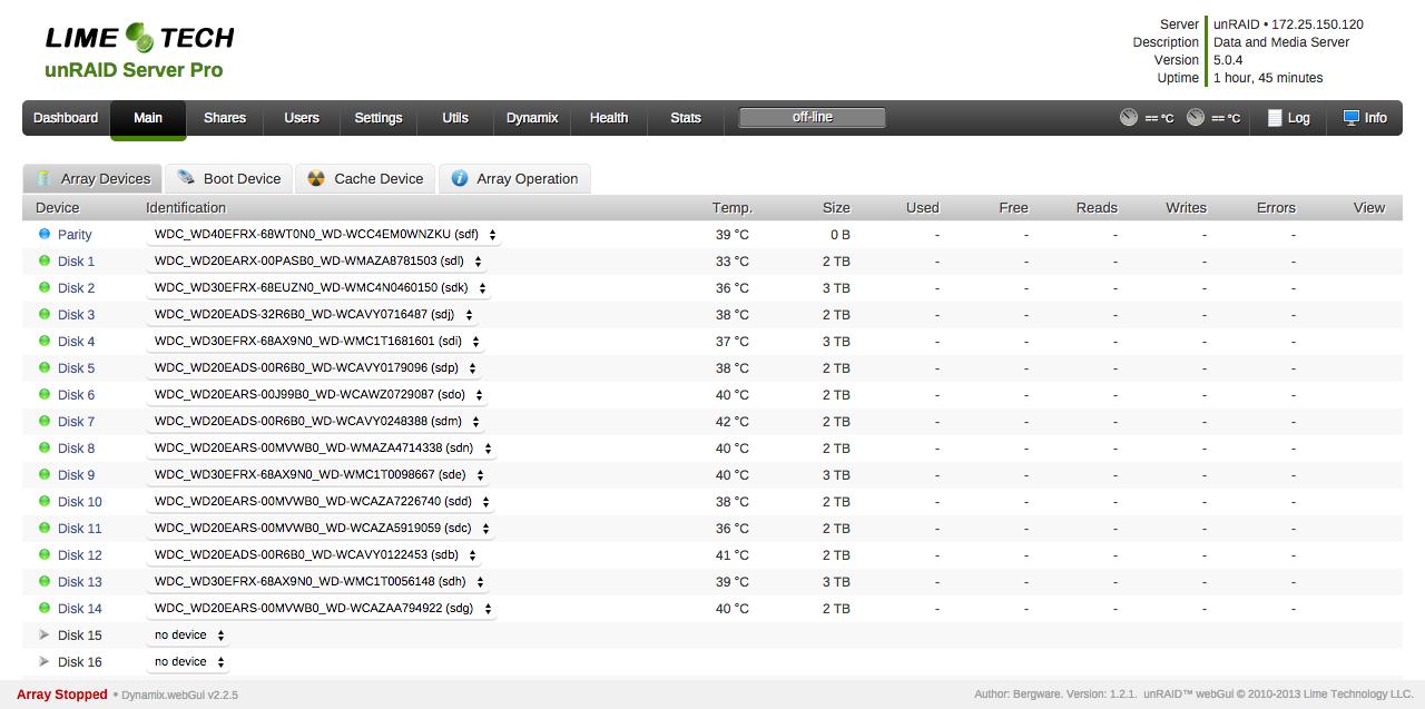

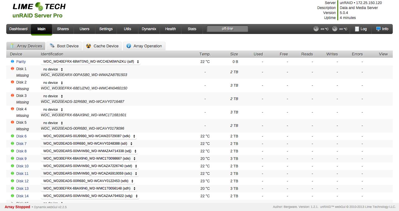

jeeze, now i am really confused (as if i wasn't before)...while removing drive cage #3 and unplugging the SATA cables from the back, i found that the front-most SATA cable had the actual horizontal prong *from* the case stuck in the horizontal slit of the male end of the cable...it had broken out from the female plug of the case, which would explain the flakiness of the connection(s).
*but* after i unplugged everything from the old cage and inserted the new cage, then connected all the cabling again, transferred all 5 drives and booted up the server again, it came back with a very unexpected condition, which really baffles me...it appears as if the cage i removed held the *first* five disks (1-5), not the last 5 (10-14 + parity)...see the attached screen-cap.
i must have gotten something really mixed up here, or maybe i inadvertently disconnected cage #1 in the process?
ok, back to the drawing board...i'm gonna have to take another careful look at what's going on, but just wanted to give a quick update of where i am, frazzling as it is.

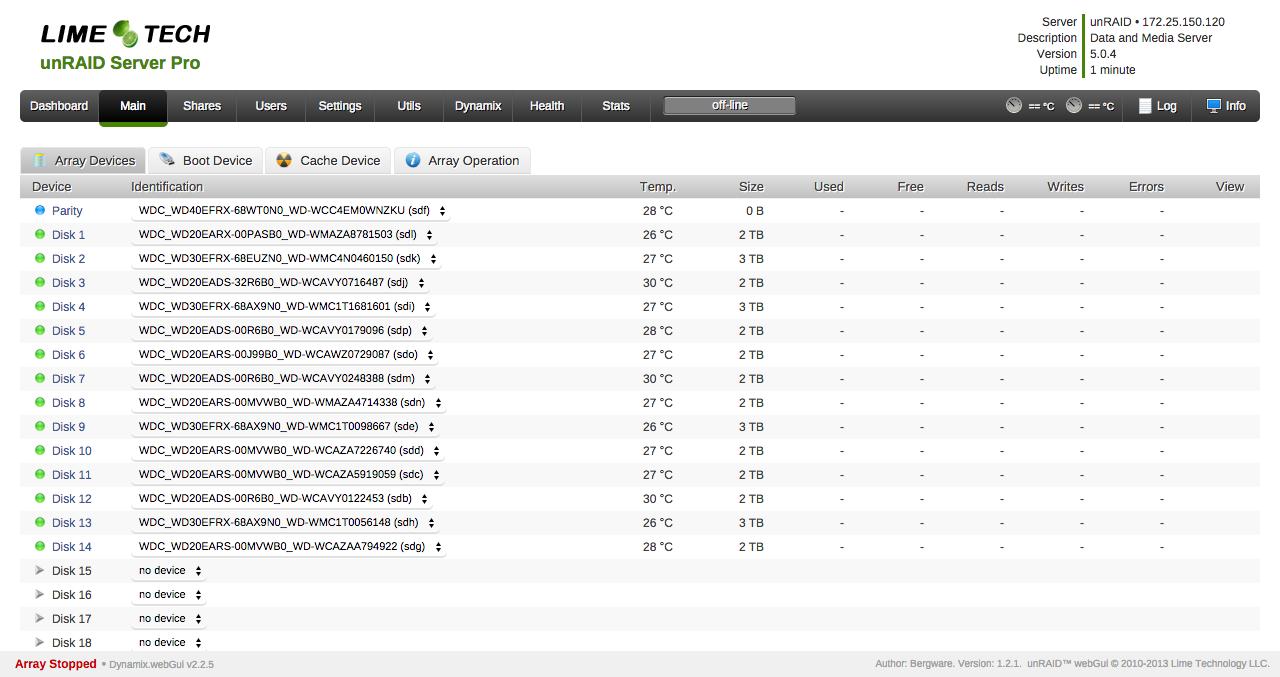

Take a deep breath!!!!  Stop for moment.  If you look at the screen shots you have posted, most of them will give you all the information that you need-- the serial number of every drive in the system.  Look at them.  You should be able to quickly identify which drives are in which cages.  (I have put little paste-on stickers--- copy paper and transparent tape--- on each opening identifying the disk number of the drive inside.  This way when I have a problem, I know exactly what slot to open to get to that disk.)
you are completely correct, Frank1940...that's what i did and i was indeed mistaken all along...what i thought to be cage 3 was actually cage 1 with disks 1-5...i was also able to find the reason why they all showed as missing...the new backplane is capable of housing both SAS and SATA storage, and when i plugged in the 5 SATA cable ends in the rather dark cavity that is my case, i instinctually plugged them all into the yellow females of the cage, not even seeing that there were an equal number of black ones in-between...just re-plugged them all and booted up the server again, and i am now seeing all drives in green, parity in blue.
*but* since this obviously doesn't solve my problem with the earlier disappearance and unformatted status of drives 14 and 13 respectively, i have to assume that cage 3 also got damaged during transport, and when i replace cage 3, i might as well replace cage 2, just to be safe...i messed up by not asking my friend who packaged this system to package the drives separately, so i must now pay the price of buying 3 backplanes...a €315 mistake...bummer, but in light of the fact that the data is likely to be ok, it's the *much* smaller bummer.
At the moment, you seem to have all of the drives looking fine (except parity -- and that's likely just due to the initial "fiddling" you did with the system).
Since drives #13, #14, and parity are in the same cage, THAT is the cage you want to replace -- I wouldn't replace the others unless you have issues with drives in them as well.
At this point, I'd be sure your new cages replaces the cage that held those drives;  boot again to confirm all the drives look green; and then do the New Config I noted earlier -- i.e. all the data drives, but no parity.    My expectation is that you will then see ALL of your data with no problem if you scan through the disks.    As long as that's true, just Stop the array; assign parity; and Start it back up and let it do a parity sync.
Replacing the other cages certainly won't hurt anything -- but since all of your problems were with drives in the same cage, it's likely that's the only one that actually got damaged in shipping.
