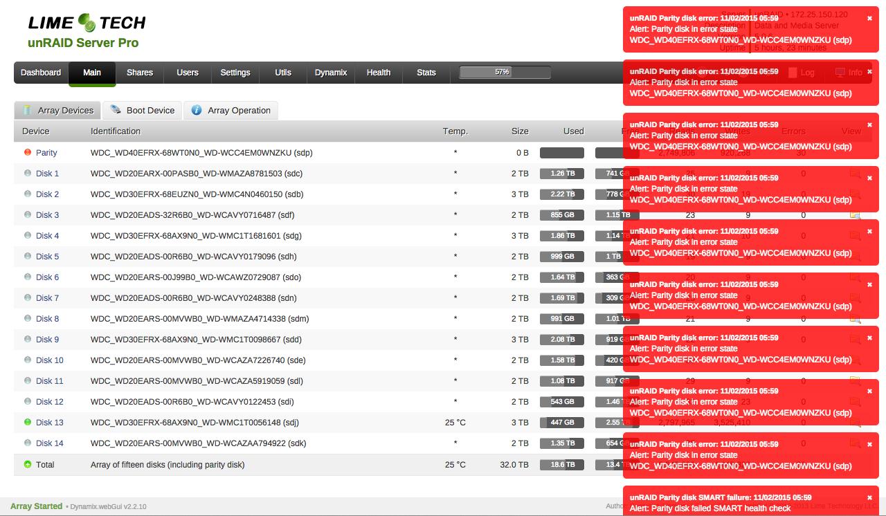

weeelllll, while copying the data from disk 13, which i backed up yesterday, back onto the newly pre-cleared and formatted disk 13, my Parity disk threw up this disturbing (mostly visually disturbing) message (see attached).
Data is still copying back to Disk 13, slowly, very slowly, and will continue doing so for another "1 day 12 hours" (although that changes from 2 days 6 hours to 11 hours and everything in-between, constantly), so will let it finish that process, but when it is finished, i imagine that since i still haven't done the actual parity-check (i was still running on trusted parity), i'll have to do yet another parity-sync *and* then the parity-check, which i was going to do next, is that right? so i am looking at another 3 days of parity operations before i'll have a chance to be "back in the game"?

I would post a syslog.  At first glance I would think that writes to the parity disk are failing.
stupid question: the newest syslog on my flash is 4 days old...how do i go about retrieving one from today?
also, the red alert boxes are now alternating with green ones...the red ones all say that the SMART test on Parity has failed, while the green ones all say that is has passed...they alternate, red, green, red, green, etc. ad nauseum.
Ouch !!  You're definitely not having good luck with this system !!
Writes to the parity disk aren't simply failing -- the disk has been disabled, so you have NO parity at this point.  This means writes to that disk failed, so the system disabled it.    The good news is it was the parity disk, so no data has been effected;  the bad news is it means your system is not currently fault tolerant.
I'd stop the writes to the new disk and resolve the issue with parity before proceeding, so the system will be protected.
While it's possible you simply don't have the parity disk seated well in its cage, I suspect that the drive has actually failed and needs to be replaced.  If you want to try just reseating it, do that -- then see if it passes SMART -- and if it passes SMART okay you can try doing a parity sync (which, if successful, should be followed by a parity check to confirm all is okay).    Unfortunately there's no way to do these steps quickly ... so it's going to be another couple days at least before you've got this all put to bed !!

can i stop the array and simply un-assign parity for now, remotely, just to keep the parity disk from being written to?
You could stop the array and do a New Config -- assigning all of the data drives, but no parity drive;  then Start the array and continue writing your data to #13.    In fact, those writes would be very fast, as they'd be at full disk speed with no parity computation overhead.

If you can access the drive, take a look at the SMART report first.  If Parameters with ID# 5, 196, 197 or 198 are non-zero that indicates a (potential) problem with the drive.  Perhaps not enough to warrant not trying to use that drive but a need to further evaluate it.  As I understand it, if parameter ID# 199 is non-zero that indicates that the problem was external to the drive and that the drive is most likely good.
Yes, #199 is a data transfer error -- most likely a cable or connector issue external to the drive.
Non-zero values for #5 (Reallocated Sector count) and #196 (Reallocation Events) aren't necessarily bad ... in fact, modern drives are DESIGNED to automatically reallocated defective sectors [Old-timers will remember when drives came with defector sector maps on the drive that you had to manually enter into the drivers so they'd be avoided].
A non-zero #197 (Pending Reallocations) isn't good however -- that means they've been noted as bad but not yet reallocated ... which generally means they contain data so they can't simply be re-mapped.  I immediately replace drives that have non-zero pending counts.
i went in today to re-seat Disk 15 (Parity) and check the cabling...after i rebooted the server i did a new config and assigned all disks but parity, then did a pre-clear - n on the parity disk...i just didn't wanna do the full pre-clear cycle at this point, but will do it if i run into another issue with disk 15...the results of the pre-clear that just finished are this:

so what's the best way to go about getting back the SMART data you wanted me to double-check? is the Dynamix WebGUI's read-out of SMART values capable of displaying them? is it enough to just add the disk back in while the array is stopped or do i need to do another New Config just to get the correct SMART values?
you were referring to the very error the pre-clear found when it said
1 sector was pending re-allocation before the start of the preclear.
, right?
so if i were you, i'd give up on this drive, if i understood you correctly, and send it in for replacement, right?

What I would do, if it were my server, is to set this drive aside for now. (You said you had purchased it in the USA and are now in Europe so getting warranty service on it is going to be a hassle in any case.)  I would get a new drive and run three preclear cycles on it (personal preference!).  If it clears the preclear tests, install it as the new parity drive.  I would want to get my array protected as soon as possible.
I would run another couple of Preclear cycles on THIS drive and see if all of these parameters remain at zero.  I know it takes a long time to run these tests but that will tell the tale on this drive.  I believe Parameter #198 is the real killer.  The data in those sectors is unreadable and, hence, that fact will prevent data rebuild on another disk.  I believe Parameter 197 means that the data reads are flaky and there is a real possibility that the next time an attempt is made to read those sectors, the data may not be recoverable.  (Basically, there are some sectors that can not be read directly but through the drive's data recovery logarithm, the data can be reconstructed.)
Also, someone has worked on a script which tests drives much more completely than the standard preclear script does.  Basically, it uses a more complicated pattern of ones-and-zeros to verify that the disk is performing properly.  AT this point, I can't remember who it was or what the name of the script was to do the job.  (It will probably come to me about 4 o'clock in the morning!  ::)  )  It also probably requires a much longer time to run a full cycle on the drive!
Don't worry about getting warranty service on a drive.  I have never heard of anyone getting turned down!  On the drives that I have sent in, the replacements were shipped within a couple of days, so I know they never really looked at the drive except to verify that it was still in warranty.
