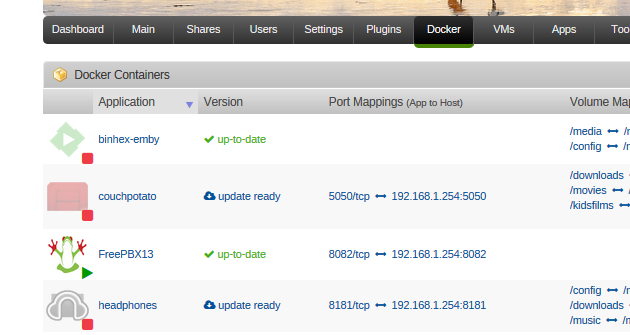

December 15, 20178 yr Hi, Just tried this and get an error as follows: "root@localhost:# /usr/local/emhttp/plugins/dynamix.docker.manager/scripts/docker run -d --name="FreePBX13" --net="bridge" -e TZ="Europe/Berlin" -e HOST_OS="unRAID" -p 8082:8082/tcp -p 5060:5060/tcp mima84/docker-freepbx Unable to find image 'mima84/docker-freepbx:latest' locally Pulling repository docker.io/mima84/docker-freepbx /usr/bin/docker: Network timed out while trying to connect to https://index.docker.io/v1/repositories/mima84/docker-freepbx/images. You may want to check your internet connection or if you are behind a proxy.. See '/usr/bin/docker run --help'.The command failed." Tried a second time and it has installed ok. Let's see what we can do! Thanks for the Docker, I'm sure there will be a lot of interest. Edited December 15, 20178 yr by rjstott Add Info
