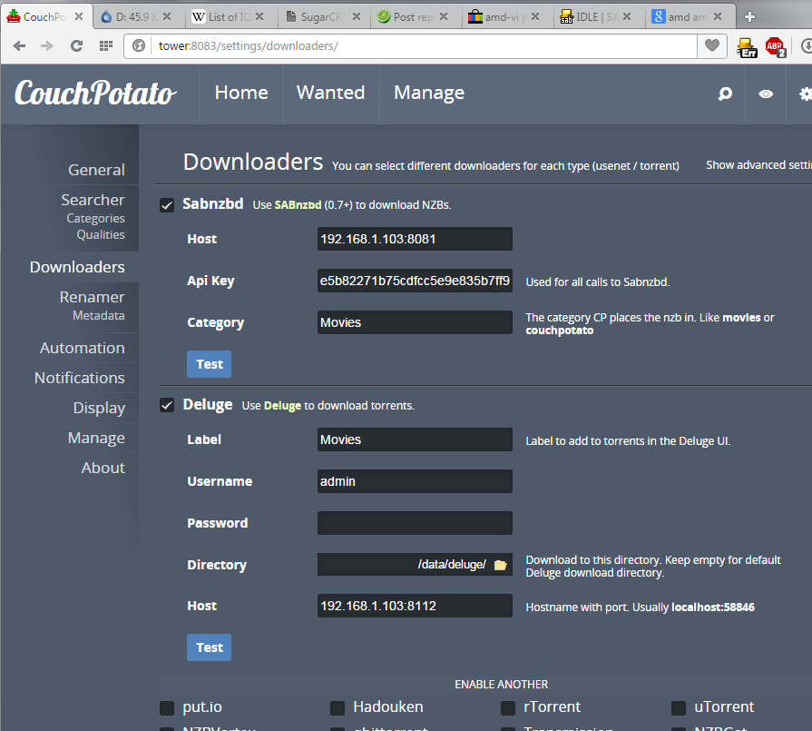

mr-hexen, I'm experiencing what JimPhreak is experiencing.  Exactly the same.  Please see my screenshot.

I've tried putting admin and my password.  I've tried putting just my password.  Nothing worked which was why I just wound up configuring Blackhole instead.  Do I lose any functionality with Blackhole over Deluge?  Like am I not able to DL torrents from sites that only have magnet links?
CP connects to the Deluge Daemon on port 58846, not the webui 8112. Change the CP to use port 58846.

I believe as jimphreak has earlier mentioned,  changing to 58846 doesn't work either

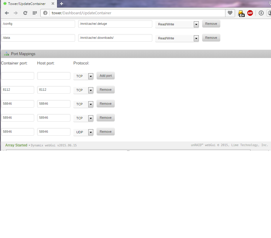

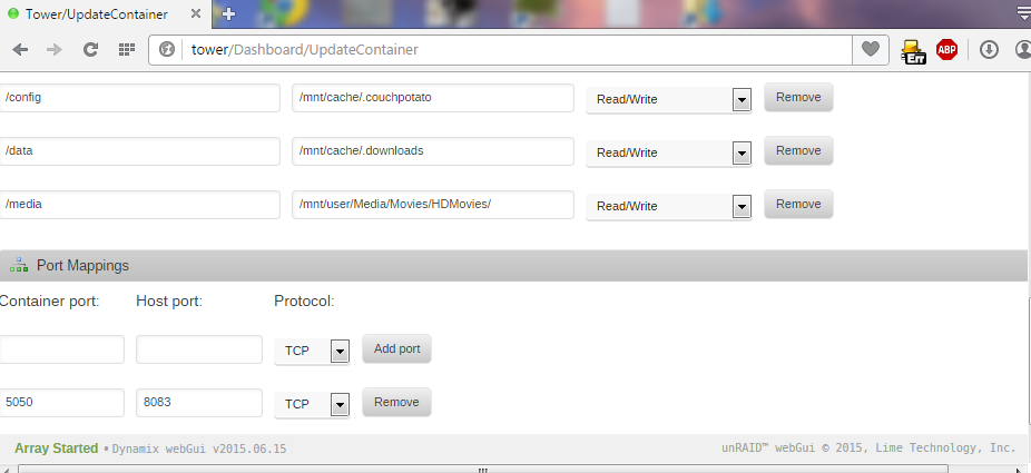

I have the volume mappings correct already just as you've shown here.  However, where I'm stuck is having CP telling Deluge to do anything.  Remember they won't connect and I'm at a loss as to why.

why are you using /mnt/user/Docker/appdata/delugevpn for your config?
I've tried helping a few folks, so I'm not sure if you're answered this already, but are you sure this folder is set for cache only?
personally, I'd change it to /mnt/cache/appdata/delugevpn
there's no reason, IMO, to have appdata nested in a docker folder.  /docker/appdata is just more to type (get wrong) than simply /appdata.  Plus, most everyone is just using /appdata, so this puts you more in line with the "normal" way this is being managed on unRAID.
however, regardless of what path you choose, you MUST make sure the folder /appdata is set to "cache only: yes" in the unRAID setup.  if not, mover will move things out of it, and nothing will work right.
