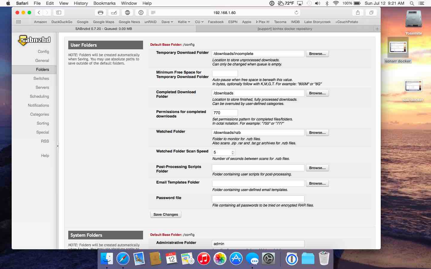

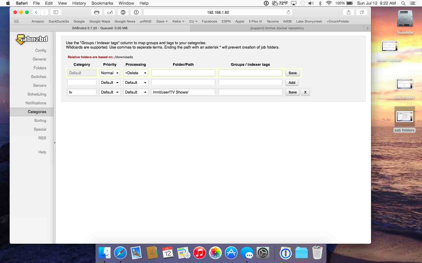

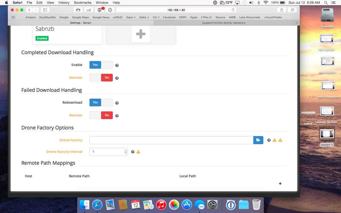

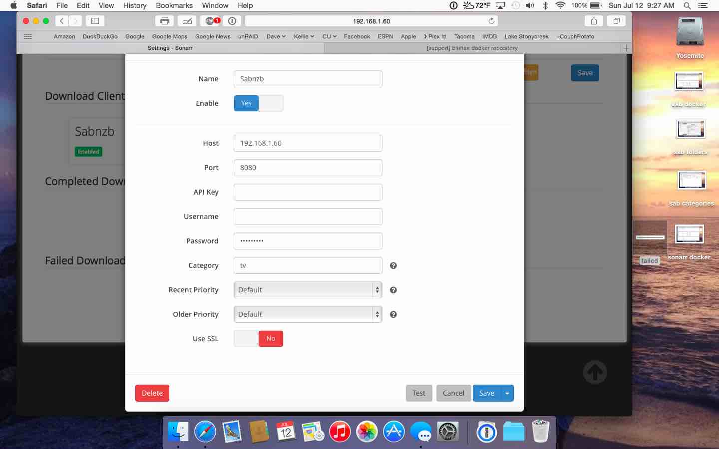

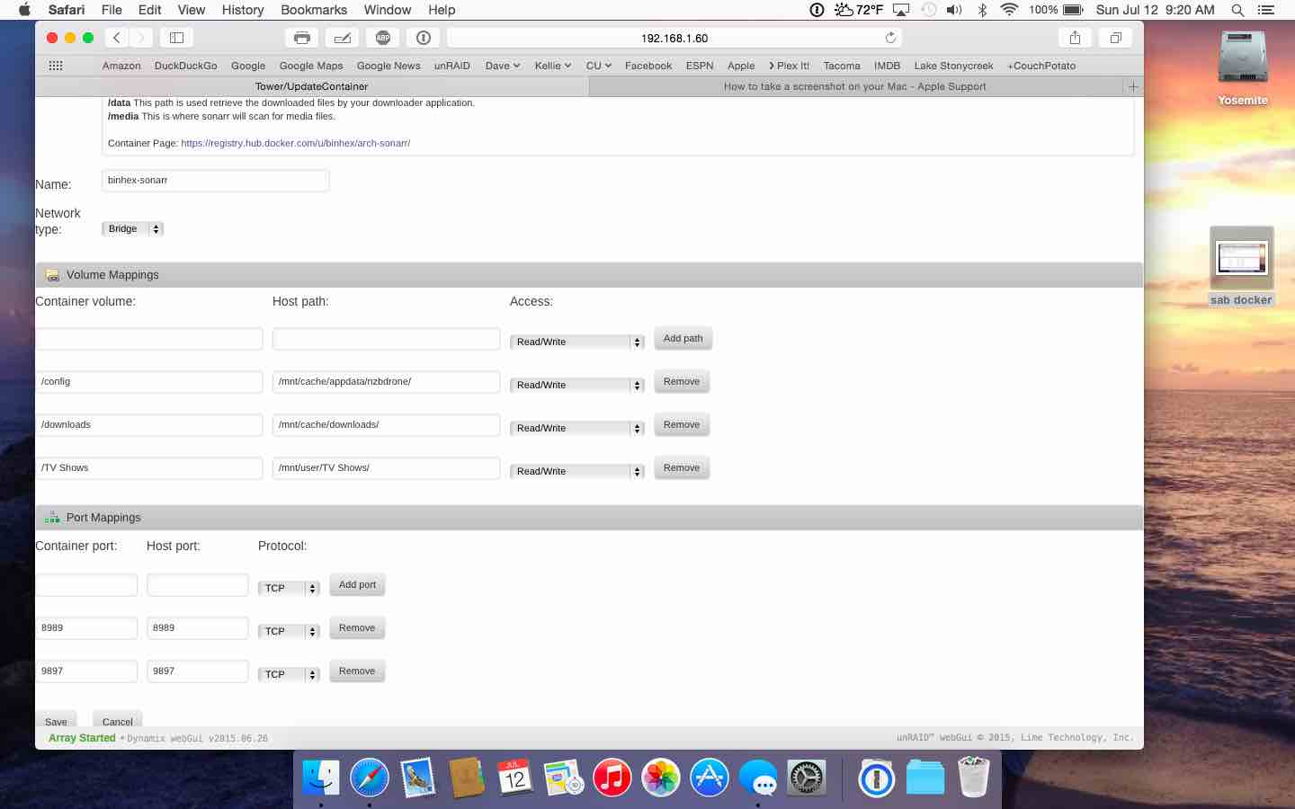

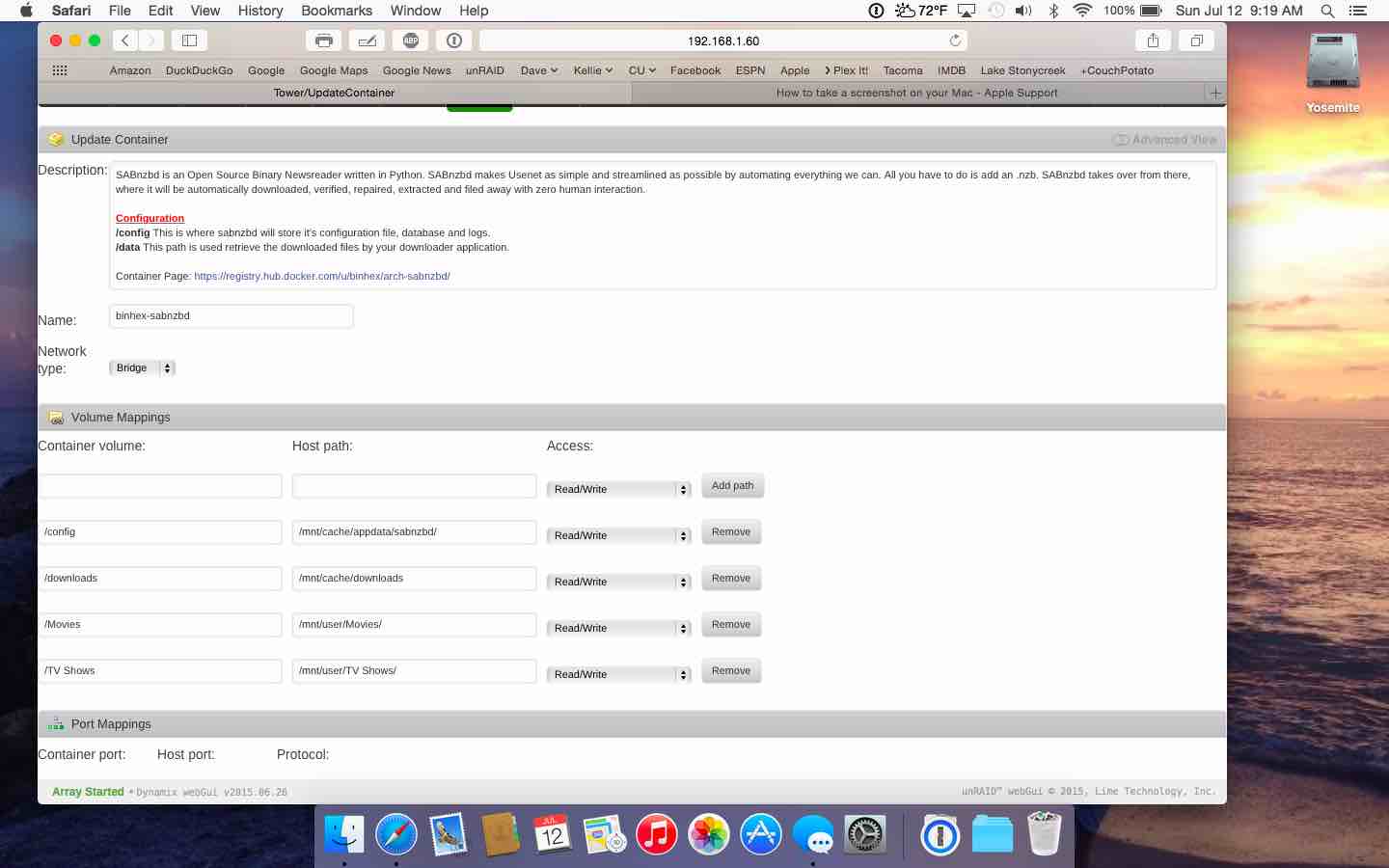

OK here are the settings you wanted.  If you don't see anything wrong I might just uninstall sonarr and reinstall to see if that fixes it.
docker settings
sab settings
sonarr settings
Okay, I was tired and wrong last night.
In SAB, in the categories, for tv, put /TV Shows (I told you to put /mnt/user/TV Shows, but we mapped that to /TV Shows in the docker config).
That should fix you up, but also, I noticed you don't have the SAB API entered in Sonarr, you should add that to the Sonarr config.  In the SAB config, under General, there is an API key and an NZB key, you want to put the API key in the Sonarr setup on the SAB configuration page.  I would also update the Recent Priority (I use high) and Older Priority (I use normal) which sets the priority of nzb's Sonarr sends to SAB.  Finally, I see you have a password entered in SAB configuration page of Sonarr, but no username.  I don't know if you actually have a username and/or password setup in SAB (you'd have to enter then to access the GUI if you did), but I don't bother with them, as it's all inside my network, so I don't want to be bothered to enter them whenever I check on downloads.  If you don't have them, remove the entry from Sonarr config.
Let me know how you get on with these changes.
Thanks I will try it out when I get home from work.  I do have the api in sonarr, I just removed it so no one would see it same thing for the user name
