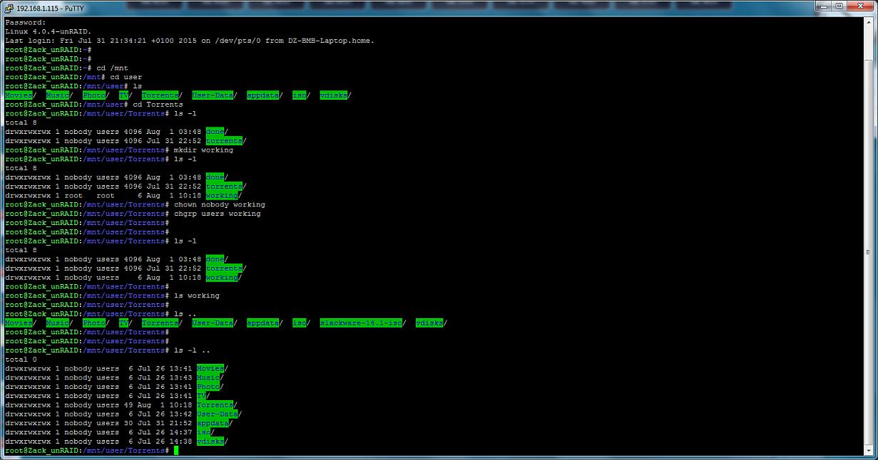

Hopefully final question on Deluge....everything is working fine. Just one nit.
I have my volume mapping as follows: data <--> /mnt/user
In my Deluge UI prefs, I have the following:
Download to: /data/Torrents/working      NOT WORKING, putting downloading torrent in /data
Move completed to: /data/Torrents/torrents            WORKING FINE
Copy of .torrent file to: /data/Torrents/done            WORKING FINE
Any ideas? I attach screenshots - Thanks!
Is the working folder present?  Not sure if Deluge will create it if it isn't present and remember Linux is case sensitive.
Deluge will create folders that do not exist.
  • Replies 1.6k
  • Views 308.2k
Deluge has create my torrent storage folder (torrent) and the "done" folder. No issues there...
For grins, I did create a "working" folder with the correct permissions. See attached.
In my previous post - you can see my deluge prefs which looks right.
I am not trying to put the data directly in the /data folder. Instead, I am trying to put it into a folder called Torrents.
It is not a big deal as the "done" and .torrent folders work fine. Just wondering....Thanks!
