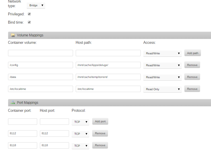

I am not aware that I changed anything and it worked like a charm for weeks...
Here my settings:
Bridge Mode
8112 -> 8112
8118 -> 8118
please also see attached screenshots

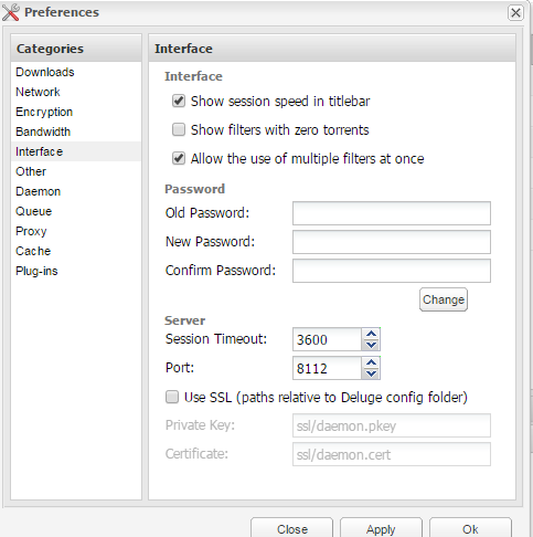

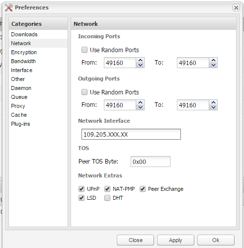

Sorry should of been more clear, I meant the listening poet defined in the webui for deluge, not the docker container.
OK, for some reason I have them fixed to 49160
I can't remember if that was default or if I set that following some tutorial.
and the interface port is 8112
see screenshot

You don't need to proxy, you have a VPN tunnel running, remove all proxy configuration.
Also a quick look at your screenshot shows your using the same port for incoming and outgoing, you can't do this, you need to use a different port number
