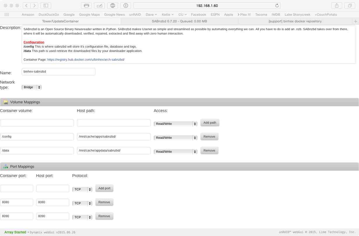

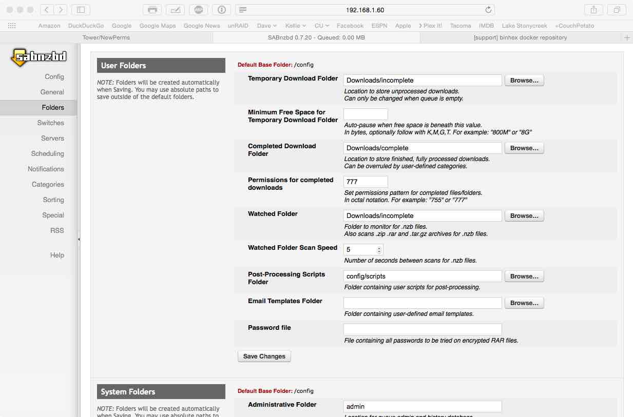

I'm having an issue with Sab, everything work except post proscessing.  I get the following error.  It happens on all downloads.  Any idea?
» PostProcessing was aborted (Cannot create final folder /mnt/user/TV Shows/My Haunted House/Season 3/My Haunted House S03E07 Unknown Caller And The Rocking Chair 720p HDTV x264-DHD)
screenshots of SAB config and docker config would help.  I want to see the mappings in the configs.
here you go
Okay, a couple of questions for you.
Where exactly do you want your configuration files for your dockers to reside?
1) /mnt/cache/apps/sabnzbd
2) /mnt/cache/appdata/sabnzbd
whichever you want (I suggest #2), that is what you want in the docker config next to /config
this means that the docker will map the /config information into /mnt/cache/appdata/sabnzbd.  I would setup all my other dockers the same, with the name of the docker as the last folder in the path. i.e. /mnt/cache/appdata/deluge
next, you're not mapping anything from the docker to your array.  You have /data going to /mnt/cache/appdata/sabnzbd, which is probably empty, if it even exists.  You currently have your config mapped to /mnt/cache/apps/sabnzbd.

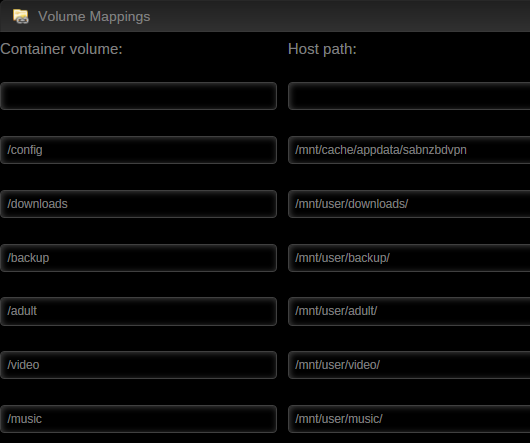

Here is how I would proceed if I were you.
Change docker setup page to this...
change  /config to map to /mnt/cache/appdata/sabnzbd
change  /data > /mnt/user/{whatever user share you want to have access to inside of SAB} i.e. /mnt/user/video or /mnt/user/TV, etc
add any more mappings you might want.  Personally, I think "/data" kinda useless.  I'd add some more mappings, like
/video  >  /mnt/user/video
/music  >  /mnt/user/music
etc.
See my screenshot for examples of how I do it (realize that my mappings likely do not match yours, so you have to amend to match your setup; don't just blindly copy mine)
Then, once you do that, save, which will update everything, then restart the docker.  If you moved your /config like I suggest, when you go into SAB config, it will likely bring up the wizard, as it will not see your old/current configuration/settings.  Stop the docker.
go into unraid and move everything from /mnt/cache/apps/sabnabd to /mnt/cache/appdata/sabnzbd, then remove /mnt/cache/apps (unless you have other dockers mapping their configs there; if so, I'd update all of them to the new /mnt/cache/appdata/{dockername} location, and move their configs over, like you did for sabnzbd.
Once you have done that, restart the docker, and your config/setup should be back.  If so, go into the config and change the folders in the SAB setup.  There is a browse button, so you should be able to just browse to the locations you mapped in the setup.  For example, if you setup /video  >  /mnt/user/video, when you browse, you'll just see a video folder, which will contain everything in you /mnt/user/video folder from unRAID.  the mapping replaces /mnt/user/video with /video inside the docker.
if you can't browse for some reason, and just want to enter the folder locations directly, make sure they start with a /
if you just enter Downloads/incomplete it will actually map that to /config/Downloads/incomplete  which is really  /mnt/cache/appdata/sabnzbd/Downloads/incomplete, and is probably not where you really want to download stuff.

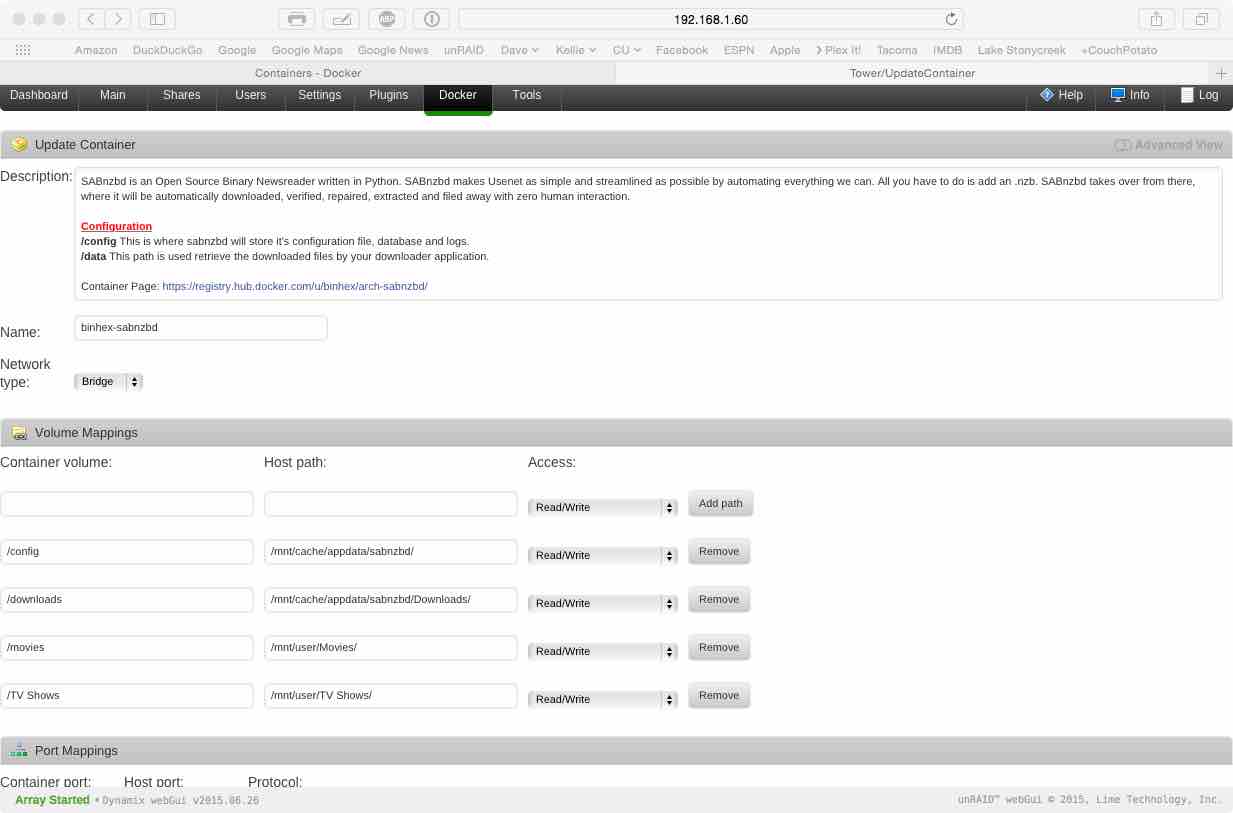

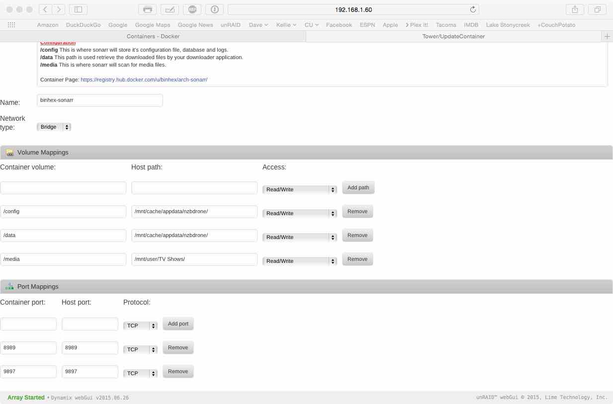

JustinChase, thanks that part is working now however the shows are not moving to the correct directory.  They are staying in the completed download folder and NOT moving to the TV Show Name directory.  Any idea, I'm using Sonnar to download the shows.
Here are my docker settings for sab and sooner

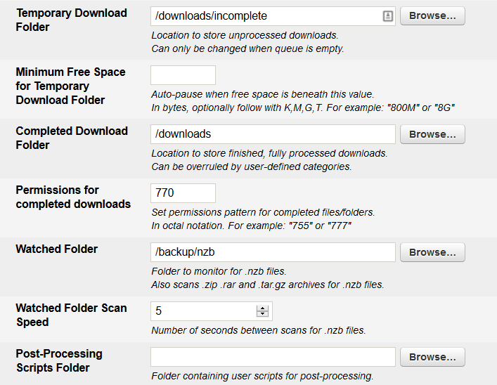

it seems you still don't quite get the container/host mapping thing.  It's confusing, I know, but you HAVE to understand this, or you'll fight this forever.
The thing you put in "container volume", on the left, is what you will see inside the container when you try to navigate folders.
The thing you put in "Host path", on the right, is what that translates to on your unRAID server.
So, if you have /downloads in the container volume and you have /mnt/cache/appdata/sabnzbd/Downloads in the host path, you get this...
Inside the container, when you enter /downloads in the path, you're really entering /mnt/cache/appdata/sabnzbd/Downloads.  So, that's where, on unRAID, the downloads will go.  This means, if you want access to those files in any other container, you have to map that path in the other container.  Something like /media > /mnt/cache/appdata/sabnzbd/Downloads for your sonarr mapping, which you don't really want, and do not have.
Take another look at the screenshots I posted, and try to copy them as closely as you can; but modified for whatever the folders are on YOUR unRAID.  If you have a path on unRAID /mnt/user/TV Shows, then your mapping in Sonarr is good.  If you have a path on unRAID like I do, which is /mnt/user/video/tv shows, then that is what you have to enter.
The good thing is that when you edit your docker containers, the host path box brings up a navigable path tree, so you can just click on the folder, and drill down to whatever folder you want to share.
Make sure you're not sharing anything on the cache drive, only user shares.
Remember ALL dockers that interact will need to have access to the folders you are sharing, so the broader, higher up the tree you select, the easier for everything to have access  i.e. sharing /mnt/user/video is usually better than sharing /mnt/user/video/tv shows/Alias/Season 1
Again, look at my screenshots and really try to understand what I've done, and why, then you'll be able to modify for your server.
