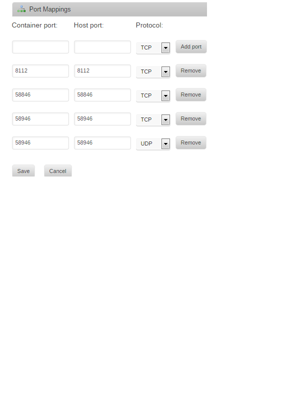

Hey binhex, I've got 4 of your Dockers (couchpotato, sonarr, nzbget, delugevpn) up and running and for the most part they are working terrific.  The only issue I'm having is getting CouchPotato to connect to Deluge.  When I try to test the connection I keep getting "Connection failed. Check logs for details" but there is nothing shown in the log.  It's the only thing holding I have left that's not configured.
Please provide screen shot of CP setup and the deluge docker config.
See below.
See below.

in CP, add 'admin' as the user name.
They weren't showing up for me at first..
No dice.  Tried just admin.  Tried admin with the password I use to connect to the WebUI.  Nothing works and no log entires.
in the deluge webui, under preferences, daemon, do you have allow remote connections enabled?
I do.  Could it be the VPN that's messing things up?  Under Network interface it lists 10.4.12.135.
Do you have any other programs successfully connecting to deluge?  If so, what settings do those programs use.
Also, maybe try using 192.168.4.208:8112
If you don't have any user/password setup in deluge, then you don't need them in the couchpotato setup dialog.
can you connect to deluge by entering 192.168.4.208:58846 in your browser?  if so, does it prompt you for a user name or password when you do?
**also, you have coachpotato as the label; but I suspect you meant couchpotato ;)

Putting http://192.168.4.208:58846/ into my browser does not work, nothing loads.  If I put 192.168.4.208:8112 (which is what Sonarr uses) in there and run a test it just says connecting and locks up everything.  Sometimes it says it failed and to check the logs but the logs never load because it's like everything is locked up.
so, are you able to connect to the deluge docker GUI at all?  it sounds like a deluge issue, not a couch potato issue.
But, I'm not really sure what's going on, so I'm just kind of throwing stuff out there.
Deluge works fine.  I can connect the webUI via 192.168.4.208:8112 where it prompts me for a password and then I'm in.  Sonarr works fine with it as well as it send torrents to it and then renames them just fine.  It's just couchpotato that won't talk to it.
Oh well, couldn't get it to work through the Deluge downloader config but it works fine if I use Blackhole to just drop the torrent file into the directory Deluge is watching so all good.
