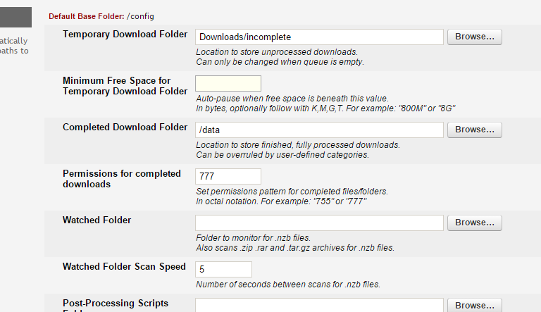

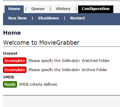

Need a little help with my moviegrabber setup
I am using binhex sabnzbvpn and moviegrabber.
I believe i have set all the correct paths to match my docker config but on the moviegrabber webui it still wants a sab watch folder and sab incomplete folder
Neither of those folder i have or use. is this a show stopper?
i ve included some screenshots.
