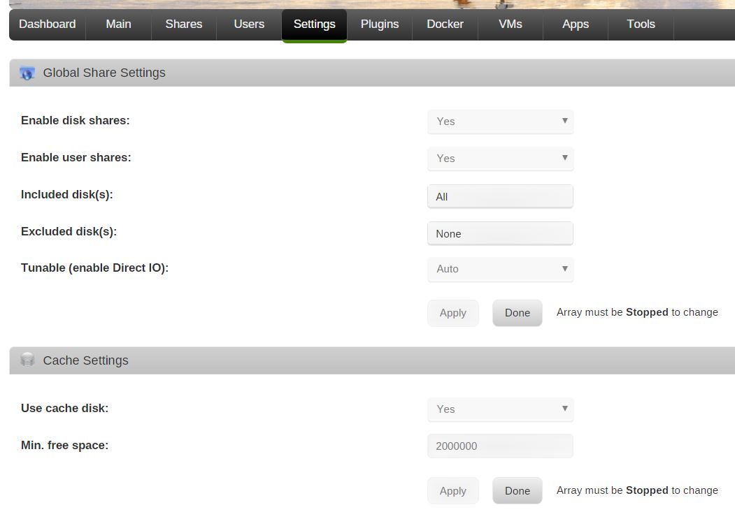

Looks like it's set to "yes". It's in Settings > Global Share Settings, yes? I can't change it at the moment either way. The manual mover has my array locked on. Can't stop the array. Can't reboot.

Was more thinking of the downloads share.
