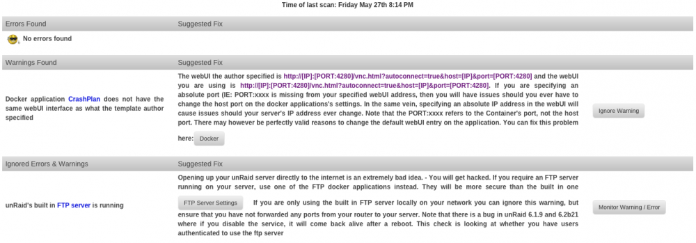

All fixed Thanks! Sounds promising I'll be away from my server for quite some time, but given that your WebUI snippets looked extremely familiar I'm sure it is solved now.

Updated, rescanned, still get the warning. Running 6.2.0-beta21, CrashPlan probably added while running 6.1.9 if that matters. The syslog is much neater now in this version. Could be even neater if it handled special characters though, "unRaid's built in FTP server is running" looks a bit webby and out of place. Edit: To clarify, what is in the syslog is ampersand#39;

Really... I installed crashplan to test that... I'll look further Edit. Did you guys rescan? Sent from my LG-D852 using Tapatalk Rescanned and even rebooted and rescanned.

Awesome! I really appreciate your work and your major contributions to the community I am now able to ignore the FTP Server warning, and the pop-up makes perfect sense, yay! The Docker webUI warning is still there, though (as noted by MyKroFt while typing this). From the syslog it looks like the differences lie in a leading space before http and two & uses (confirmed with template xmls): The webUI the author specified is http://[iP]:[PORT:4280]/vnc.html?autoconnect=true&host=[iP]&port=[PORT:4280] and the webUI you are using is http://[iP]:[PORT:4280]/vnc.html?autoconnect=true&host=[iP]&port=[PORT:4280].

No pop-up generated for the FTP Server warning, thanks for looking into it. Identical behaviour (or lack thereof) for me in Safari and Chrome. I normally use AdBlock in Safari but set to be disabled for the unRAID web UI, and I have also tried disabling it completely. Please let me know if there is anything I can test or log to assist. When clicking on the "Ignore Warning" button, the console in Chrome outputs the error FixProblems:1 Uncaught SyntaxError: Unexpected token ILLEGAL ...and in Safari: SyntaxError: Unexpected EOF (anonymous function) FixProblems:1 As for consistency: Clicking the "Ignore Warning" button for my Docker webUI warning generates a pop-up with a big fat label "Ignore Error?" and in the regular text there is "Are you sure you want to ignore this error:". Had a quick look at the code over lunch and I think I know what's going on with no pop-up and that error. And far as the font size on the pop up, one is the title and the other is a description. Sent from my LG-D852 using Tapatalk Sounds promising. Yes, it is quite obvious that one is the title and the other one part of the description. But they both use the word "error" in the pop-up even though it was a warning that is to be ignored...
