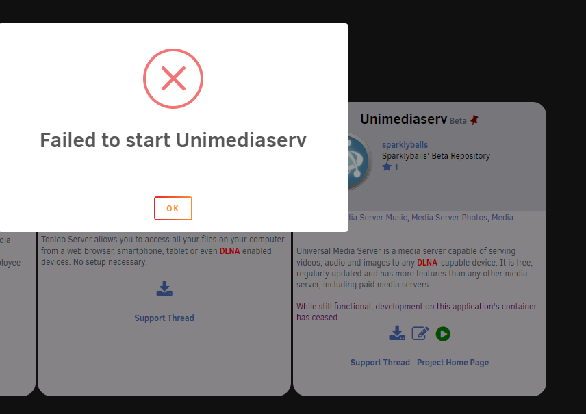

Hello, seems like this Unimediaserv app isnt working anymore on 6.6.1
