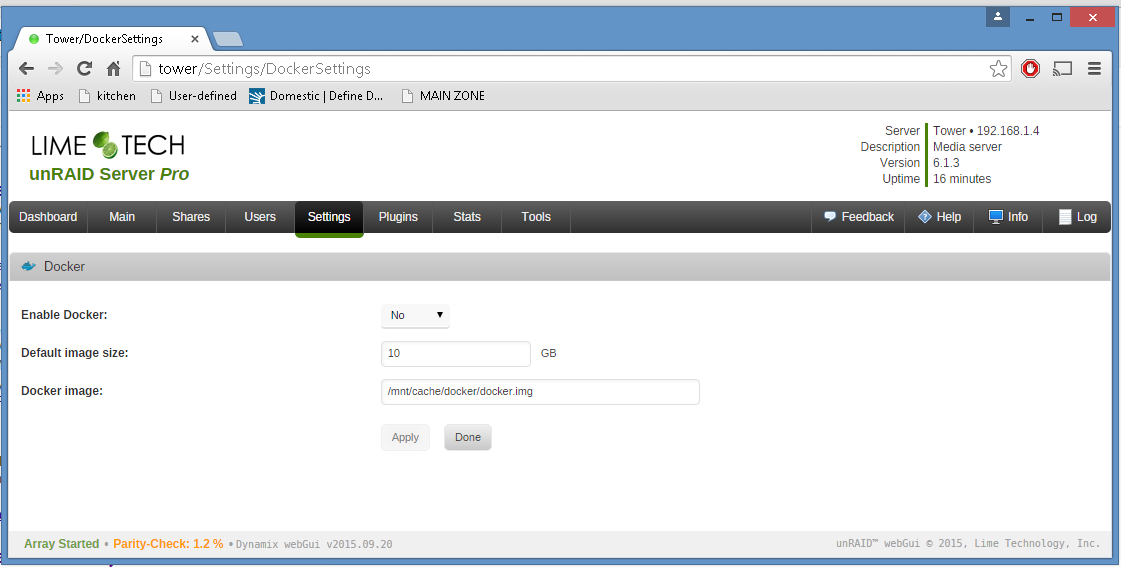

i don't have a main docker tab, only a docker option under settings.  I change enable to yes, and hit apply, but nothing seems to happen.
Has something changed since when the guide was written?
Do you have a cache drive?  if you don't, change the path to be something like /mnt/disk1/docker.img
Thanks for the reply. Yes, I do have a cache drive.  Should I see a docker tab in the ui?
Yes you should.  After hitting apply, it will take a minute and create a 10G docker.img file.  After the the docker tab should be present.
If its not, post your diagnostics
Thanks, figure it out.  Had to manually create the "docker" sub folder on the cache drive.  The tab shows up now, so I assume I'm good to go.    Thanks again

NVM...I had to click the box a few times to get it to come up. So what should I set the size to? If I can make the Docker Image smaller than I'd be more than happy to.
