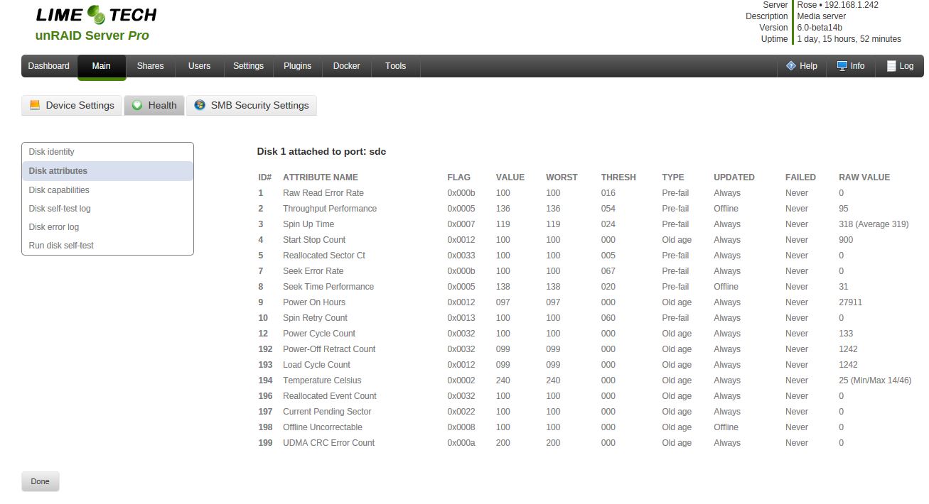

Attached is a pic showing the SMART reporting for all my drives.  About 1/2 don't yet have extended tests, but I started an extended test for every one that still needs it.

The Smart Report that they are asking for is this one.  You get to it by double-clicking on 'Disk 1' (or 'Disk X' for the Xth disk) on the Main tab.  Then click on the 'HEALTH' tab and the 'Disk attributes' in the box.
Added info in Edit:  most of the time, attributes # 5, 196, 197, 198, and 199 are the ones that you should be concerned about.  IF any of them are non-zero, that is an indication of a problem.

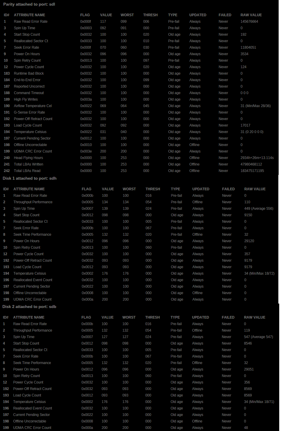

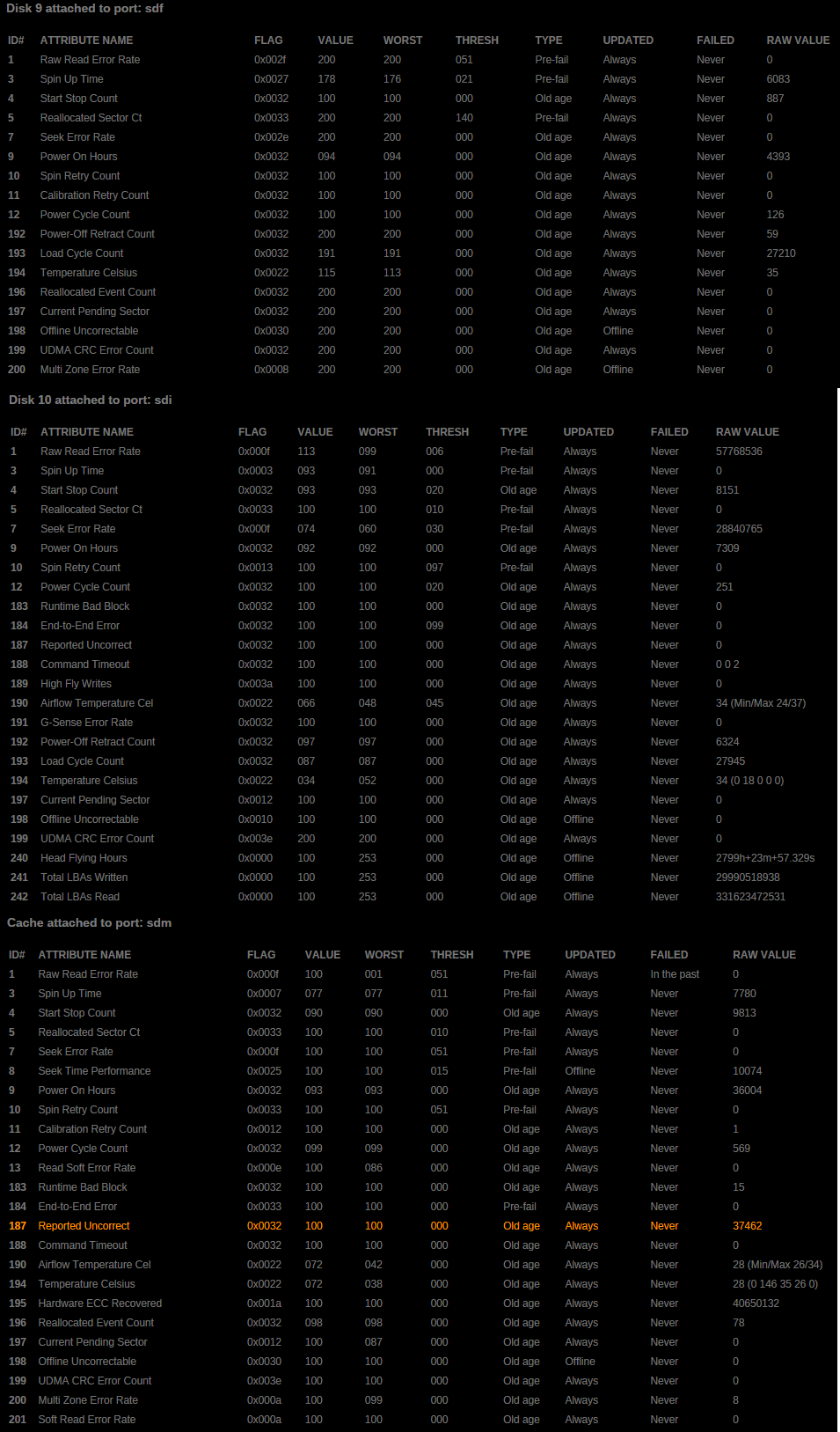

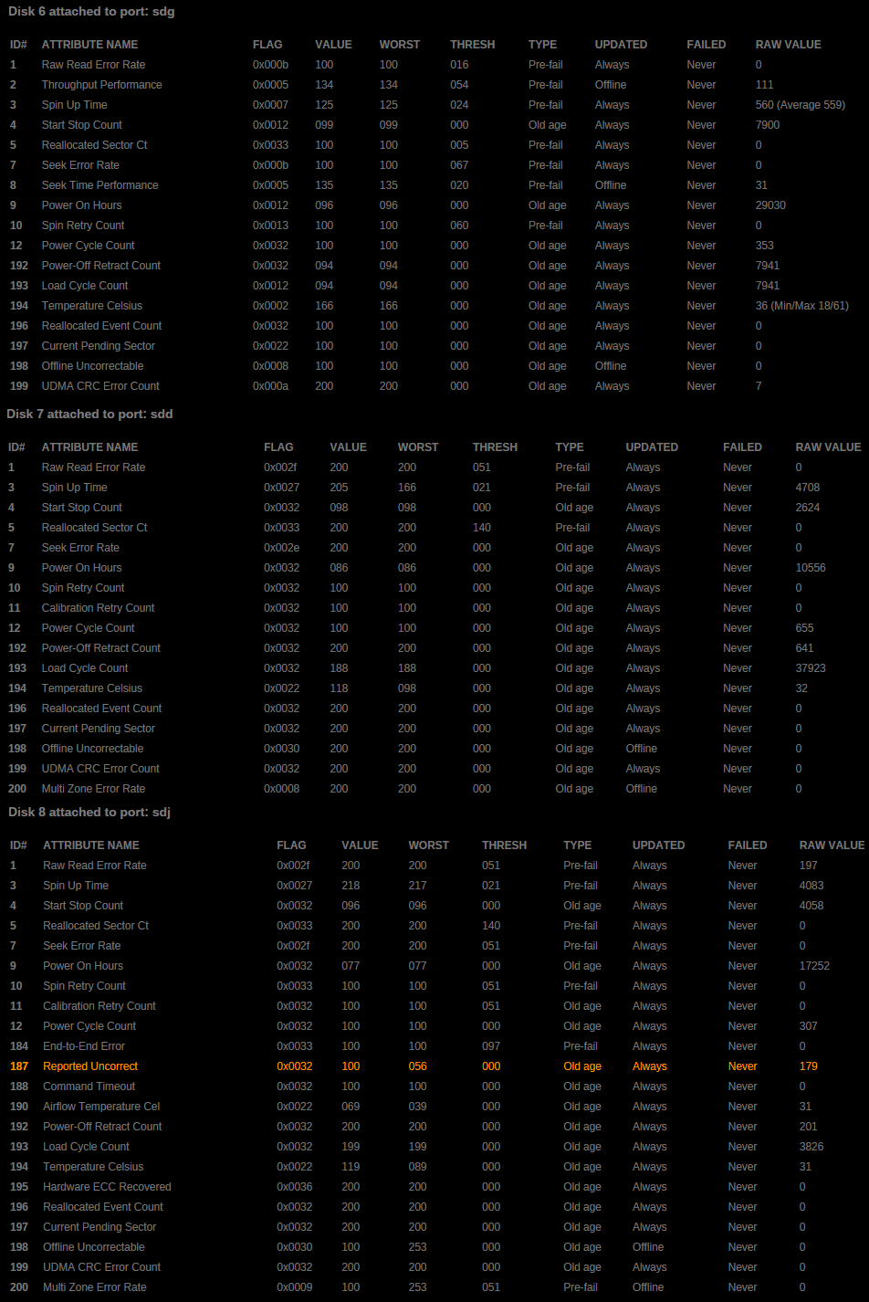

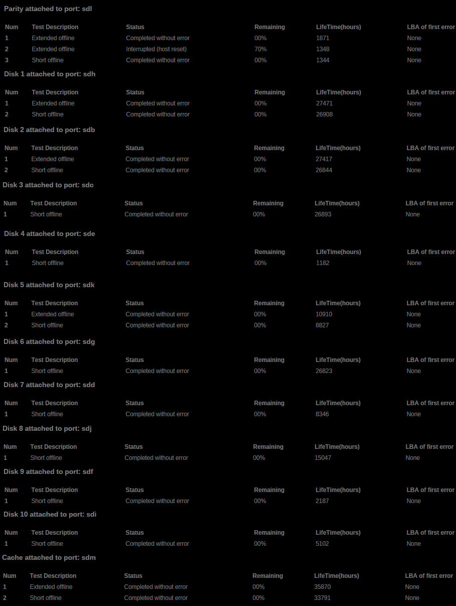

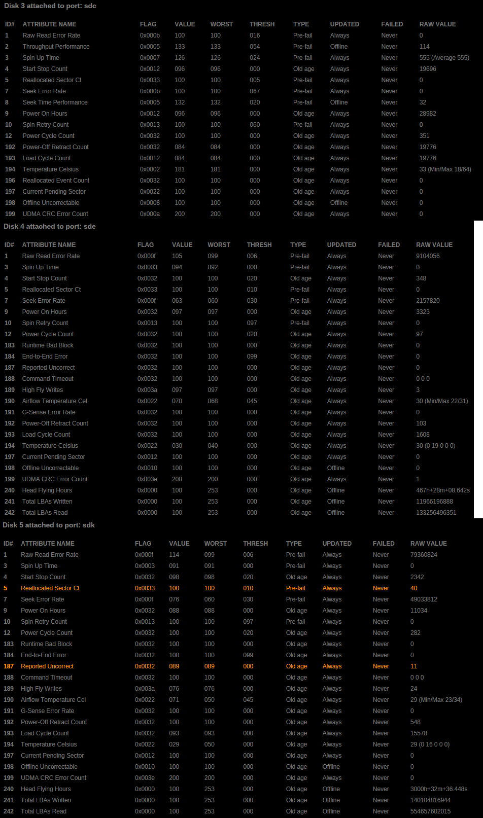

Meaning I have to find the problem(s) myself, with the smart reports (I've attached them all to this post).
I only saw a few errors while compiling the screenshots, most of which are on disk 5, which I mentioned in my first post, and linked to the thread discussing those errors.  They have not grown or changed for a long time (as far as I can tell), so I'm still not sure why running a correcting parity check would result in exactly 5 errors coming back every time I run a parity check.  I assume that they should be 'corrected' in the parity by this process, but it seems that's just not happening.
So, I still don't know what I can/should do to resolve this, nor do I know if my data is "okay" or not.  I have no MD5 information for anything, nor do I have a good grasp of how to generate such information.

Disk 2, you have ID#199 CRC Errors.  This indicates a problem transferring data from the disk (where it was read correctly) to the Motherboard.  This generally indicates cabling issues.  Could be a bad cable, loose connection, or cross-talk between cables (caused by tying cable together to make things 'neat').  Remote possibility is a SATA controller.
Disk 5, has ID# 5 reallocated sectors.  While the number is high, it is not an indication of a problem unless the number keeps increasing.
You have a number of disks reporting an ID# 187 Reported uncorrect errors on various disks.  I am not sure what the significance of this condition is...  (None of my disks even report this parameter and a quick Google search found nothing to answer this.)

It seems that the only other 'issue' is the "ID# 187 Reported uncorrect errors" on disks 5, 8 and the cache disk.  All 3 disks are different manufacturers, sizes and ages, so nothing really in common with them, other than this error; strange.
This might account for the '5 errors that will not go away' as Pending sectors can return a different value each time they are read (which is one reason they tend to impact any recovery from failure).

It is my understanding that Reallocated Sectors are 'bad' sectors that have already been retired from service and have been replaced by 'good' sectors from a pool of sectors that the drive manufacturer set up for this propose.  Since there are no other parameters that are usually watched have any current failures, the drive may be OK.  What, as I understand it, is that we don't want to see the number increase.
Oh, I went back through the disks again (I have problems reading the light gray text on black background) and noticed that Disks 4 and 6 also have CRC errors!  I would be checking to see if a SATA card was common to all of these disks!
No -- a reallocated sector is simply a sector that has been re-mapped to a spare sector.  It's NOT a bad sector.  This is a normal function for modern disks, which have a number of spare sectors that can be assigned to replace sectors that fail.    A more significant issue is "pending sectors" -- which are sectors that have exhibited issues but have not yet been reallocated.
You are right - I saw the figure '5' without noticing that it was Reallocated sectors rather than Pending Sectors.  Hope fully this was a bit more obvious by the fact that the text I posted mentioned Pending Sectors.
