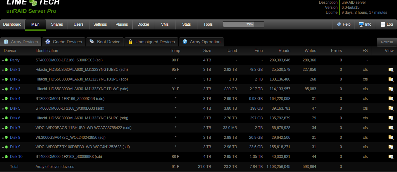

parity errors, possibly the same ones recurring from test to test
I've updated to beta15, and I'm still seeing 5 parity errors on every parity check.
How do I figure out what these 5 errors are, and either fix them, or tell unRAID to stop telling me about them?  I don't think unRAID should keep reporting the same errors constantly, should it?

I came home tonight to find the server had shut off; not sure why.  When I started it back up, it did not start a parity check, so it must have shut down safely, somehow.
I started a new correcting parity check.  We'll see how it goes.
5 errors :(
