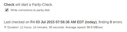

Okay, I must admit I'm surprised, but parity check finished and...
no errors!!
I just confirmed the parity disk spin down setting is back to use default, and this time no errors.  I have no idea why running it with 'never' then coming back to the setting it's always had 'fixed' this issue, but it seems to have worked.
I have not restarted the system during any of this testing, so I cannot confirm it will survive a reboot; but I sure hope it does.
After changing my parity spin down setting my parity completed with no errors this time! Only the Gods can figure this one out.
