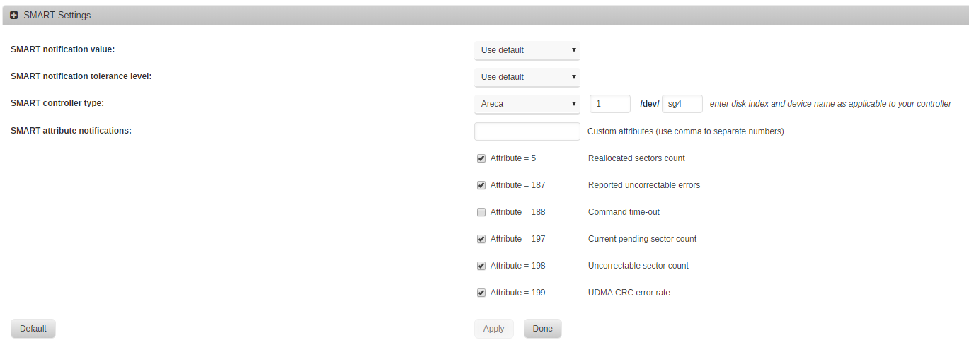

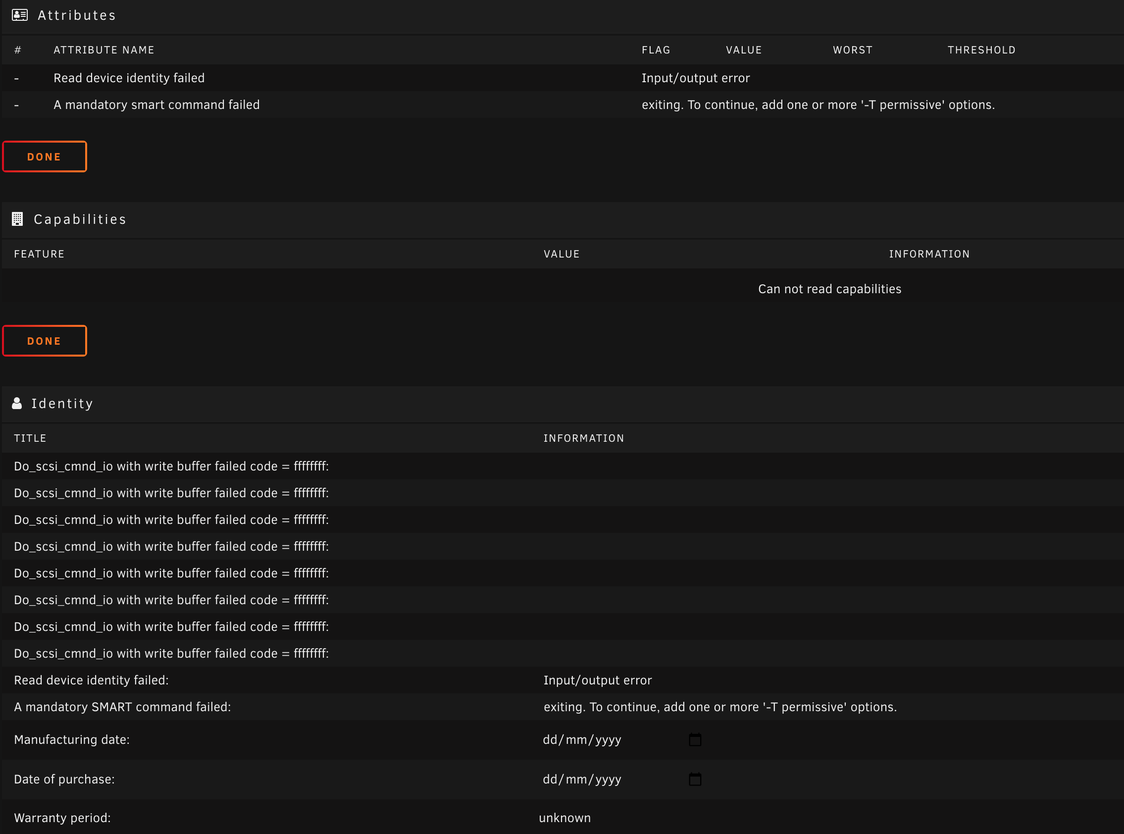

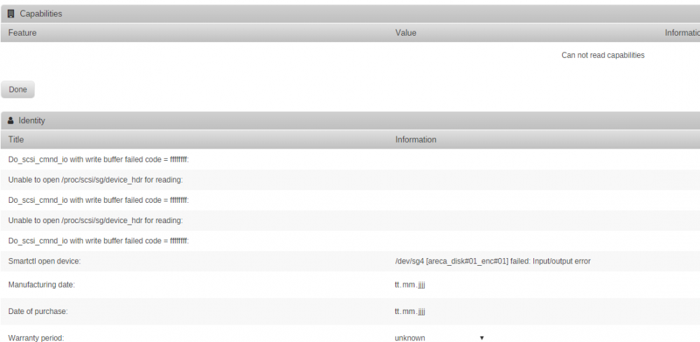

so i set it up in unRiad
and unRaid get this error
any idea to resolve this?
2 hours ago, chi110r said:
i have some problem to get the smart informations get work on the unraid web interface
in the shell it works great:
I am not 100% sure. Looks like you have it set up properly.
It may have something to do with the volume name (areca_disk#01_enc#01). I know that the "#" can cause issues.
@bonienl might be best to support you on this.
yes.. i don't know but the "areca_disk#01_enc#01" is only on the webinterface. on the cli it usese this format "smartctl --all  --device=areca,1/1 /dev/ sg4"
Did you upgrade from an earlier version of unRAID?
Earlier versions of smartctl, it used a different format, which may still be stored (see file smart-one.cfg in the /config folder on your flash device). It should look like this (example):
[disk8]
smType="-d areca"
smPort1="1"
smDevice="sdg4"
When you re-apply the settings it should get updated to the new format.
[disk8]
smType="-d areca"
smPort1="1"
smDevice="sdg4"
HI,
my config looks like this
# cat /boot/config/smart-one.cfg
[disk2]
smType="-d areca"
hotTemp=""
maxTemp=""
warning=""
critical=""
smPort1="1"
smDevice="sg4"
[disk4]
smType="-d areca"
hotTemp=""
maxTemp=""
warning=""
critical=""
smPort1="2"
smDevice="sg4"
[cache2]
smType=" "
[disk5]
smType="-d areca"
hotTemp=""
maxTemp=""
warning=""
critical=""
smPort1="4"
smDevice="sg4"
i started with unraid 6.3, i think

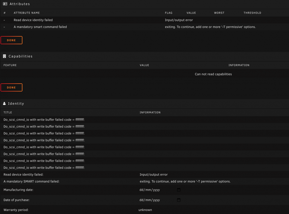

On 2/22/2020 at 2:09 AM, spamalam said:
Hi:
I have an ARECA card with disks set to Pass-Through....the hard drivers are not showing any SMART info or temperatures.
I am able to query the SMART attributes via the commandline as discussed in this thread but am unsure how to configure the custom attributes. My issue is there is only one field to configure the custom attributes per drive, however there are two separate commands that need to be entered as per below.
      smartopt      -d areca,X/Y /dev/sgZ      (you need to specify the X, Y, and Z based on the instructions in step 5 above)
      spinind          -1
At present I am getting the following errors as per the attached screen capture.
Thanks
rt

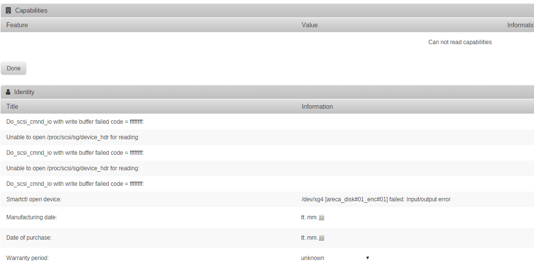

Hello Everyone,
I have been trying to get my unRAID server to expose the temperature and SMART capabilities of my ARECA 1883 12 port card by following this thread:
I followed this guide and included the following in my Go file:
#cp /boot/scripts/60-persistent-storage.rules /lib/udev/rules.d
#udevadm control --reload-rules
#udevadm trigger
Upon reboot after having added the above to my Go file the array had stopped because the disks had to be reassigned, no problem and expected as all the SATA and Areca SCSI disks have their serial numbers documented in the GUI and via the Disk Locations plugin. I was able to reassign those no problem.
Now the problem: I have two by NVME SSD's one mounted in an M.2 slot on the motherboard for my pass-through disk for my VM and another NVME disk mounted in a PCIE to M.2 board for my unRAID cache.
After the reboot after the UDEV utility ran the NVME cards disappeared in the drop down list of available disks and I was unable to reassign the cache drive as it no longer appeared?! They both appear in the SCSI devices list so are still available to the system but are nowhere to be found in the available drop down list.
I found this forum article below that describes a similar problem related to the number of pass-through disks for an ARECA card but I am not experiencing this issue as all my pass-through disks are present.
This is unexpected behaviour; has anyone experienced this problem?
