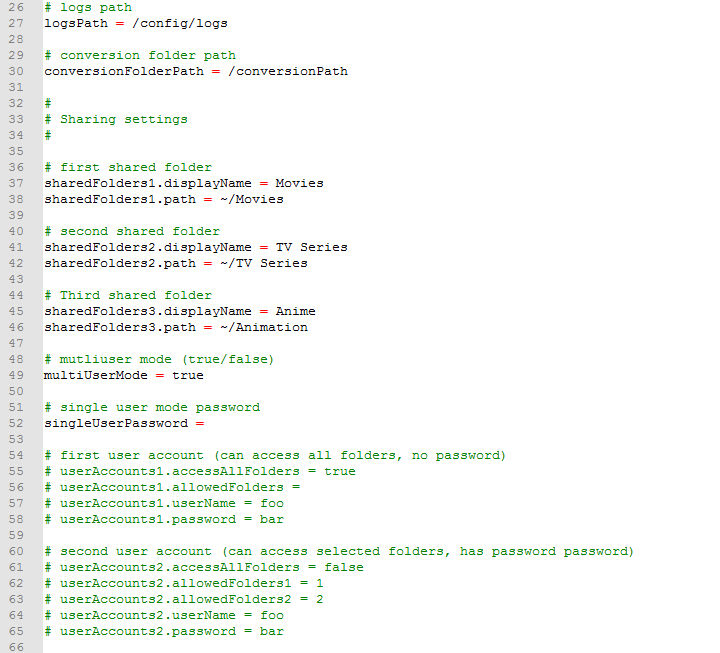

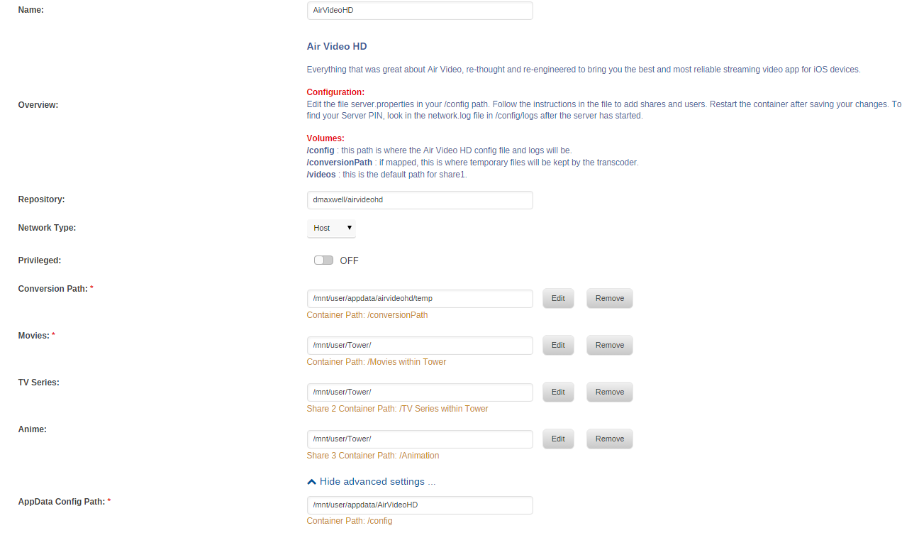

Also I'm still struggling to get my shares to appear, I can connect but the shares won't appear.  I believe I have the config file setup correctly but everyone's saying to have them the same in the Docker part of the GUI and I can't figure out this bit.  Should I be renaming "Host Path 2" and "Host Path 3", if someone like Kimovitz could share their docker screen that would be very helpful.
Edit - I set external access to false in the config file so that should have fixed that silly worry - should have looked at that file more carefully.
Edit2 - Thought it would make things easier if I showed how my systems were setup.  What am I doing wrong here? I feel like everything is set correctly now.
Thought it might have been the ~ in my config file but deleted that and nothing changed.  Doh! Please help.
Edited by ColonialRaptor
