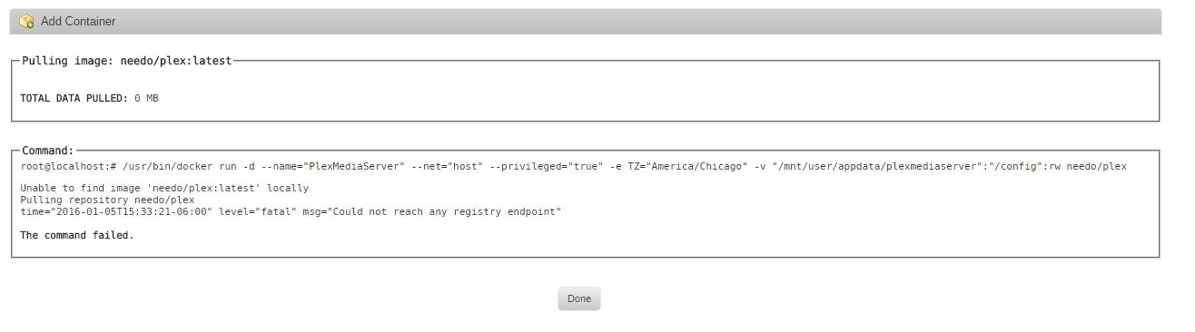

I know this post is somewhat old but I am having this exact same issue. I was having issues with plex (I figured out it was a DNS issues and have since corrected that problem) but before I figured out the DNS issues i  I was uninstalling and reinstalling my Plex docker (I am using the needo plex docker) to try and figure things out and now I can't get it back..
I was able to remove and reinstall the docker several times without and problem but then sudenly I couln't reinstall it. I attached a picture of the error I get now every time I try and install any docker:

Can you ping hub.docker.com from your server?
No I am not able to ping hub.docker.com from my server
Hm. Neither can I but I can download dockers so I guess that's not a good test.
Just to see if your server can get out to the internet, can you ping github.com?
yes, that I can ping.

I got everything fixed and up and running. I was able to upgrade to unRAID 6.1.6 by using a different flash drive (so a different flash GUID was used) to get a trail license key.
With the upgrade everything with unRAID is now working. My Community Applications plugin is working and I can now download dockers without issue.
