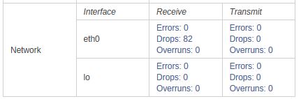

Now, go to the 'Dashboard'.  In the 'System Status' box, look and report the numbers for 'eth0' and 'lo'.

eth0: 1000Mb/s - full duplex
lo:     loopback

You should be able to get something like this:
There is a dropdown in the System Status header. It must be set to Errors to get that information.
Sorry:
I looked through your syslog in the diagnostics file that you uploaded and I didn't see anything unusual.

I have no network card for testing, always use onboard NIC.
I've done this test, to call it something, and I don't understand why it's happening.
If I copy an ISO from the server the speed is the max. available but that same ISO mounted on the PC and copying the files inside takes forever, making it impossible to stream anything.
