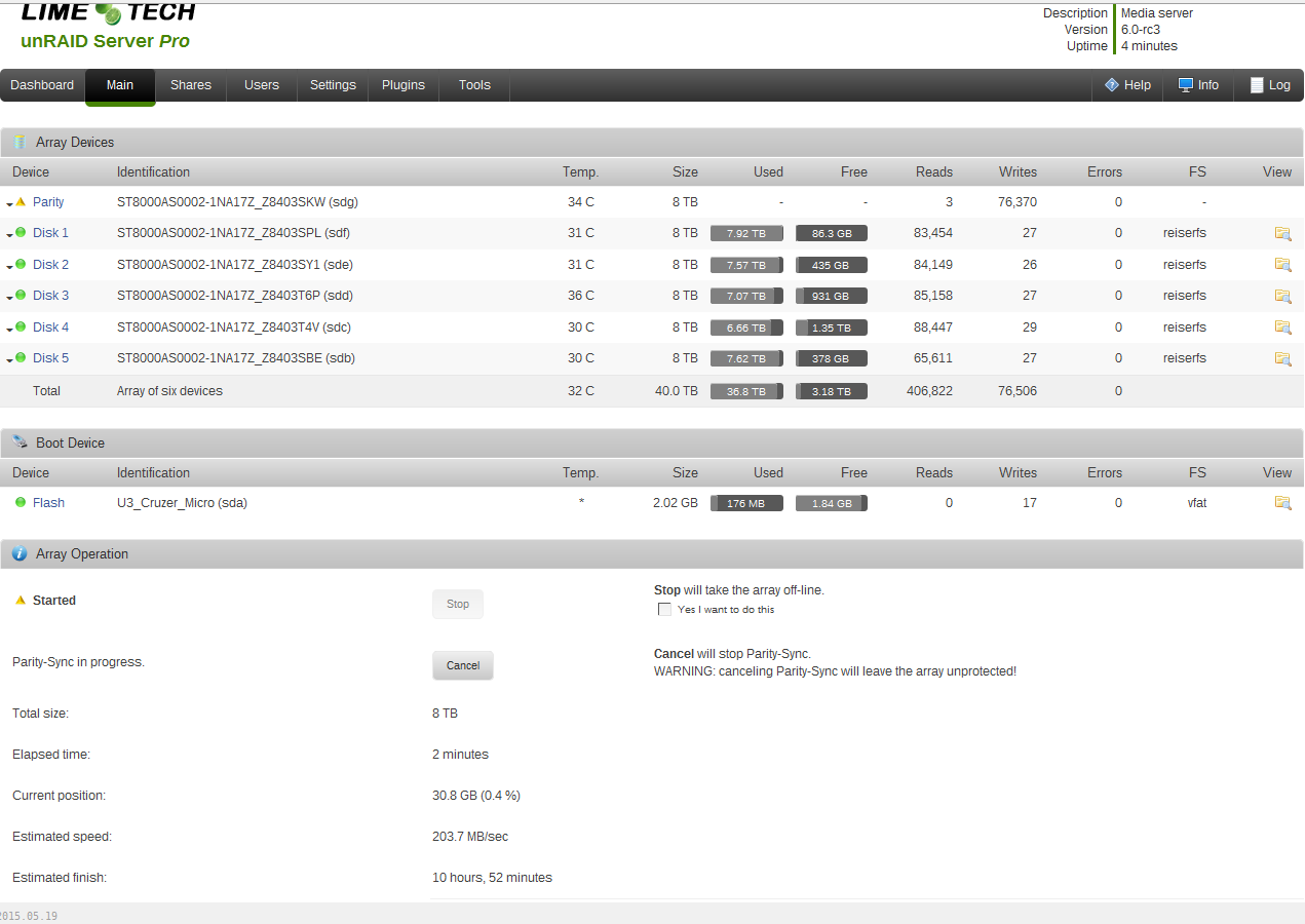

Finished the transfer.
Look at the parity rebuild speed!!
Let's see the final average :)
NICE !!  But of course it will slow down a good bit as it moves towards the inner cylinders.
I'd still expect a very nice average, however.
