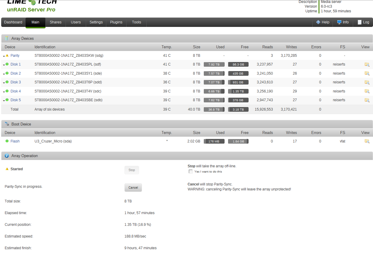

Still flying but I have noticed that disk5 has a lot less reads.
Is this ok?
  • Replies 177
  • Views 31.5k
Yes, that's fine.  The read counts can vary all over the place ... it's "magic"  :)
Actually it has something to do with size of the actual read requests, which can vary based on available buffer space, etc.    In earlier versions of UnRAID (and with IDE controllers), the read counts were uniform; but a few years ago they started being all over the map.  I've asked Tom about this, and never have really understood exactly why they vary so much -- but it IS normal.
