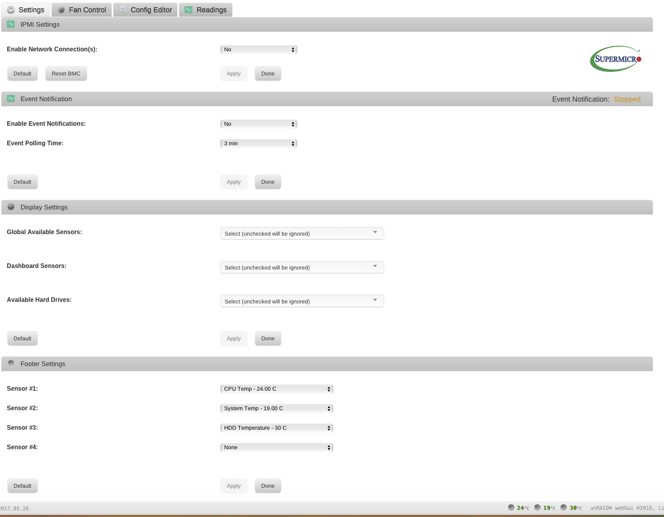

5. There is a settings page at /Settings/IPMI  for event notifications, remote ipmi monitoring and temp/fan sensors to be displayed in the webpage footer. You can pick any four temp or fan sensor to display at the bottom of the unRAID webGui.
6. You can acces the sensor readings and events by navigating to Tools/IPMITools or clicking the Readings button on the settings page.

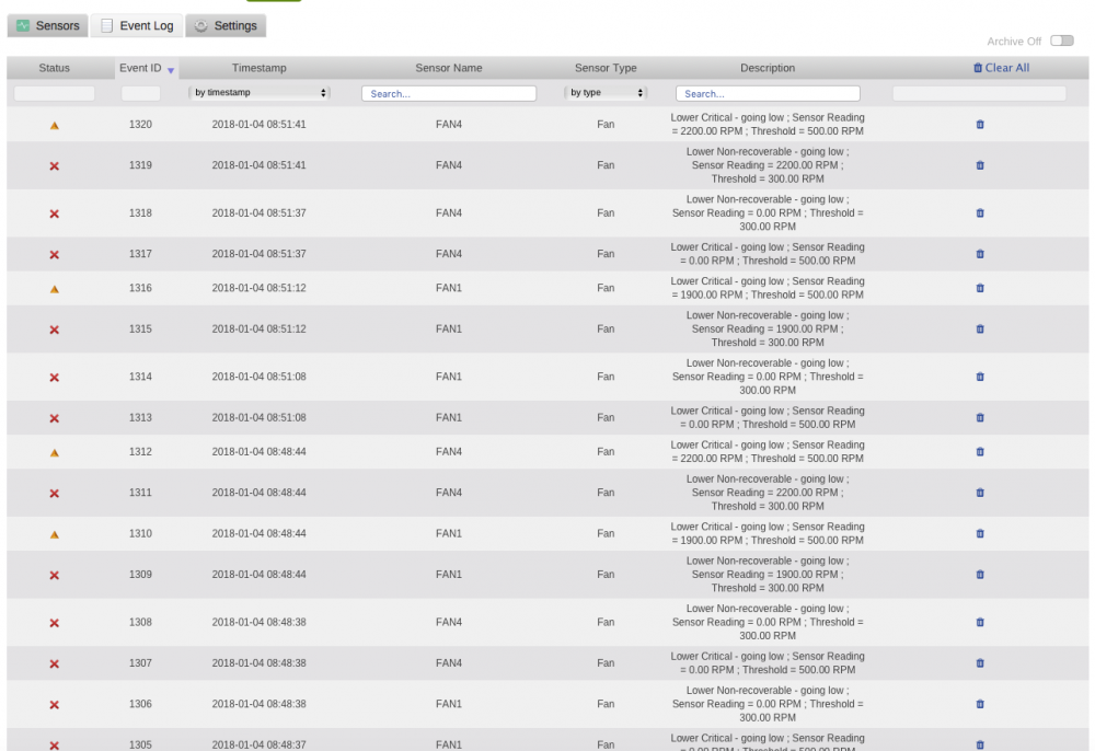

You can test notifications either by sticking your finger in a fan [emoji33] or from the command line "ipmitool event 1" (you can also use 2 or 3) No need for bloody fingers or command line foo anymore, there's a button on the settings page for testing events.  It cycles through 5 different events that are either warnings or alerts.

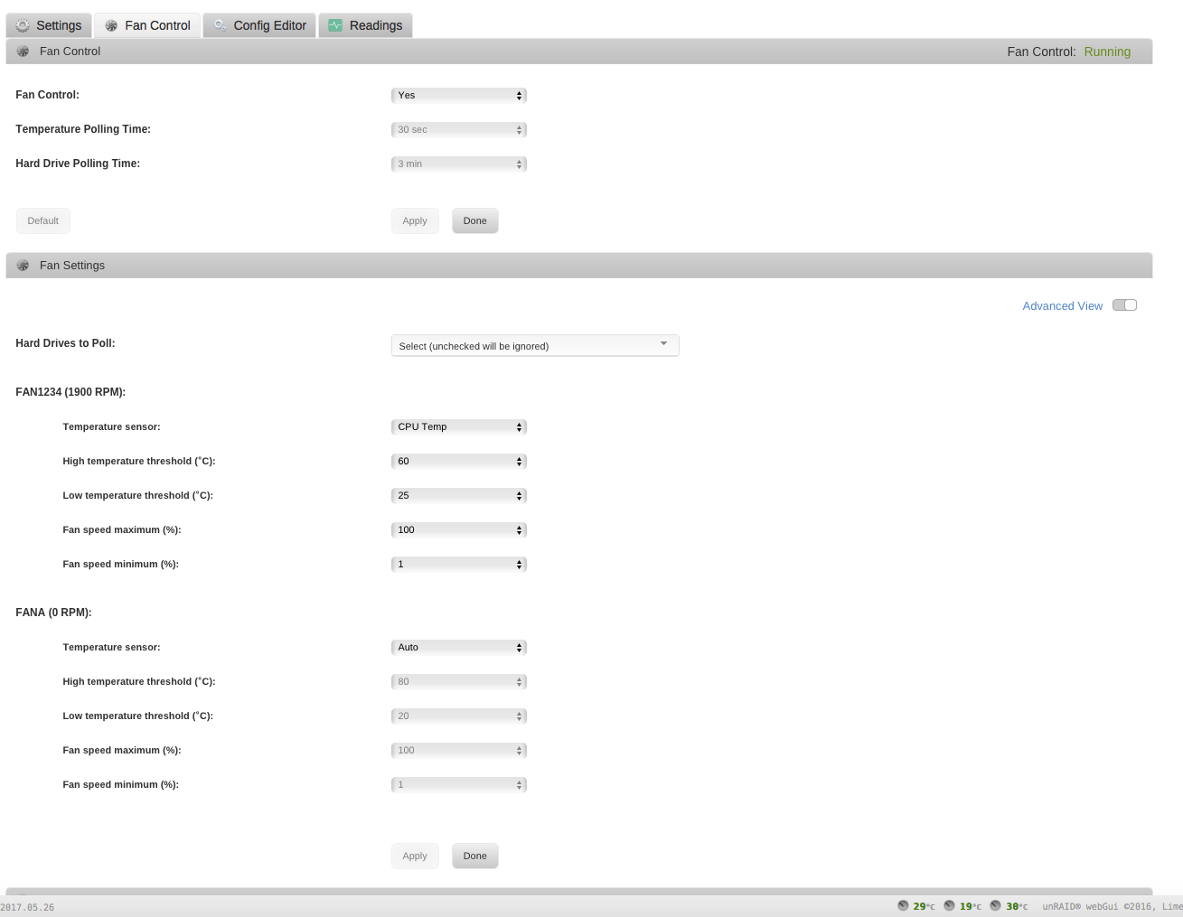

IPMI fan control is supported for ASRock and Supermicro X10/X11 only. For Asrock boards there's a configure button that automatically sets any active fan to their location relative to the ipmi-raw command. If you change or add fan headers you will need to rerun configuration. Then set up temp sensor to monitor for the fan and the temp hi/lo thresholds.  Setting a fan to auto will use the systems smart fan settings. There's also a minimum option to keep a fan from going below a certain percentage and a maximum to limit the highest fan speed.
I've added some extra command line scripts. They will use network connection or local from the plugin as well as filter ignored sensors. They will accept any commands line options that their counterpart accept. They are ipmisensors, ipmisel, ipmifru and ipmiraw.

Supermicro Motherboards
You need to set the thresholds for the fans to a lower value or they will spin up to full speed constantly. The reason for this is because the default threshold is usually 700 rpms. So if the fan's rpms drop below this the bmc spins the fans up to full speed. I have mine set all three thresholds for each fan at 200 - 300 rpms. You can also use the fan speed minimum % setting to help keep the fans above the thresholds you set. I have mine set to 28-34%.
To set the thresholds for to the config editor tab. Then select sensors config and scroll down to each fan and change the thresholds. I set all three thresholds for FANA to 200. The fans on this header are for my hard drives. I set all the other fans to 300. These are my case and CPU fans. Just click save after you're done. You may have to click load config @ unraid start if the settings aren't persistent after a reboot.
IPMI Commands
# ASRock
# ipmi-raw 00 3a 01 00 00 00 00 00 00 00 00
# ipmi-raw 00 3a 01 AA BB CC DD EE FF GG HH
# 00 = smartfan mode
# 01 - 64 = 1% - 100%
# ASRock Dual Socket
# ipmi-raw 00 3a 01 CPU_1_OVERRIDE CPU_1 REAR_1 FRONT_1 FRONT_2 FRONT_3
# ipmi-raw 00 3a 11 CPU_2_OVERRIDE CPU_2 REAR_2 FRONT_4
# ipmi-raw 00 3a 01 00 AA BB CC DD EE
# ipmi-raw 00 3a 11 00 AA BB CC
# Supermicro X10/X11
# ipmi-raw 00 30 70 66 01 00 64
# ipmi-raw 00 30 70 66 AA BB CC
# AA
# 00 - Get value
# 01 - Set value
# BB
# 00 - FAN 1/2/3/4 or CPU_FAN1/2
# 01 - FAN A or SYS_FAN1/2/3
# CC
# 00 to 64 - Set Speed (0-64)
# Supermicro X9
# ipmi-raw 00 30 91 5A 3 00 FF
# ipmi-raw 00 30 91 5A 3 BB CC
# BB
# 10 - FAN 1/2/3/4
# 11 - FAN A
# CC
# 00 to FF - Set Speed (0-255)
