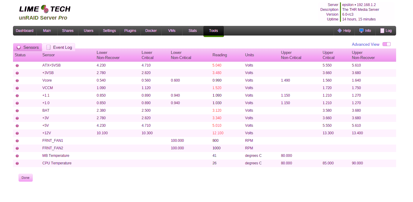

Thank you for this plugin. Just installed it with my new Asrock C2750D4I and can confirm it works out the box with no configuration required.
Some of my sensors are showing as yellow (the voltages mainly) though.
Nice work!
Nice work!
No problem. One of these days I'll get to fan control. Are the sensors in yellow above or below non critical value?

See pic. I had to modify the colours so that the yellow was readable! Red = yellow btw.

Ok I see you don't have any non critical for those sensors. I'll fix that.
