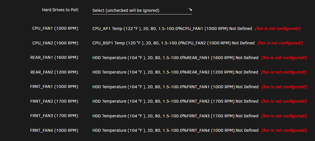

I'm on an asrock RACK TRX40D8-2N2T MB and i have the problem that all fans say "(fan is not configured!)".
Is there anything I need to setup or is that just missing software support?
After some playing around, the configure button now does something (no idea what I did), but it doesn't find any IPMI fan locations:
Checking IPMI fan Locations...
Location 0-1: none
Location 0-2: none
Location 0-3: none
Location 0-4: none
Location 0-5: none
Location 0-6: none
Location 0-7: none
Location 0-8: none
Saving board configuration...
Same question and experience I have:
Nothing I seem to do changes the "(fan is not configured!)" error:
