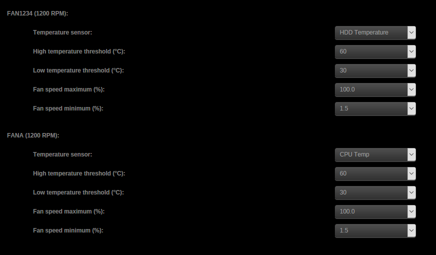

Hey,
I've got a problem and I can not get on with the solution.
I am using a X11SSH-CTF as MB and want to toggle the fan speed automatic, depending on CPU and/or HDD temperature.
So I installed the ipmitools via the Nerd Tools Plugin and afterwards the IMPI Plugin.
I am getting RPM of the fans and a bunch of other values, but after enabling the Fan Control, nothing happens and the fans keep spinning at full speed.
This is the generated log:
2018-06-17 10:53:36 Starting Fan Control
2018-06-17 10:53:36 Setting fans to full speed
2018-06-17 10:53:36 Fan:Temp, FAN1234( 2%):HDD Temp(28°C), FANA( 2%):HDD Temp(28°C)
I have selected the shortest polling time intervals in the drop down so this log should update every 10sec/1min, but nothing happens.

Did you set the fan thresholds with the sensor config editor?

As followed:
Hi Xuvin,
Your fan minimums are way way too low. at 1.5% pwm your fans will not spin at all and your going to be hitting the fan thresholds and the board will override fans to 100%.
Try starting at 65% and see what rpm you get. PWM is not linear with RPM.
Cheers,
gmk2
