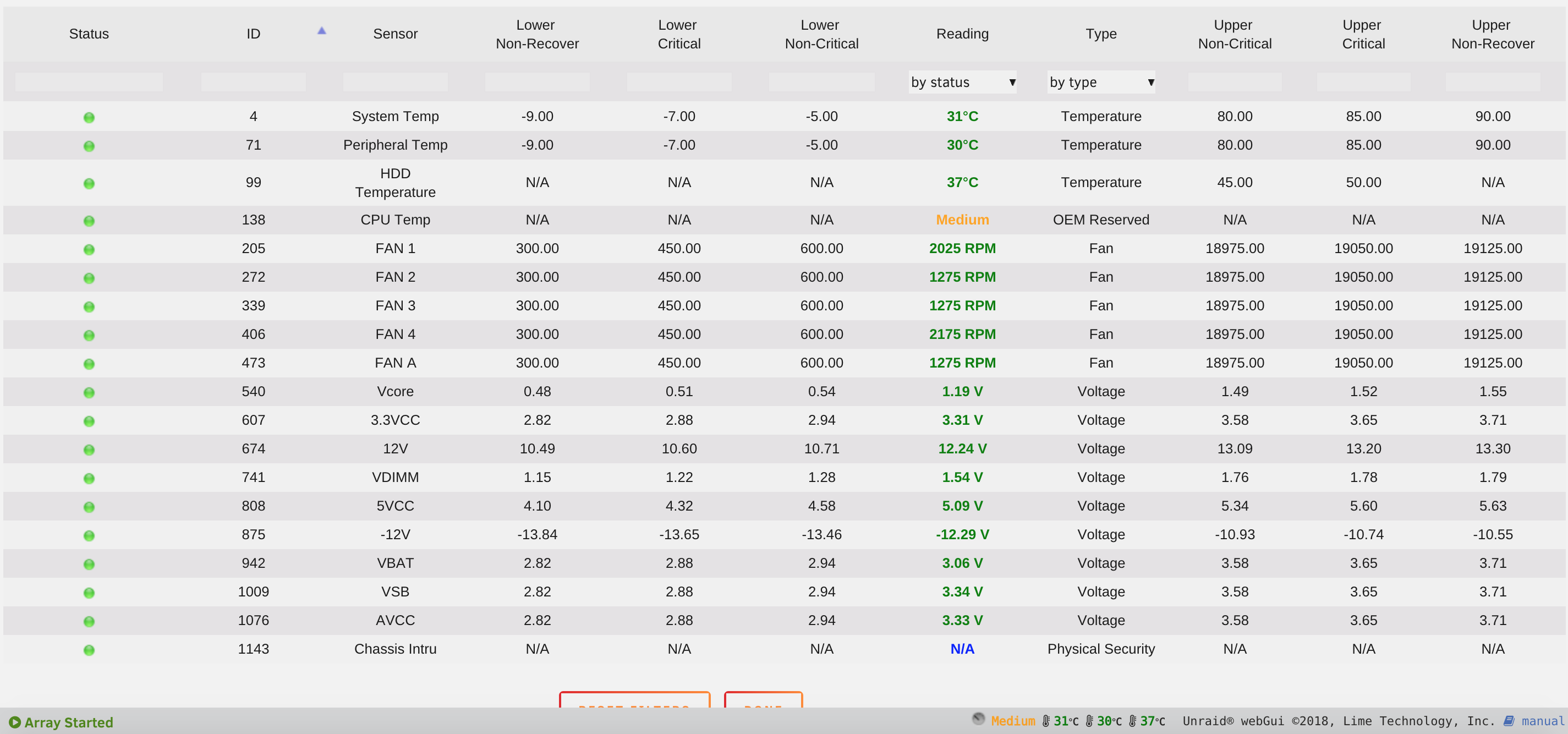

Hi guys - Another X9SCM-F user here.
I wantes to know if it was possible to control my Noctua PWM 4 pin fans with this plugin?
I've attached a screenshot of my current reading. The current reading is showing that all my fans are at MAX, my BMC and BIOS are up to date. Can anyone advise what sort of thresholds i should look at setting to get them in control? Worth noting the server is doing nothing. Do my upper non-critical/upper critical and upper non-recover values look high?
Edited by thestraycat
You can only set them to the 3 predefined settings, full, optimal or standard.
Hi Johnnie.Black  - So no further control than that then? I thought that was the whole point of this plugin? Do you know the differences betwen the 3 modes... I'm shooting for quiet fans....
I thought i'd read another guy had success with the X9SCM earlier in the thread?
It is, but those X9 models don't support more control than that X9 dual socket and most (all?) X10/X11 board do.
Full is self explanatory, standard and optimal look similar to me, but it might depend on the fans used, try each one and check the RPMs.
Thanks trying that now.. Is it possible to change the sensor thresholds on X9SCM-F to effect when the mode changes from low/med/high?

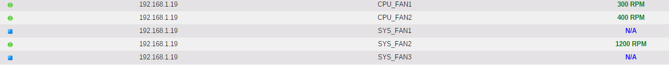

I have the Supermicro X11SCA-F motherboard, and I just set up this plugin which is mostly working great - thanks for adding the support in for the unique fan setup on this board!
The one issue I'm seeing is that as soon as I spin down any drives, the HDD temp is reported as 0 in the fan control log. My drives are SAS drives connected to an LSI 9305-24i. I see this was fixed in an earlier release but I'm guessing there's something unique about my setup that is causing this to happen again. What can I provide to help diagnose the issue? Or am I missing something? Thanks in advance!
Edit: Adding some additional information.
Under the Fan Control settings, the SYS_FAN entry is showing 0RPM, but the HDD temp is displayed.
The fan speed is correctly shown on the Readings tab and in the ipmifan log:
2019-02-05 10:54:20 Fan:Temp, FAN1234(21%):CPU Temp(32°C), FANA(65%):HDD Temp(36°C)
As soon as I spin down a drive, the HDD temp reported in the Fan Control log goes to 0 degrees:
2019-02-05 10:55:20 Fan:Temp, FAN1234(23%):CPU Temp(33°C), FANA(25%):HDD Temp(0°C)
But the HDD temp remains visible in both the Fan Control settings tab, and in the Readings tab:
Edited by rinseaid
Added additional info
OK, I think I see what's happening. On two of my drives, when they spin down the temperature is displayed as * within the unRAID interface. The rest of the drives are spun down but still show temperature. I'm wondering that when the IPMI Fan Control script is attempting to retrieve the highest temperature disk, it gets stuck on the asterisk character.
I've disabled spin down on those two drives and now everything is working as expected.
The sys fan rpm is just taken from the first sys fan. So that's why it's 0 since you're using sys fan 2 only. I'll see if it's possible to get an average or something. It's more of a placeholder for that fan channel which includes all the sys fans. And the other includes all cpu fans.
The settings page and the script are different. Or more accurately the fanscript is completely independent. The settings and reading sections get the hard drive temps from the temps already collected by the Unraid webgui. I didn't want to keep polling drives for temps every time the pages are loaded.
The fanscript polls the hard drives on its own and gets all ipmi data. This is the command used to get the hdd temps where you change x in sdx to the the actual disk letter.
smartctl -A -n standby /dev/sdx 2>/dev/null| grep -m 1 -i Temperature_Cel | awk '{print $10}'
Or try this maybe, the label might be different
If they are all spin down it might be zero.
