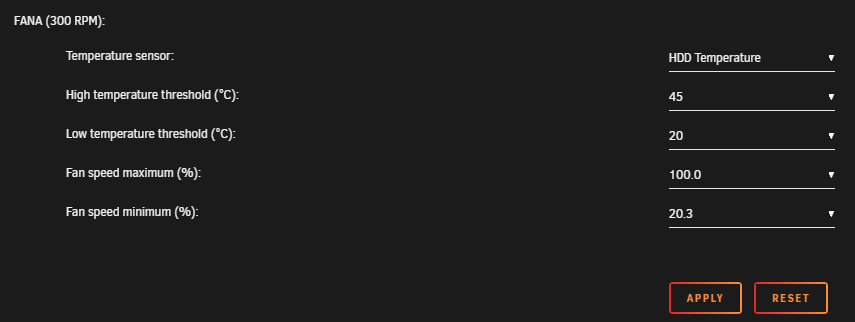

Ok, well I thought I was done.  But apparently no matter what I set for the High temperature threshold for FANA using the HDD Temperature sensor, my fan never ramps up.
If I set the temp sensor to be something like System Temp it works but will not work for HDD temperature.
Edited by IamSpartacus
What are the settings you're using? Just for info, the plugin uses the highest temp hdd not an average. To test I would set the high threshold to the highest temp hdd. Also give it a min or so depending on your interval setting. The see if it spins up to full speed
I'm only polling one drive at the moment (a Samsung 960 Pro NVMe drive).  I've set the high threshold below what the current temp is for that drive and given it a few minutes.  It does nothing even though the HDD Temperature sensor is in fact showing the temperature is above the high threshold.
