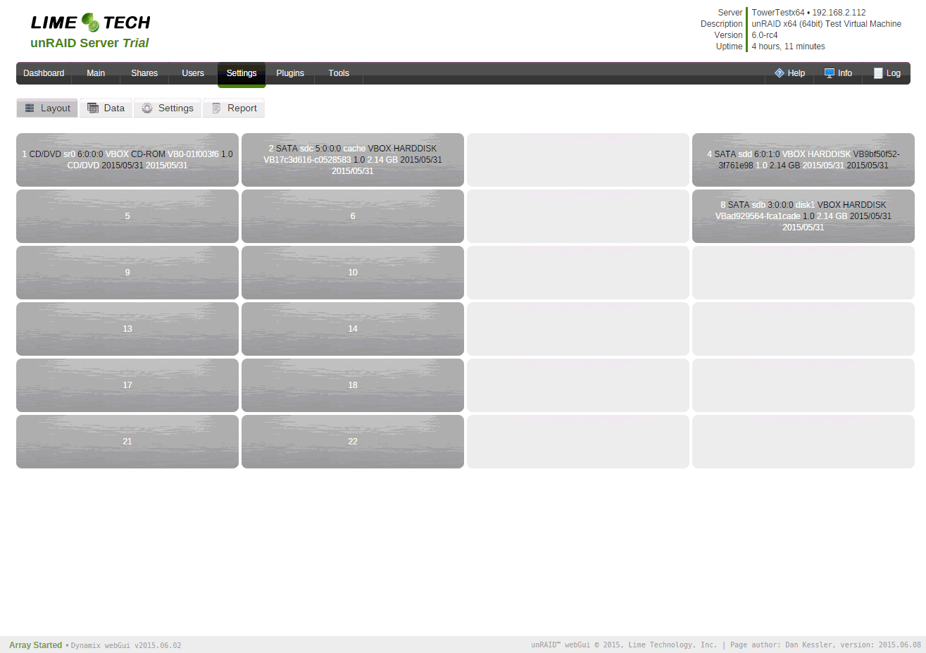

This is great. Got it up and running with no issues. will make life a ton easier in the future when I need to replace a drive. Easier since I am literately building the box now. Will take some time to setup on my rig at home as I don't know the location of any of the drives. I sued the notes section to type in what sata port on the mobo or raid card each drive is plugged into. Thank you a ton!
Now got it all set up and working beautifully, I love it, easy record of where I bought the disk, when  I bought the disk and where it is on my server.
Good to see you got it going OK.
Do you think I should add more columns or are you using the NOTES as for everything else?

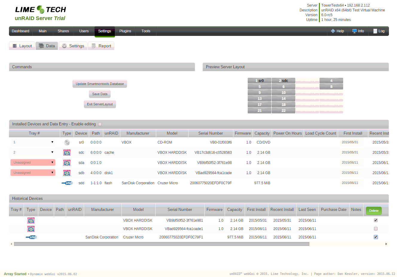

New Release:
2015.06.08
- Added support for HIDDEN TRAYS - click on preview tray to show/hide it - don't forget to save settings
- Increased number of maximum trays to 99 (from 26) - Supports better usage of HIDDEN TRAYS
- Removed "User Utilities" icon - part of unRAID v6 RC4
- Add Enable/Disable for Tooltips
- Fixed "UNRAID" functionality recognition for USB devices
2015.06.08-2
- Fixed bug - introduced by new parameter array "TRAY_SHOW"
- Fixed bug - introduced by new parameter array "GENERAL"
Main change/addition - Hidden Trays - as requested by phenomeus: http://lime-technology.com/forum/index.php?topic=40223.msg378962#msg378962
Click on the trays in the preview table no the "Data" tab and the tray will become hidden/visible. Save your changes and see it on the "Layout" tab.
If a tray is already assigned to a device and then it is hidden then the device that was assigned to it will become unassigned.
See attached screenshots
New Release:
2015.06.08
2015.06.08-2

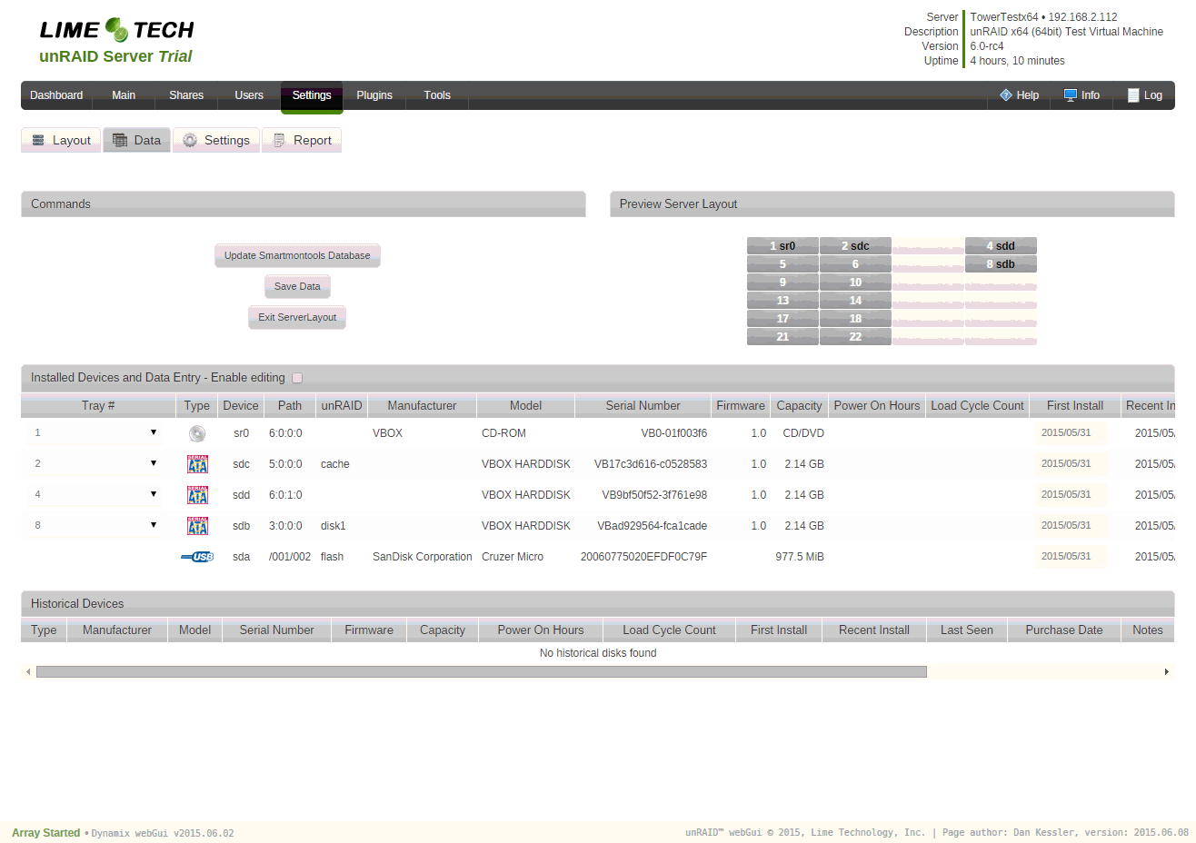

New Release:
2015.06.11
- Remove EMPTY row and columns pull-down options in Layout Settings
- HW scan speed optimization - Changed USB path from "lsusb" to "lsscsi -t"
- HW scan speed optimization - Changed USB data gathering from "lsusb -D" to "udevadm" so I can scan only USB storage devices
Main change
Reduce plugin load time due to storage device information scanning.
On my server with 8 HDDs and 1 USB storage device (flash) I went from over 10 seconds to under 3 seconds.
New Release:
2015.06.12
- Added device status icon (same as unRAID icons) - as requested  :)
- Added option to delete historical devices (per device) from database under "Historical Device" table
I experience a problem which I haven't seen reported by anyone else, so I wonder whether I'm the only person affected.
On the 'Layout' tab, there's a pop-up (do you call it a tooltip?), which provides detailed info about the drive in the tray over which the mouse pointer is positioned.
My problem is that this pop-up is only visible for the right-most trays.  As the mouse pointer moves to the trays further left, the pop-up moves further right - this results in it moving out of the current window and becoming invisible (unless you have a very wide display window/screen).
I'm using FF38.0.5 on ArchLinux.  My trays are configured in a 3 row/5 column layout in vertical orientation.
As an aside, I do wonder whether this plugin ought to be accessed from the 'Tools' page, rather than the 'Settings' page.
I acknowledge this issue (also on MS Internet Explorer) - somehow I missed it - on Chrome it is working flawlessly.
On first glance it seems that on FF and MSIE the "hover" is relative to the the whole matrix (right edge of the array) and on Chrome it is relative to each TRAY as it should be.
Need to understand why ...  :o:-\  ??? and fix it  :)
