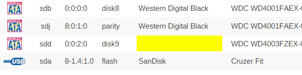

As you can see there is no manufacturer information listed.

So how does a WD drive have a missing "Manufacturer" field? Strange, right?
This series  WD4003FZEX is probably not in the database. Maybe it can be requested/added.
Correct. I just looked and that model is not in the database. I guess not a very popular model. I'll see if I can make the request.
