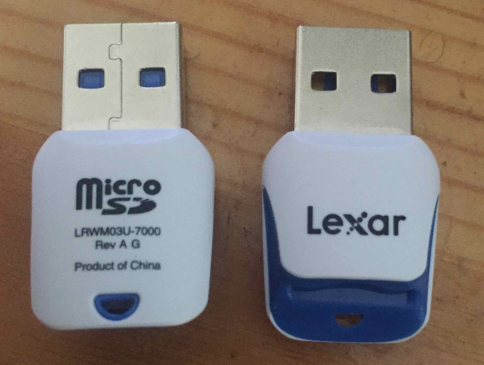

1. I intend to use either an internal microSD card or USB memory stick as the boot device. Are either of these an issue?

1 = both will work.  Mem stick is preferred, but with correct card reader microsd cards could work.

Card readers typically don't work. UnRaid requires a unique GUID and most (all?) card readers don't have this. Without a unique GUID, you cannot establish a valid license. USB sticks are the ticket!
