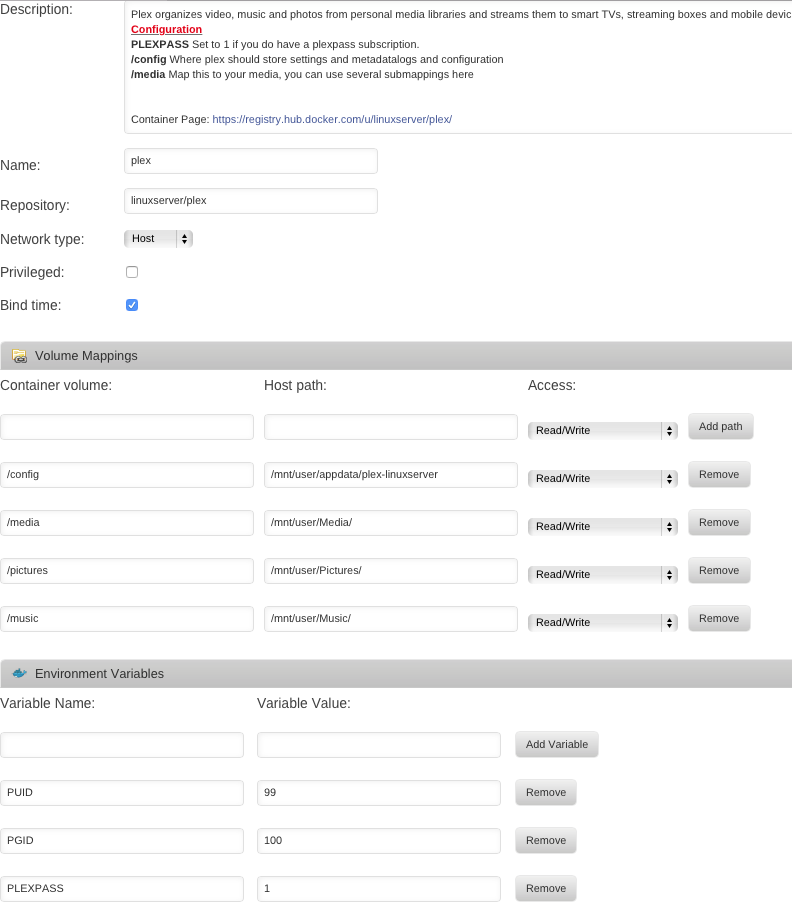

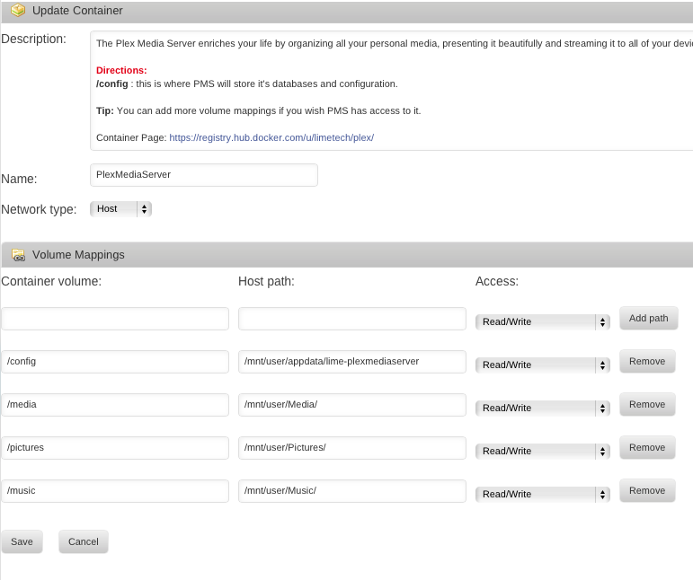

Just installed this docker and I'm attempting to move from the Lime Technology docker but I've hit a snag. All of my movies have been scanned and imported, but Plex isn't finding the artwork for any of them. All it shows is a random thumbnail from the middle of the movie resized and squished to fit the artwork icon. What's up with this? Is anyone else having this problem or did I do something wrong?
Yes, and everything worked when using the plugin in version 5, and it all came up fine when using the Lime Tech docker. But just in case here is an example of my movie file structure:
/Media/Theatrical Movies/101 Dalmatians (1961)/101 Dalmatians (1961)
/Media/Theatrical Movies/Anna and the King (1999).m4v
/Media/Theatrical Movies/Avater (2009)/Avater (2009) part 1.m4v
/Media/Theatrical Movies/Avater (2009)/Avater (2009) part 2.m4v
/Media/Theatrical Movies/Batman Begins (2005).m4v
As you can see, some of them are in folders named after the movie and some are just in the root Theatrical Movies/ folder. I started without the folder named after the movie, but then started using it later and just haven't converted all of the files to follow that convention.
Did you copy over your Plex data or did you start fresh? Screen shot your docker settings for Plex.
Ok, so here's what I've uncovered so far. I restarted the docker and that didn't change anything that I can tell. But I let it sit for awhile to see if it was just really slow. Now the covers show up, but only if I manually go into the details of the movie. It doesn't seem to be automatically matching the movies without me going into each and every movie. It's better than nothing, but going to be a tedious and slow process to go through everything.
Anyway, I've attached the screenshots of the settings as requested in case we can fix this little bug.
Why do you have different config directories for the two dockers?  Typically if you are switching between Plex dockers you would shutdown/delete the old one, then setup the new one to point at the same config directory the old one was using.  That way you keep all of your settings.  See:
  https://lime-technology.com/forum/index.php?topic=41562.msg394565#msg394565
  https://lime-technology.com/forum/index.php?topic=41609.0
I don't know why the new one is downloading data slower, perhaps the Plex agents throttle how many requests you can make in a single day?

IMAGE ID [8172f09f7095]: Downloading 100% of 130 MB. Verifying Checksum. Download complete. Extracting. Pulling repository linuxserver/plex.
IMAGE ID [031fcb0b8e62]: Pulling image (latest) from linuxserver/plex. Pulling image (latest) from linuxserver/plex, endpoint: https://registry-1.docker.io/v1/. Pulling dependent layers.
IMAGE ID [511136ea3c5a]: Download complete.
IMAGE ID [53f858aaaf03]: Download complete.
IMAGE ID [837339b91538]: Download complete.
IMAGE ID [615c102e2290]: Download complete.
IMAGE ID [b39b81afc8ca]: Download complete.
IMAGE ID [8254ff58b098]: Download complete.
IMAGE ID [ec5f59360a64]: Download complete.
IMAGE ID [2ce4ac388730]: Download complete.
IMAGE ID [2eccda511755]: Download complete.
IMAGE ID [5a14c1498ff4]: Download complete.
IMAGE ID [e206d5fe2a5b]: Download complete.
IMAGE ID [cfd284ec74f2]: Download complete.
IMAGE ID [e6624efa03db]: Download complete.
IMAGE ID [d680890e907c]: Download complete.
IMAGE ID [26a00a9ab589]: Download complete.
IMAGE ID [8172f09f7095]: Pulling metadata. Pulling fs layer. Error downloading dependent layers.
IMAGE ID [031fcb0b8e62]: Error pulling image (latest) from linuxserver/plex, endpoint: https://registry-1.docker.io/v1/, Driver btrfs failed to create image rootfs 8172f09f709548ceae7708b245cceab6776eeab3d5fb0f8c0107bd4a4d464c00: Failed to create btrfs snapshot: no space left on device. Error pulling image (latest) from linuxserver/plex, Driver btrfs failed to create image rootfs 8172f09f709548ceae7708b245cceab6776eeab3d5fb0f8c0107bd4a4d464c00: Failed to create btrfs snapshot: no space left on device.
TOTAL DATA PULLED: 130 MB
Command:
root@localhost:# /usr/bin/docker run -d --name="plex" --net="host" -e PUID="99" -e PGID="100" -e PLEXPASS="1" -e TZ="America/Halifax" -v "/mnt/user/appdata/plex/":"/config":rw -v "/mnt/user0/":"/media":rw -v "/tmp":"/transcode":rw linuxserver/plex
Unable to find image 'linuxserver/plex:latest' locally
latest: Pulling from linuxserver/plex
8172f09f7095: Pulling fs layer
4b5ccf93ca2a: Pulling fs layer
cf788be675fd: Pulling fs layer
dad4ea3f0ebd: Pulling fs layer
91bcfb40161d: Pulling fs layer
05c5b8ad1f8a: Pulling fs layer
29af19c672e1: Pulling fs layer
1945f71177cf: Pulling fs layer
6c64bfaf5450: Pulling fs layer
031fcb0b8e62: Pulling fs layer
511136ea3c5a: Already exists
53f858aaaf03: Already exists
837339b91538: Already exists
615c102e2290: Already exists
b39b81afc8ca: Already exists
8254ff58b098: Already exists
ec5f59360a64: Already exists
2ce4ac388730: Already exists
2eccda511755: Already exists
5a14c1498ff4: Already exists
e206d5fe2a5b: Already exists
cfd284ec74f2: Already exists
e6624efa03db: Already exists
d680890e907c: Already exists
26a00a9ab589: Already exists
031fcb0b8e62: Layer already being pulled by another client. Waiting.
4b5ccf93ca2a: Verifying Checksum
4b5ccf93ca2a: Download complete
cf788be675fd: Verifying Checksum
cf788be675fd: Download complete
05c5b8ad1f8a: Verifying Checksum
05c5b8ad1f8a: Download complete
91bcfb40161d: Verifying Checksum
91bcfb40161d: Download complete
29af19c672e1: Verifying Checksum
29af19c672e1: Download complete
1945f71177cf: Verifying Checksum
1945f71177cf: Download complete
6c64bfaf5450: Verifying Checksum
6c64bfaf5450: Download complete
031fcb0b8e62: Verifying Checksum
031fcb0b8e62: Download complete
031fcb0b8e62: Pulling image (latest) from linuxserver/plex
031fcb0b8e62: Pulling image (latest) from linuxserver/plex, endpoint: https://registry-1.docker.io/v1/
031fcb0b8e62: Pulling dependent layers
511136ea3c5a: Download complete
53f858aaaf03: Download complete
837339b91538: Download complete
615c102e2290: Download complete
b39b81afc8ca: Download complete
8254ff58b098: Download complete
ec5f59360a64: Download complete
2ce4ac388730: Download complete
2eccda511755: Download complete
5a14c1498ff4: Download complete
e206d5fe2a5b: Download complete
cfd284ec74f2: Download complete
e6624efa03db: Download complete
d680890e907c: Download complete
26a00a9ab589: Download complete
8172f09f7095: Pulling metadata
8172f09f7095: Error downloading dependent layers
031fcb0b8e62: Error pulling image (latest) from linuxserver/plex, endpoint: https://registry-1.docker.io/v1/, Driver btrfs failed to create image rootfs 8172f09f709548ceae7708b245cceab6776eeab3d5fb0f8c0107bd4a4d464c00: Failed to create btrfs snapshot: no space left on device
031fcb0b8e62: Error pulling image (latest) from linuxserver/plex, Driver btrfs failed to create image rootfs 8172f09f709548ceae7708b245cceab6776eeab3d5fb0f8c0107bd4a4d464c00: Failed to create btrfs snapshot: no space left on device
time="2015-07-25T18:13:32-03:00" level=fatal msg="Error pulling image (latest) from linuxserver/plex, Driver btrfs failed to create image rootfs 8172f09f709548ceae7708b245cceab6776eeab3d5fb0f8c0107bd4a4d464c00: Failed to create btrfs snapshot: no space left on device"
Looks like you have run out of space on your docker img
