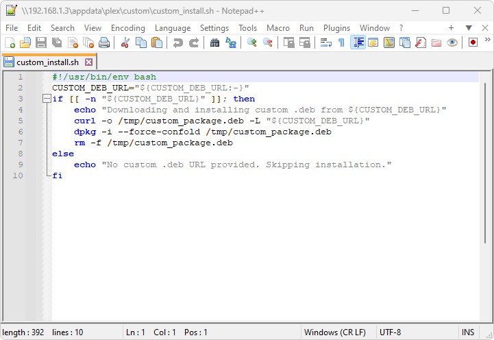

bally12345 Posted Tuesday at 05:16 PM Share Posted Tuesday at 05:16 PM (edited) 47 minutes ago, MowMdown said: I made a mistake, I created a folder called "custom" inside my plex appdata folder, then for the script pathing just map to the "custom" folder and leave out the script. That's my bad. Also looks like I used an underscore instead of a dash in the script name. Edit: See updated instructions: So that still didnt work but noticed the following in plex log. [custom-init] Files found, executing [custom-init] custom_install.sh: executing... /custom-cont-init.d/custom_install.sh: line 10: syntax error near unexpected token `fi' /custom-cont-init.d/custom_install.sh: line 10: `fi' [custom-init] custom_install.sh: exited 2 Edited Tuesday at 05:16 PM by bally12345 Quote Link to comment
MowMdown Posted Tuesday at 05:24 PM Share Posted Tuesday at 05:24 PM (edited) That's strange, no idea why it works for me? Maybe try copying it from this URL where I got it from originally? https://gist.github.com/vertigo235/051b076f2ad79132b87c7da37158e1b8 Here's the Plex forum post with the links to the .deb files too: https://forums.plex.tv/t/hevc-encoding-forum-preview/888127 Edited Tuesday at 05:29 PM by MowMdown Quote Link to comment

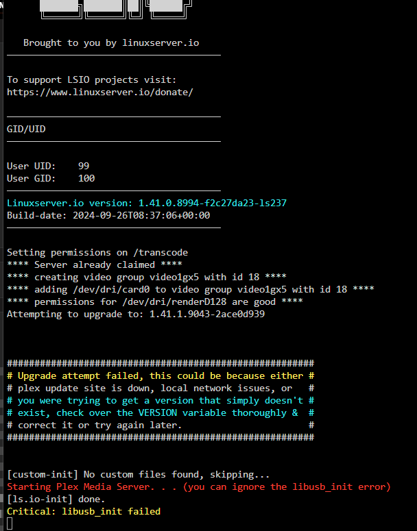

bally12345 Posted Tuesday at 05:28 PM Share Posted Tuesday at 05:28 PM 1 minute ago, MowMdown said: That's strange, no idea why it works for me? Maybe try copying it from this URL where I got it from originally? https://gist.github.com/vertigo235/051b076f2ad79132b87c7da37158e1b8 Yeh I did that and saved using notepad just incase notepad++ was doing something weird. No big deal not in a rush. When I run it again same as before. Setting permissions on /transcode **** Server already claimed **** **** permissions for /dev/dri/card0 are good **** **** permissions for /dev/dri/renderD128 are good **** No update required [custom-init] Files found, executing [custom-init] custom_install.sh: executing... [custom-init] custom_install.sh: exited 2 Starting Plex Media Server. . . (you can ignore the libusb_init error) [ls.io-init] done. Critical: libusb_init failed Quote Link to comment
MowMdown Posted Tuesday at 05:40 PM Share Posted Tuesday at 05:40 PM @bally12345 what happens if you console into the plex container? Can you see the "custom-cont-init.d" folder and script inside? what happens if you try and execute it while you're inside the container? Quote Link to comment
