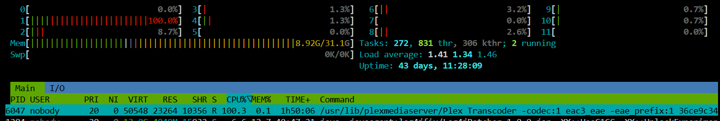

Plex Appears to be Transcoding when not in use
I noticed one of my cores was always at 100% in the unRaid dashboard. A simple htop in the console shows it's coming from Plex. Except, when I go to my plex server in a browser it reports no activity. I checked conversions, nothing there. I also checked all my settings and I have nothing set to optimize, or transcode. I've been using Plex forever and I've never set it to optimize or pre-transcode, etc.
I love this container, just not sure what to do. Oh, if I stop it and then restart it goes away and I can use Plex like normal. Then, some indeterminate time (within 24 hrs) it starts up again.
unRaid 6.12.6

Do you have any Scheduled Tasks in Plex?  They have a section in server settings and a set time that you can compare to when you typically see CPU usage peg 1 core 100%
This could be audio normalizing, video thumbnail generation, intro/credit detection, local metadata updates, database backups, etc.  Some of those settings might be on libraries themselves.
Link to comment
OK, yes, I have all the same things checked as you. I guess it could be doing any of those things. That said, it is around 10:00am and my time matches your picture. So the tasks should have stopped right? Thank you for the quick reply!
Link to comment
I'm no expert on all the other things Plex server does in the background, but if it starts pretty much on an hour mark, it is more than likely some automated task or clean-up happening.  In Settings at the bottom, there is a Console Menu that lets you see the active logs of the server and you might be able to search through that to see what is using up your CPU in Plex.
Link to comment
Thank you. There is nothing there now which is causing any CPU hit (since I restarted the container) I'll check the console again next time I notice the one core going 100%. It surprisingly chatty IMO  . Here is an example of a couple of seconds (attached picture)

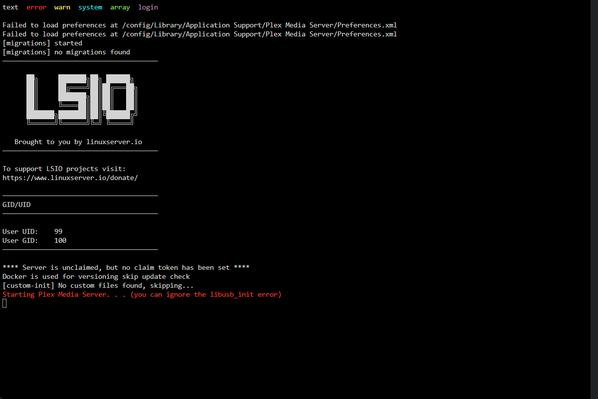

I recently starting having an issue where Plex does not startup correctly (see screenshot).
It just gets to "Starting Plex Media Server. . . (you can ignore the libusb_init error)" in red and does not continue from there.
I have tried uninstalling and reinstalling from Previous Apps but I get the same behavior.
Not sure where to start with troubleshooting.  Before I blow this container away and start from scratch, I was hoping someone on here will be able to help.
Thanks!
