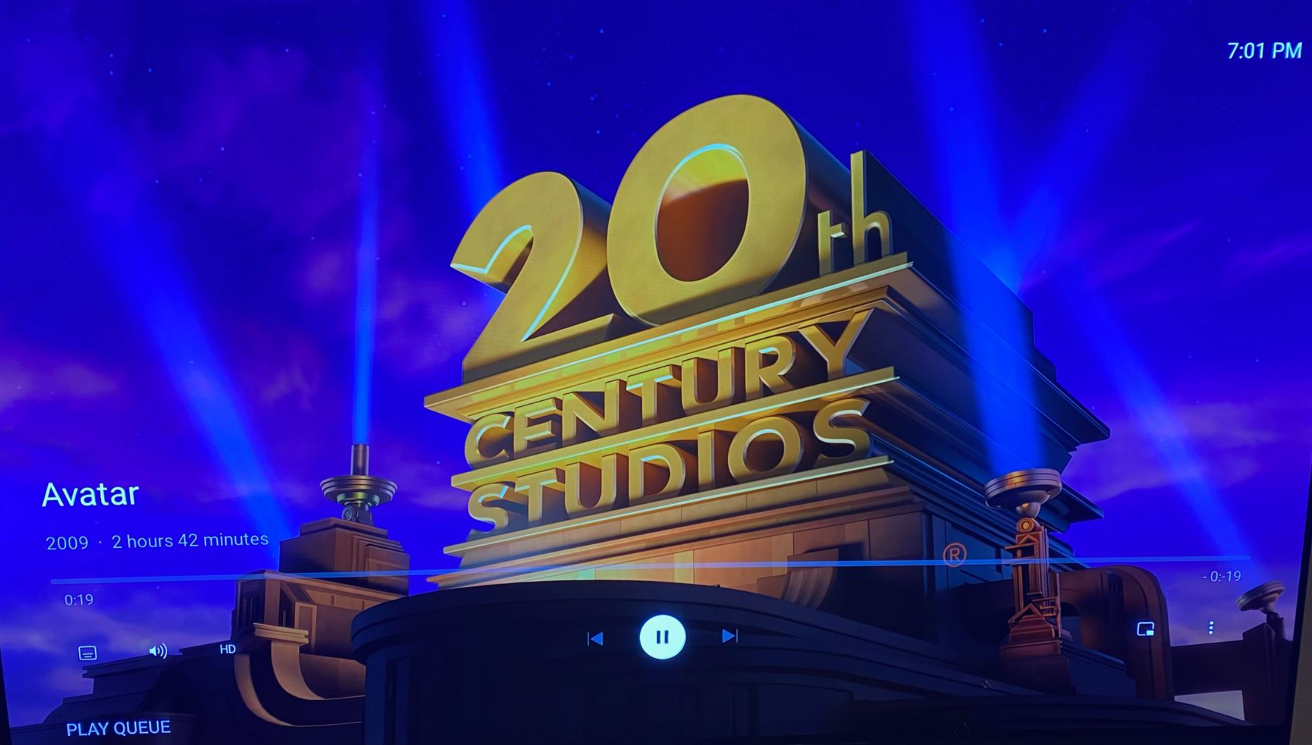

in plex it shows the correct runtime. If you see that is shows 2hours 42 min
However the "play bar" shows 0.19 -> -0.19 this will change as the movie plays.. If you try an skip forward the movie restart from time 0.

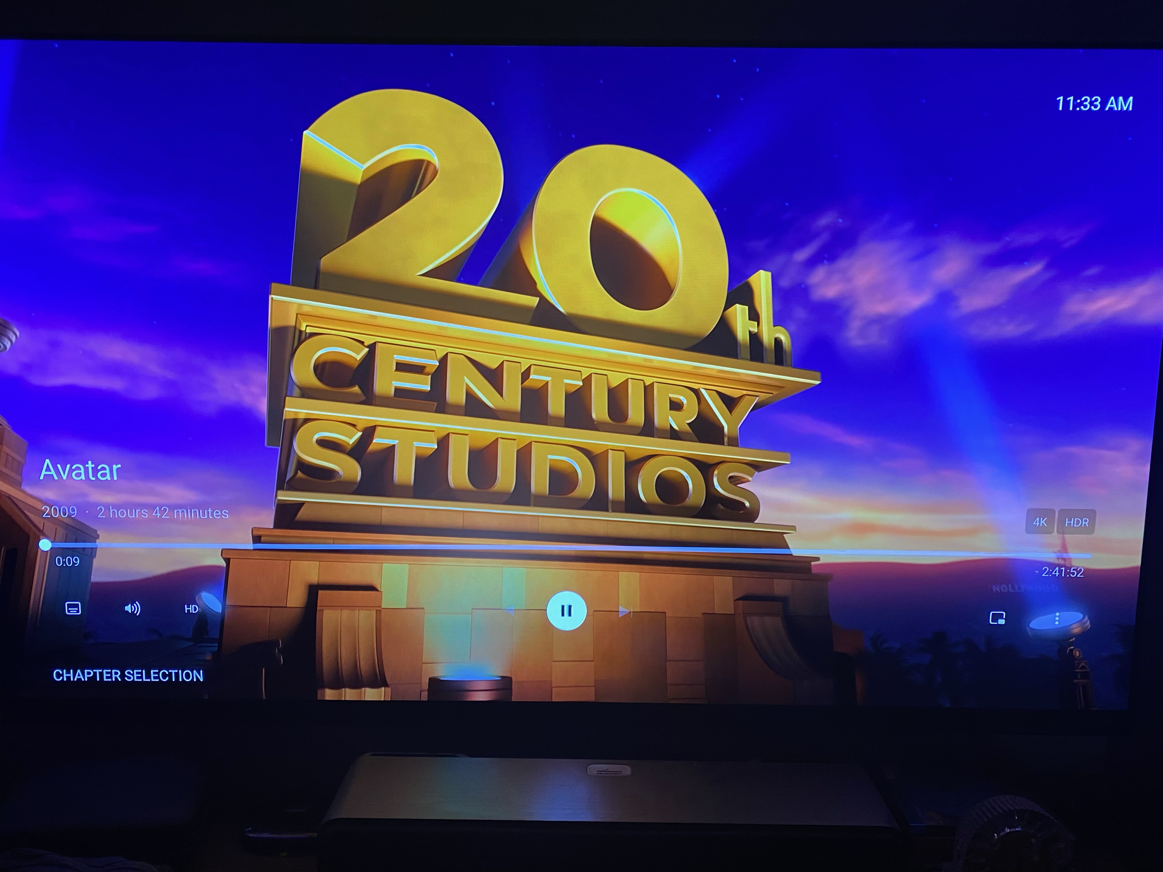

for reference here is how the movie shows up under a ubuntu box using the same hardware streaming to the same nvidia shield device. Notice the time starts at 0 and goes to -2.41:52 as expected. The little circle in the play bar can be moved forward no issue at all. I am only able to get it to work this way in the unraid version by forcing a transcode.
Edited by xokia
for reference here is how the movie shows up under a ubuntu box using the same hardware. Notice the time starts at 0 and goes to -2.41:52 as expected. The little circle in the play bar can be moved forward no issue at all.
Try running analyze on the movie in Plex.

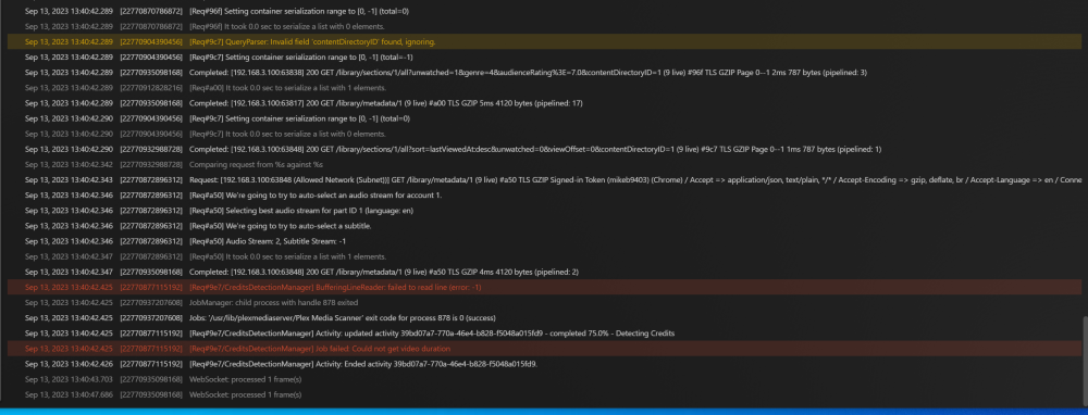

Good point I have tried that it spins and completes quickly. That could potentially be where the issue is. This should force a scan of credits and a scan of the movie. I am not seeing it do that. Maybe a wierd permission issue since I keep my movies separate from the plex install directory. Let me look into that.
I should be able to log into the container and change permissions to plex.plex
Edited by xokia
Link to comment
9 minutes ago, xokia said:
Have tried that it spins and completes quickly. That could potentially be where the issue is. This should force a scan of credits and a scan of the movie. I am not seeing it do that. Maybe a wierd permission issue since I keep my movies separate from the plex install directory. Let me look into that.
You don't set permissions within the container, but within Unraid. That's the mapping of /movies for within your docker template.
It could be that the files itself are limited in access, but then it wouldn't be able to play it in the first place.
You could try the unraid file explorer (top right icon) and go to your plex media folder and select it and set permissions to everything read write. The file could also be corrupt, so are all your test files having this issue?
file plays fine so I doubt its corrupt. I can transfer it back to dekstop and plays fine. Only using 1 test file to limit complexity and time it takes to do things. I'm suspecting maybe a read-only issue worth looking into. Not sure what it needs to do to the file to scan it but I will check this later when I get back home.
*edit*
This is what I get when I try to analyze the video fails detecting credits and length unsure of why
ok feel like a boob.........file was corrupted.  Played when transferred over to desktop but I didn't go to the end of the file which appears to be missing. Which explains why it did not know EOF.
I retransferred a fresh copy from ubuntu directory and now its scanning the file as expected and streams correctly.
So had 2 issues:
       1. Missing updated drivers -> Would help if this was in the driver directory
       2. corrupted file :(
Appreciate all the help!
Edited by xokia

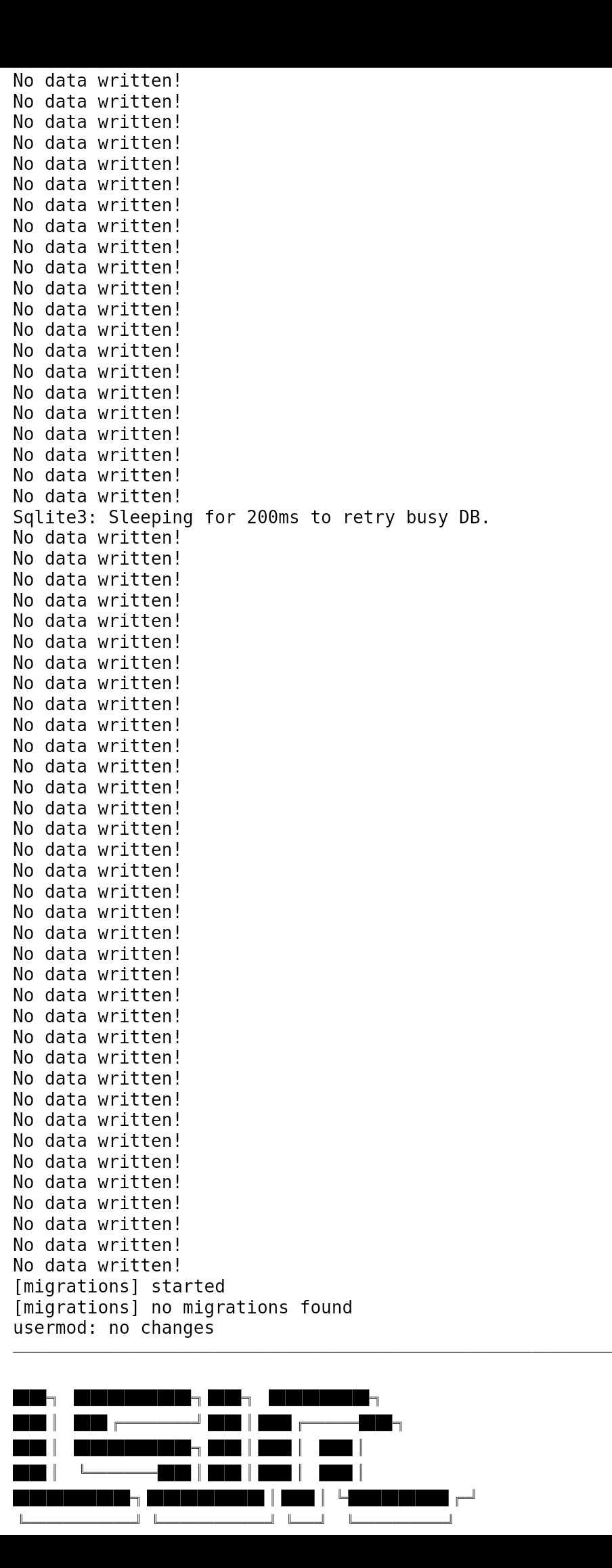

Hi, so I'm using Plex on a seperate cache SSD (setup as a pool) everything been's working great but since a few weeks I've been getting errors... The docker keeps running, but nothing is working. Also the logs are filled with this:
Starting Plex Media Server. . . (you can ignore the libusb_init error)
libc++abi: terminating with uncaught exception of type boost::filesystem::filesystem_error: boost::filesystem::create_directories: I/O error [system:5]: "/config/Library/Application Support/Plex Media Server/Cache", "/config/Library/Application Support/Plex Media Server/Cache"
This error just keeps spamming over and over again. The only fix I have found so far is to stop the array and re-start it as just restarting the docker results in an error.
At first glance it seems like the entire Plex SSD becomes inaccessible. I have attached the diagnostics from before restarting the array. Thanks guys!
tower-diagnostics-20231012-0735.zip

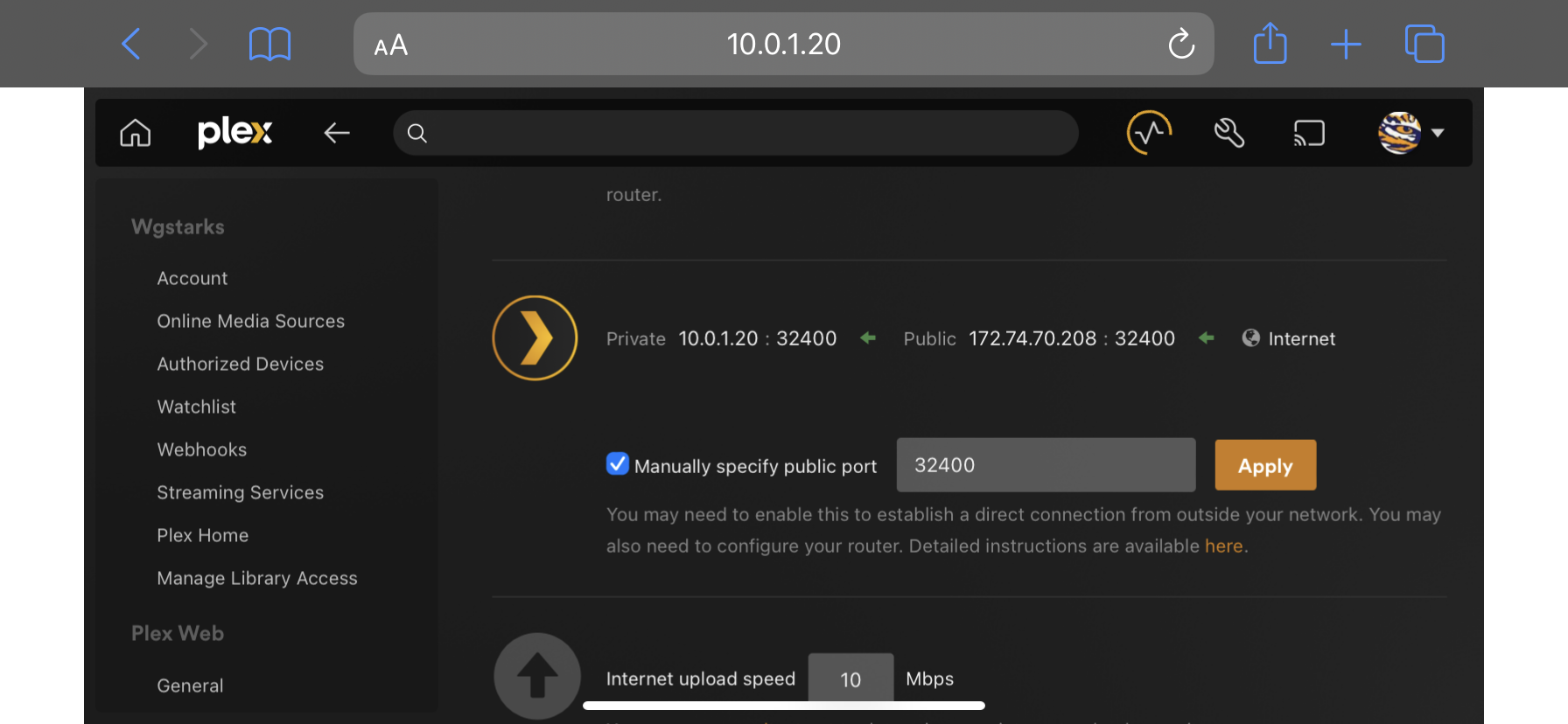

Hi i was wondering if anyone could help me, i am unable to port forward for Plex remote access.
I have a unifi dream machine and have port forwarding enabled and routed to 32400 however when i test the remote access from settings it flashes green saying i have access and then about 5 seconds later goes back to red.
Plex is setup on a custom IP from its docker container.
I have changed IPs and external ports with no success.
I thought it had something to do with my bound NICs for the unRaid but as i'm new to unRaid and not really great at networking, i cannot diagnose the issue correctly.
I would sincerely be grateful for any assistance or for pointing me in the right direction,
