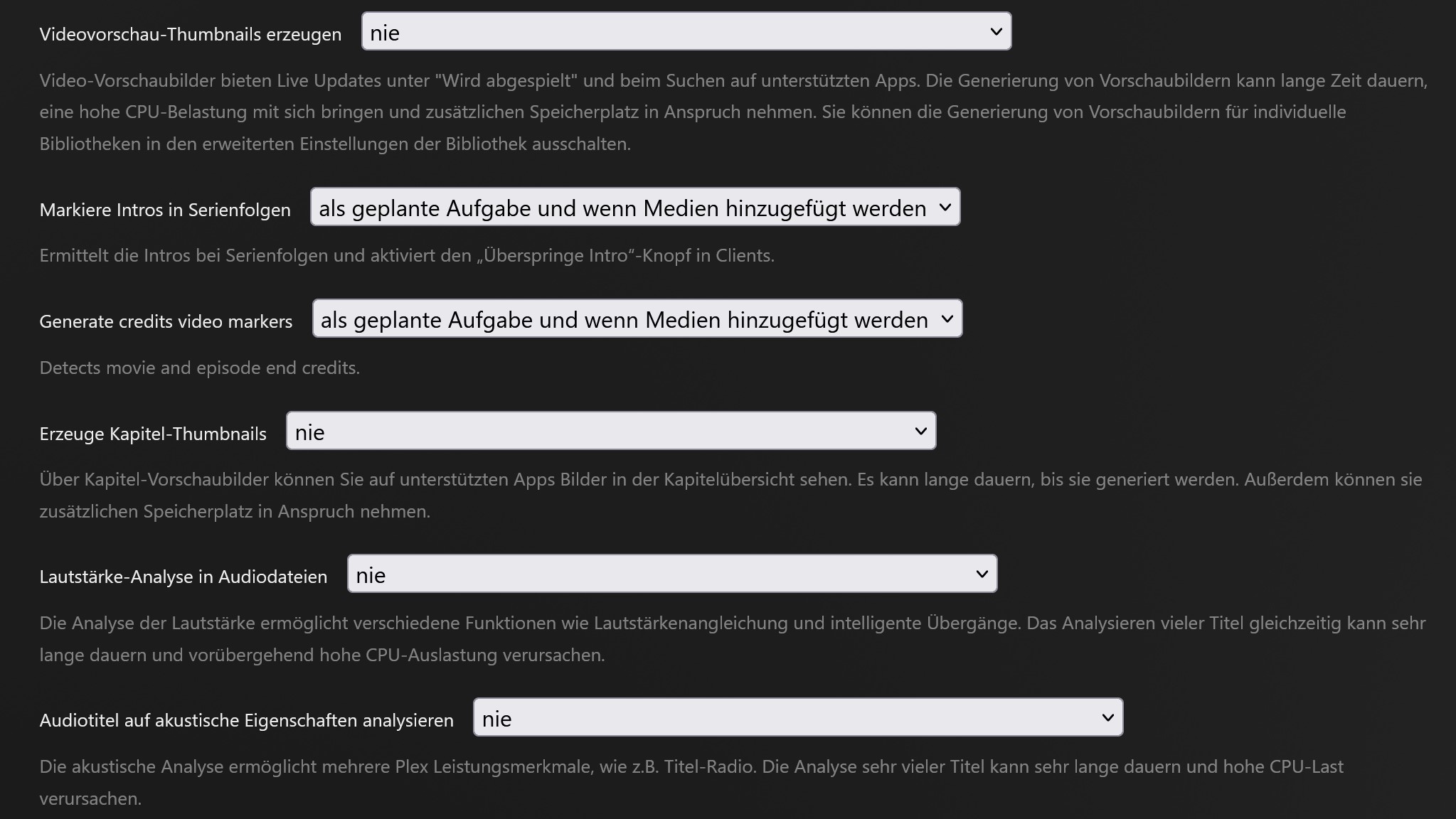

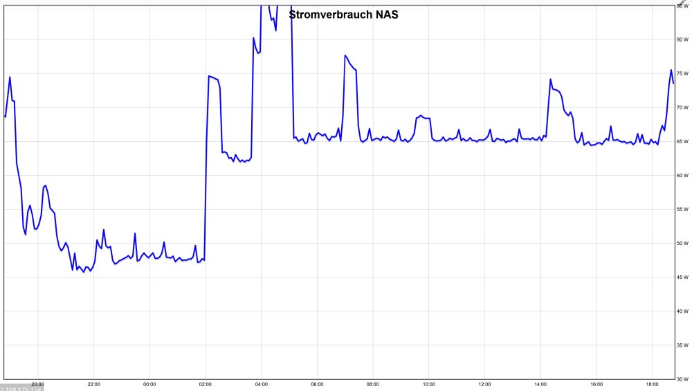

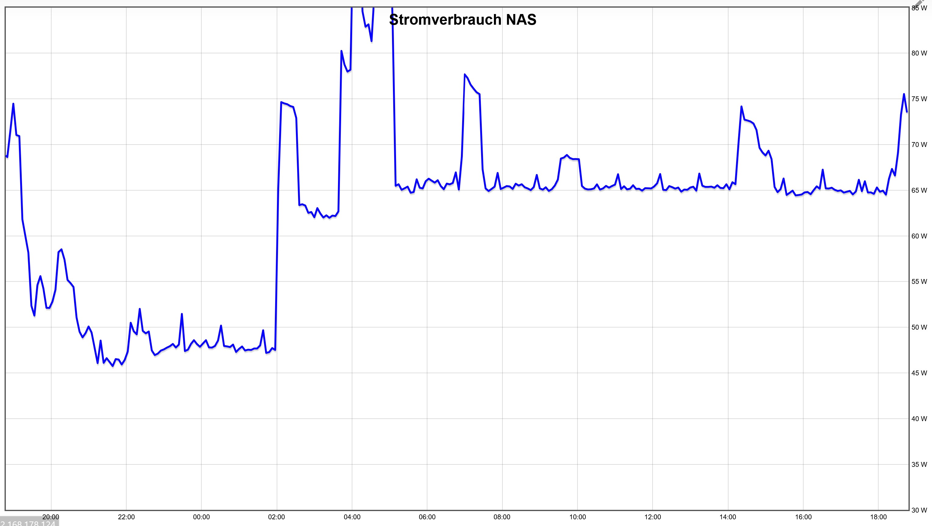

Master-Rudi Posted December 11, 2023 Share Posted December 11, 2023 Hello,  Since a few weeks my unraid have consumed a lot more power. It starts every day at 2:00 am and does not stop anymore.   I tried and tried a lot and noticed that Plex starts at 2:00 at the maintenance interval. I finished the Docker container Plex at 10:00 pm and the power consumption did not go up at night. For example, when I restart Plex at 8:00, the consumption will also go down again. I see that Plex uses the CPU because individual cores always go to 100% for a short time. I didn't have this problem in the past. Does someone know what is the reason for this and how I bring Plex out of the maintenance cycle? Something seems to be hanging here during maintenance, doesn't it? tried a lot and finally i regognized that plex is starten at 2:00 am it´s maintainance procedure.  Thaks in advance!!!    Quote Link to comment
alturismo Posted December 11, 2023 Share Posted December 11, 2023 18 minutes ago, Master-Rudi said: Something seems to be hanging here during maintenance, doesn't it? tried a lot and finally i regognized that plex is starten at 2:00 am it´s maintainance procedure.  Thaks in advance!!! Plex, Settings, Tasks ... ever looked there ?   also may take a look at some new Plex features ... yes, sometimes its good to read the changelogs and news from Apps you use  these tasks are very power consuming ...  Quote Link to comment

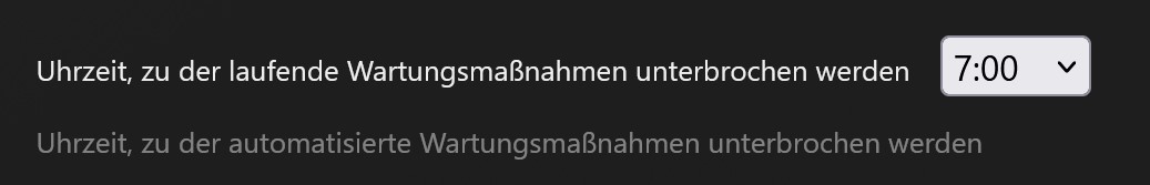

Master-Rudi Posted December 12, 2023 Share Posted December 12, 2023 Â @alturismo : I'm not sure, but I don't think it's because of it. I have not changed anything about the settings and have not active all settings. Â In addition, the maintenance should be stopped at 7:00 am and the CPU load and power consumption should also be reduced again. Â Â However, this does not happen. So I suspect something else, or what do you think? Quote Link to comment
alturismo Posted December 12, 2023 Share Posted December 12, 2023 4 minutes ago, Master-Rudi said: I have not changed anything about the settings and have not active all settings. Â 4 minutes ago, Master-Rudi said: However, this does not happen. So I suspect something else, or what do you think? that these are "new features" which wherent there before, so as "test" i would disable them and see if that makes any change ... after that, i would look into the Plex logs what is happening. Â Plex Webui, left side, buttom ... Protocol ... and look what is running there ... Â and look at the plex forums for help if there are errors. 1 Quote Link to comment

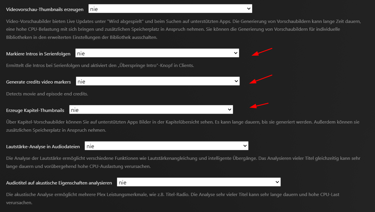

Master-Rudi Posted December 19, 2023 Share Posted December 19, 2023 On 12/12/2023 at 7:22 PM, alturismo said:  that these are "new features" which wherent there before, so as "test" i would disable them and see if that makes any change ... after that, i would look into the Plex logs what is happening.  Ok that worked... couldn´t believe it, cause i have been using it since the beginning and never had a problem. Thanks! 1 Quote Link to comment

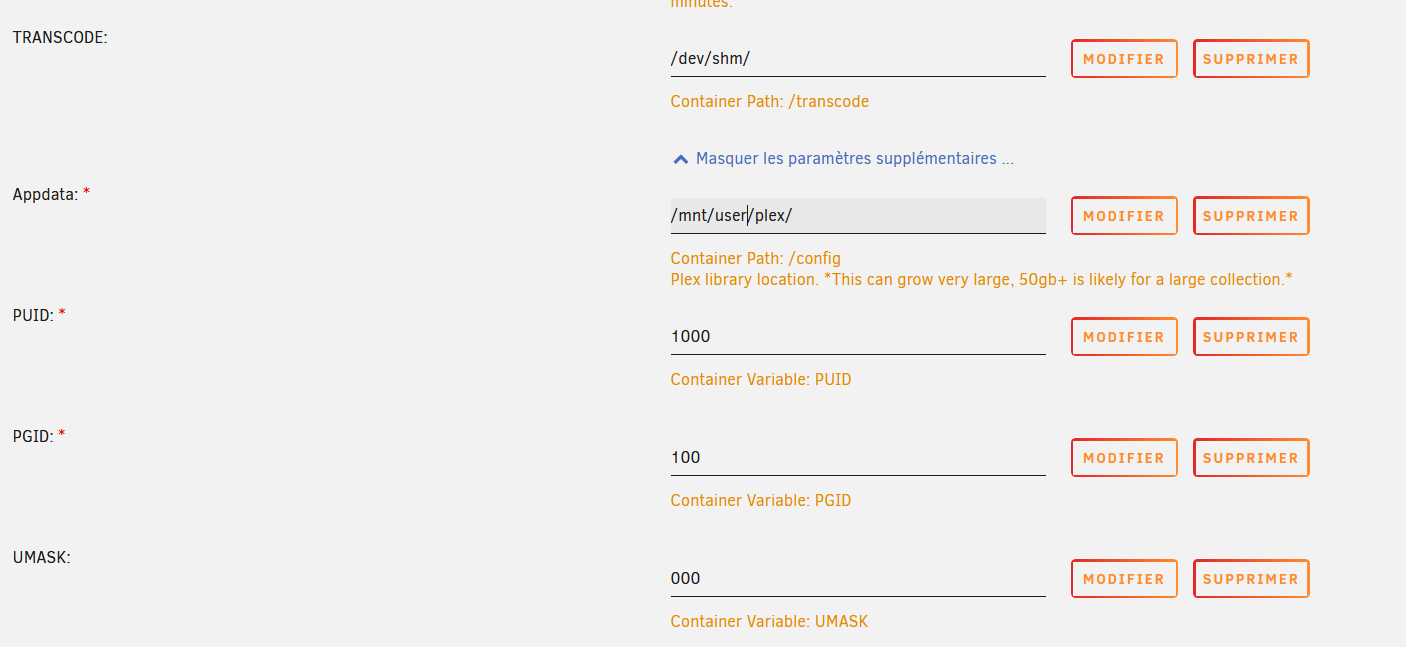

Fabix1984 Posted December 31, 2023 Share Posted December 31, 2023 Bonjour, Quelqu'un pourrait-il me dire si j'ai mal configuré mon conteneur, car je rencontre souvent l'erreur suivante : "Sqlite3: Sleeping for 200ms to retry busy DB". Plex a son propre disque NVME, et les applications tierces sont installées sur un autre disque NVME. Paramètres supplémentaires : --device=/dev/dri:/dev/dri --restart=unless-stopped. Si vous avez des conseils ou d'autres suggestions, je suis preneur, car je ne suis pas encore très familier avec le système Unraid. -------------------------------------------------------------------------------------------------------------------------------------------------------------------------------------------------------------------------------------- Hello, Could someone tell me if I have misconfigured my container? I often encounter the error "Sqlite3: Sleeping for 200ms to retry busy DB." Plex has its own NVME disk, and third-party apps are installed on another NVME disk. Additional parameters: --device=/dev/dri:/dev/dri --restart=unless-stopped. If you have any advice or other suggestions, I'm open to them, as I'm not yet very familiar with the Unraid system. Quote Link to comment
