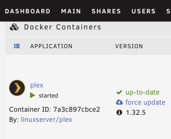

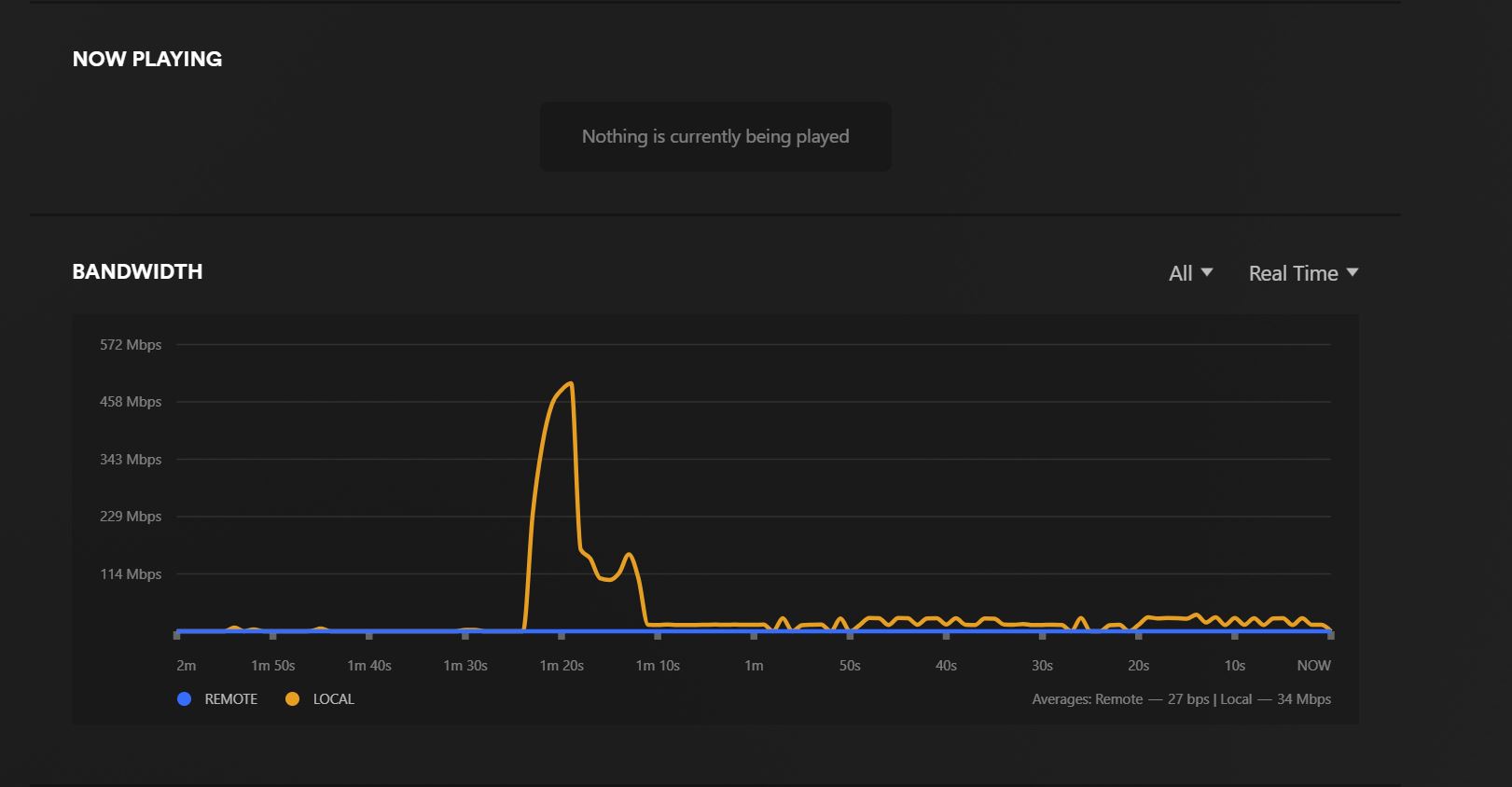

I downloaded 1.32.5
If I stream a movie directly nothing shows in my dashboard as playing anyone know why? Even though the bandwidth clearly shows something streaming.
Also if I stream directly i'm unable to fast forward and the incorrect length of movie is shown.
+0.19 -> -0.19
If I force a transcode by changing the resolution then it correctly shows up in the dashboard. The correct movie length also shows up. I really want to like unraid there are a bunch of features I actually like. But I can't seem to get ANY of the plex-server apps on unraid to work correctly. I think I have tried them all. Maybe its a quirk of running in Docker? Running on linux these issues do not exits. Is there any stable version on unraid that works 1/2 correctly? Any help is appreciated.

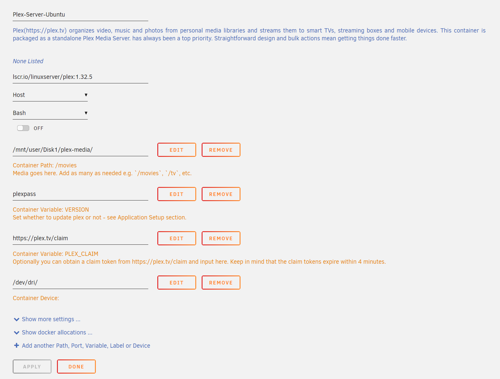

Lots of us have Plex dockerized running on unRAID with no problems mate...
Paste your Plex container template config here

Definitely a problem with your setup, not Unraid. Comments like "I really want to like Unraid, but......" are not going to engage people to try and help out. We're not here to motivate you to use a product. Your comments and what I've seen in your other topic is some lack of understanding the technology. Not a problem at all, but right now you're pointing at all other factors as the problem instead of your own lack of understanding.

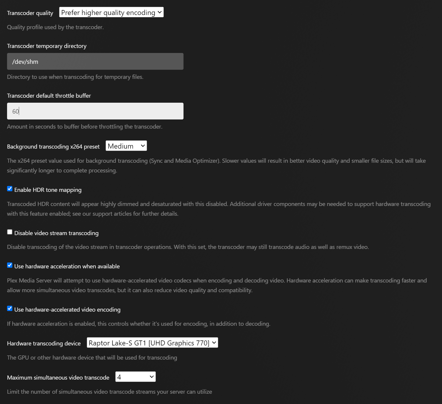

I'm running Plex on the latest Unraid stable version and also latest Plex version (plex pass) and my HW transcodes even still work. So I don't even have the issues the others here have.
- Firstly, in your own topic, I see that you're playing a file that has both audio transcoded and a PGS subtitle. PGS subtitles are always CPU transcodes, and single core at that as well. So CPU spikes during playback of such files is normal.
- Second, I'm not seeing your GPU stats, so I wonder which plugins you actually installed for your GPU? You should have the plugin "Intel-GPU-TOP". And with the plugin "GPU Statistics" you can see your GPU workload
- You're in the linuxserver Plex topic right now. So use that docker, not the other ones. After you've installed it properly and can access your Plex server, click on the Plex docker and then > console. Enter:
ls /dev/dri
What is the output in the console?
- How are you playing a video, like in the screenshot above? What device? What app?
- What are your Plex transcoder settings?

What you are seeing is just a general frustration with getting it to work. I am fully willing to accept something wrong with my config.  I am not new to plex or plex server I have been using it for a couple years. I am aware of how its supposed to work as I have set this up on ubuntu and have zero of these issues.
I am fully aware audio and and subtitle can cause cpu transcode of those files. However the video will still transcode in the GPU. I have no issue with these files transcoding in the CPU. It's a non issue. The workload to do that is very minimal.
/dev/dri -> shows up both card0 and render128
I use nvidia shield devices for playback because I have found they are the most compatible with video and audio codecs. These are all hardwired using 1GB ethernet. I am not trying to playback anything that hasn't been previously tested as fully functional under ubuntu plex-server.  Just trying to replicate the same results under a different OS.
A question on the video driver. Does unraid 6.12.4 not come with updated video drivers preinstalled? I missed "Intel-GPU-TOP" as it did not show up under the "driver" tab as an option to install. Maybe this is the issue.

For the internal Plex settings, try: both transcoder quality as hardware transcoding device on auto. And Background preset on Very Fast.
In the Docker template change "plexpass" to "docker". And did you make sure to use the plex claim function? Just checking, I expect you did and just put in the link for anonymization.
Another thing that is odd to me is that you are apparently using a Share called "Disk1"? Is that correct?
yea sorry I meant the latest unraid. 6.12.4. Type-O missed the 2 and the dot
For disk I didnt want to tear down my old system so I formatted a 2TB HDD just for Unraid testing. So yea the share disk is just disk1. Kinda slick that unraid boots from a USB and allows you to do that. Normally I keep the plex app data on a SSD and separate from the plex install so its just habit. That way you can tear down a plex install without having to rebuild the database. Helpful if you have thousands of movies. Here I am just building a new database and only have 1 movie in it for testing purposes. I haven't looked to see if any of this is possible with unraid version of plex but it would be something like

I have the Wan binding option unchecked. But yes I added the IP/subnet. So I don't think they would play at all if it tried to go to WAN. I also have a 1Gbps WAN connection so BW "shouldn't be" an issue anyway. Thanks for the suggestion though!
The video does direct play and it plays in 4k just fine. The issues is the video does not show up in the plex dashboard when direct playing. Also I get incorrect video length when direct playing on the shield plex player. If I try to fast forward the movie starts over from the beginning. If I force a transcode all these issues go away.

So I'm still doubtful about that Disk1. Normally you name shares after the files or category you store. A share name would be Media for example and the path would be /mnt/user/Media. So you are sure you have a share named Disk1 in which you have the folder plex-media?
And what library path do you use for the library which contains the files you're testing with?
yes. Disk1 is just the host path. under plex it gets mapped to /movies
The movie would not show up at all if this was wrong.
