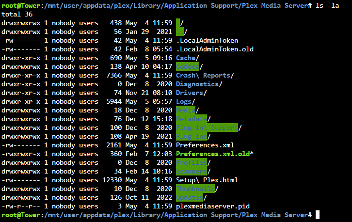

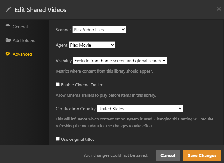

May 5, 20233 yr Hi all, I'm getting an error when trying to save library settings for the last few weeks. I'm simply trying to change the Visibility settings, but when I save it I get the error "Your changes could not be saved". Other than this, Plex runs perfectly. Thoughts? Posting the permissions of my plex appdata folder for reference. Thanks!

May 25, 20233 yr On 5/5/2023 at 2:44 PM, Andiroo2 said: Hi all, I'm getting an error when trying to save library settings for the last few weeks. I'm simply trying to change the Visibility settings, but when I save it I get the error "Your changes could not be saved". Other than this, Plex runs perfectly. Thoughts? Posting the permissions of my plex appdata folder for reference. Thanks! I've been having the same error. Checked permissions, switched from Plex official to LS.io, checked DB for errors etc and done a clean, rebooted the server... nothing worked.
May 26, 20233 yr 19 hours ago, supptora said: I've been having the same error. Checked permissions, switched from Plex official to LS.io, checked DB for errors etc and done a clean, rebooted the server... nothing worked. Last weekend I migrated from a Windows box to this container....everything went well, except for ONE of the libraries that got this error when I tried to change it (pathing). All other libraries worked fine. It wasn't that big of a deal as it was a little used library, so I just deleted it, and didn't use it. But, I couldn't figure out how to fix it either to make it work.
May 26, 20233 yr 4 hours ago, Thunder7ga said: Last weekend I migrated from a Windows box to this container....everything went well, except for ONE of the libraries that got this error when I tried to change it (pathing). All other libraries worked fine. It wasn't that big of a deal as it was a little used library, so I just deleted it, and didn't use it. But, I couldn't figure out how to fix it either to make it work. From a lot of research it seems to be a bug with Plex that's happened a few times over the years, but seems more apparent in the past few months. According to some posts, an update a couple of months ago was supposed to fix this, however there's a few posts since about it happening. I'm holding out for the next update to see if it fixes it, as people have had the issue with brand new installs on both Windows and Linux systems, normal exe and docker containers - plex, LS.io, binhex.

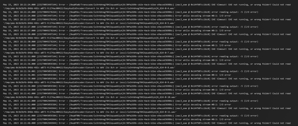

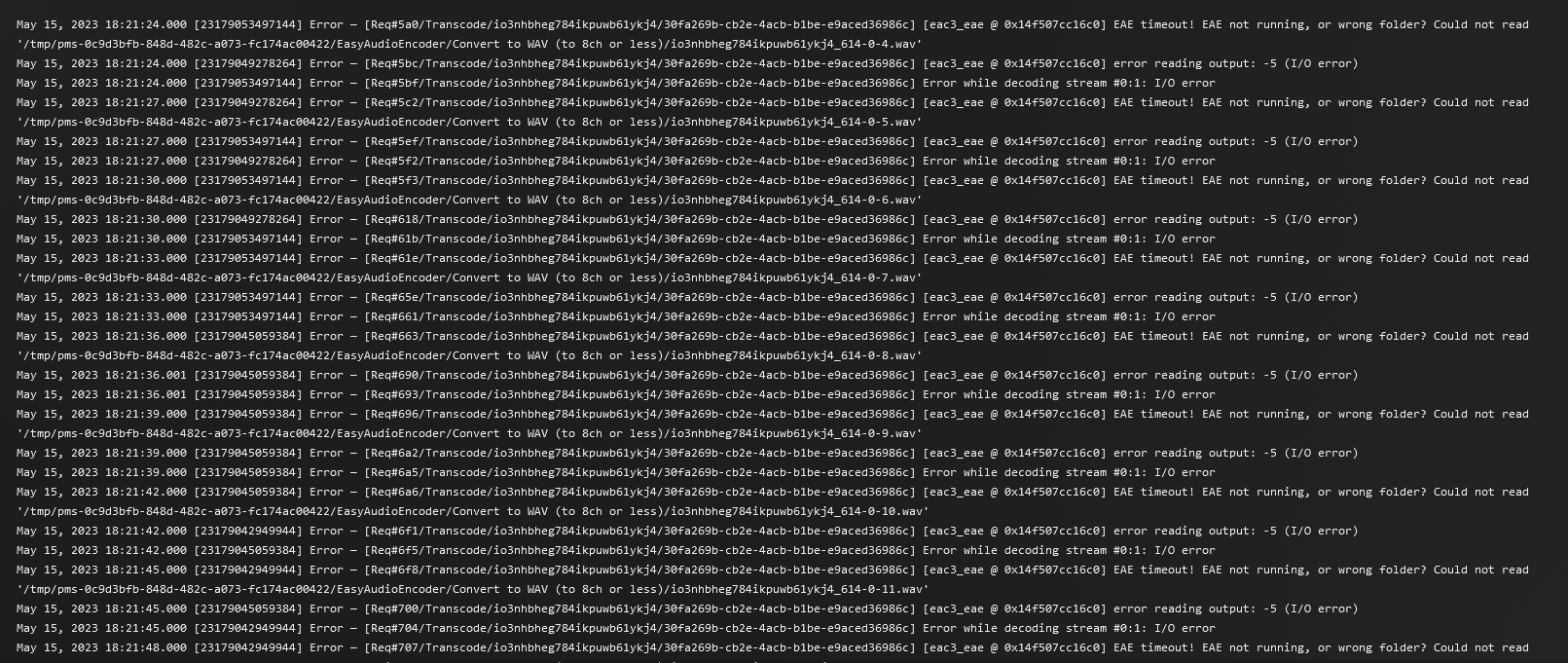

July 1, 20233 yr Has anybody here needed to delete their codecs folder every so often, sometimes a few times a month perhaps? The issue seems specific to EAC3, and I'm getting sick of stopping, deleting the Codecs folder, and restarting PMS. Noticed that playback just spins on clients, as if it's waiting to transcode, but nothing comes. Good old codec delete fixes this. I'm finding I'm doing it way too often.
July 1, 20233 yr On 12/15/2022 at 5:08 AM, gzibell said: Hey All, So just swapped a 1660 super into my server for plex transcoding. AMD system so no quicksync. When attempting to transcode a video via plex web the video will not start and I am seeing VAAPI errors in the logs. When I open the same video on my andriod and transcode it works just fine. The research I have done seems to indicate that VAAPI is related to quicksync and not nvdidia gpu. Any suggestions? I cleared codec folder. Have NVIDIA_VISIBLE_DEVICES, NVIDIA_DRIVER_CAPABILITIES, and --runtime=nvidia on the container with the appropriate values, plexpass version. Didn't have any issues transcoding on the 960 I had in the system prior. Seems to be new with the 1660. . Dec 15, 2022 05:51:33.794 [0x15083df5db38] ERROR - [Req#d79/Transcode] [FFMPEG] - Failed to initialise VAAPI connection: -1 (unknown libva error). Dec 15, 2022 05:51:34.314 [0x15083df5db38] ERROR - [Req#d79/Transcode] [FFMPEG] - Failed to initialise VAAPI connection: -1 (unknown libva error). Dec 15, 2022 05:51:34.828 [0x15083df5db38] ERROR - [Req#d79/Transcode] [FFMPEG] - Failed to initialise VAAPI connection: -1 (unknown libva error). Dec 15, 2022 05:51:35.366 [0x15083df5db38] ERROR - [Req#d79/Transcode] [FFMPEG] - Failed to initialise VAAPI connection: -1 (unknown libva error). Dec 15, 2022 05:51:35.823 [0x15083df5db38] ERROR - [Req#d79/Transcode] [FFMPEG] - Failed to initialise VAAPI connection: -1 (unknown libva error). Dec 15, 2022 05:51:36.262 [0x15083df5db38] ERROR - [Req#d79/Transcode] [FFMPEG] - Failed to initialise VAAPI connection: -1 (unknown libva error). Dec 15, 2022 05:51:36.495 [0x15083b24cb38] WARN - [Req#dcf/Transcode/xvyh2y66y68l0zw3zs4bgpjv] Transcode runner appears to have died. Dec 15, 2022 05:51:36.499 [0x15083d689b38] WARN - [Req#dcc/Transcode/xvyh2y66y68l0zw3zs4bgpjv] Transcode runner appears to have died. Did you ever find a fix for this? Im legit having an extremely similar issue. Expect I have a 1650 Super. GPU transcodes on all client players expect browser. If it is 'Converting', it will transcode very slow. If i set it to a specific resolution, i get the following error: [Req#2ae/Transcode] [FFMPEG] - Failed to initialise VAAPI connection: -1 (unknown libva error). GPU transcoding works great on all clients except browsers. Edited July 1, 20233 yr by FreeManFreeThinker
July 1, 20233 yr 13 hours ago, BOGLOAD said: Has anybody here needed to delete their codecs folder every so often, sometimes a few times a month perhaps? Corrupted codecs and needing to delete the codecs folder has been a thing with Plex for years. Though needing to do this a few times a month is a bit excessive. When I ran my Plex server on my daily driver Windows machine, I was maybe once every 6 months or so. Since I moved to Unraid (I run this LIO docker) I haven't needed to do it once. I would start thinking if there is something out of the ordinary for your Plex install. Unique encoding or container types, re-encoded files, over encoded files, oddball or over stressed/intermittent hardware, etc. Everyone's implementation and usage is different, so you are the best person to know what could be triggering this happening.
July 1, 20233 yr Has anybody here needed to delete their codecs folder every so often, sometimes a few times a month perhaps? The issue seems specific to EAC3, and I'm getting sick of stopping, deleting the Codecs folder, and restarting PMS. Noticed that playback just spins on clients, as if it's waiting to transcode, but nothing comes. Good old codec delete fixes this. I'm finding I'm doing it way too often.Never had a problem with the codecs on unraid. Using unraid for 3 years now.

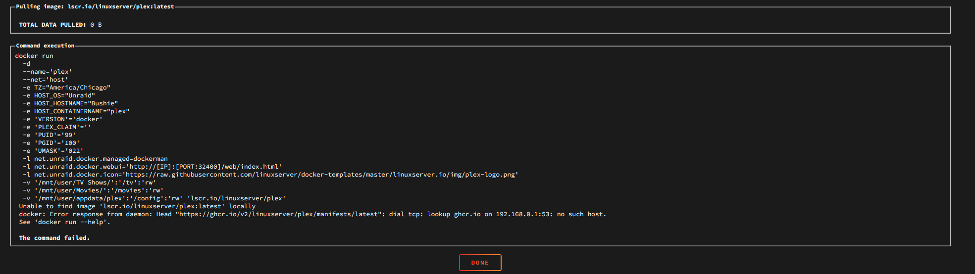

August 3, 20233 yr getting this error for linux plex. any guidance?plex Edited August 3, 20233 yr by Bushie_40
August 3, 20233 yr 27 minutes ago, Bushie_40 said: getting this error for linux plex. any guidance?plex can you ping ghcr.io from the unraid terminal ? looks like something is blocking you from accessing the source ? and adguard, blockers, ... running on your system ...
