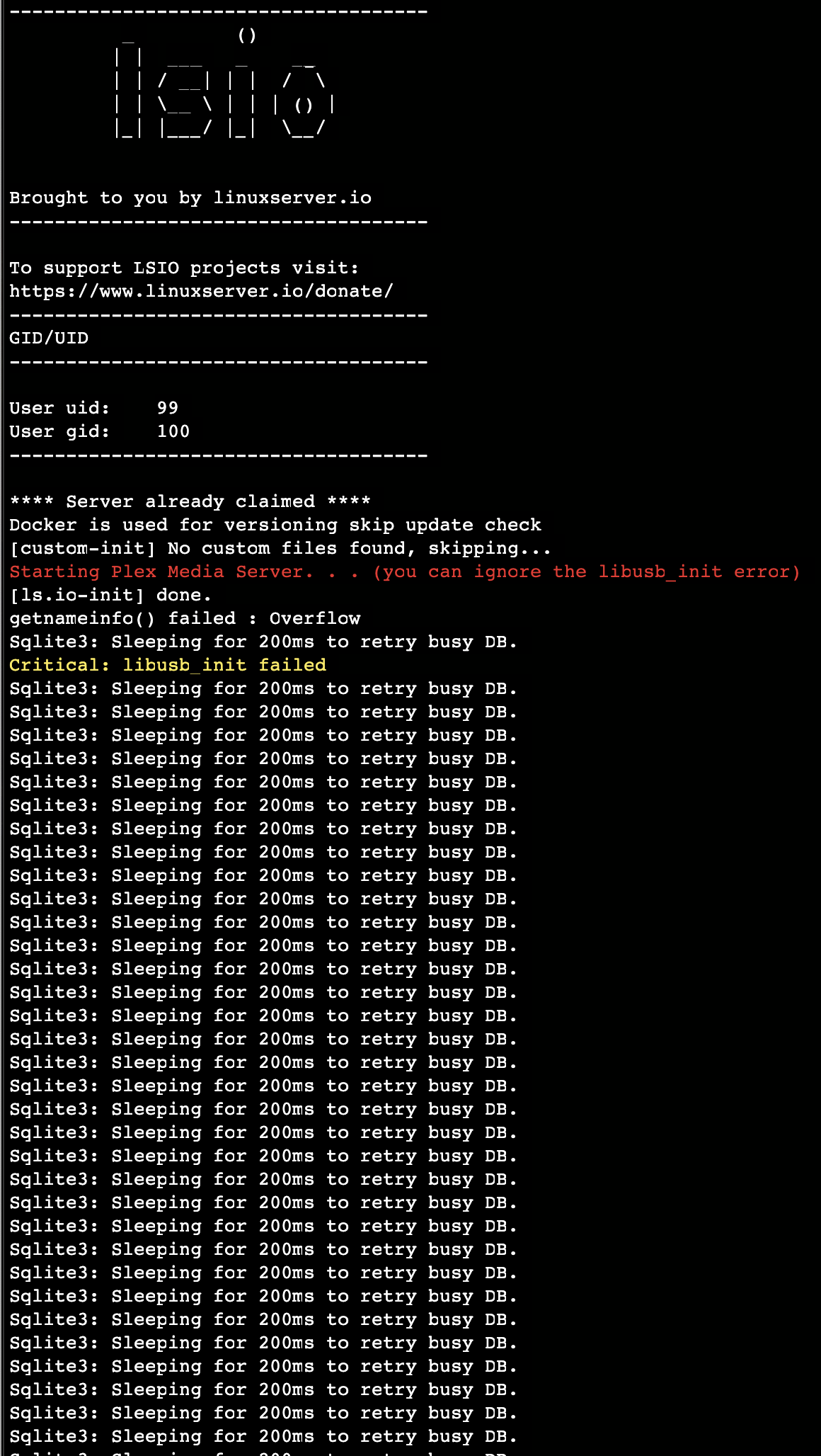

Luc1fer Posted January 26 Share Posted January 26 I updated my docker and it didn't come back up properly. I restarted it. The log now just shows: [migrations] started [migrations] no migrations found ------------------------------------- _ () | | ___ _ __ | | / __| | | / \ | | \__ \ | | | () | |_| |___/ |_| \__/ Brought to you by linuxserver.io ------------------------------------- To support LSIO projects visit: https://www.linuxserver.io/donate/ ------------------------------------- GID/UID ------------------------------------- User uid: 99 User gid: 100 ------------------------------------- **** Server already claimed **** No update required [custom-init] No custom files found, skipping... Starting Plex Media Server. . . (you can ignore the libusb_init error) [ls.io-init] done. When I go to https://ipadress:32400/web/index.html I just get: This XML file does not appear to have any style information associated with it. The document tree is shown below. <Response code="503" title="Maintenance" status="Plex Media Server is currently running database migrations."/> Any ideas where to go from here? 4 Quote Link to comment
ericup Posted January 28 Share Posted January 28 On 1/26/2023 at 6:04 AM, Luc1fer said: I updated my docker and it didn't come back up properly. I restarted it. The log now just shows: ... Any ideas where to go from here? I had the same issue. I downgraded to 1.30.2.6563 In linuxserver's container look for the variable labeled Version: and put in the version number, I had a tough time finding a good changelog so I used https://www.videohelp.com/software/Plex/version-history to find the version I wanted. 1 Quote Link to comment
kolepard Posted January 31 Share Posted January 31 On 1/26/2023 at 4:04 AM, Luc1fer said: I updated my docker and it didn't come back up properly. I restarted it. The log now just shows: [migrations] started [migrations] no migrations found ------------------------------------- _ () | | ___ _ __ | | / __| | | / \ | | \__ \ | | | () | |_| |___/ |_| \__/ Brought to you by linuxserver.io ------------------------------------- To support LSIO projects visit: https://www.linuxserver.io/donate/ ------------------------------------- GID/UID ------------------------------------- User uid: 99 User gid: 100 ------------------------------------- **** Server already claimed **** No update required [custom-init] No custom files found, skipping... Starting Plex Media Server. . . (you can ignore the libusb_init error) [ls.io-init] done. When I go to https://ipadress:32400/web/index.html I just get: This XML file does not appear to have any style information associated with it. The document tree is shown below. <Response code="503" title="Maintenance" status="Plex Media Server is currently running database migrations."/> Any ideas where to go from here? I've seen this with several updates. In each case if I give it enough time it goes away, so my presumption is that it actually is doing some sort of database migration. With this most recent update it took long enough to make me nervous, but after a bit over an hour it disappeared and Plex started running normally. Does anyone know what is really going on? It doesn't seem like there would be very frequent database migrations, but I don't really know. Kevin Quote Link to comment

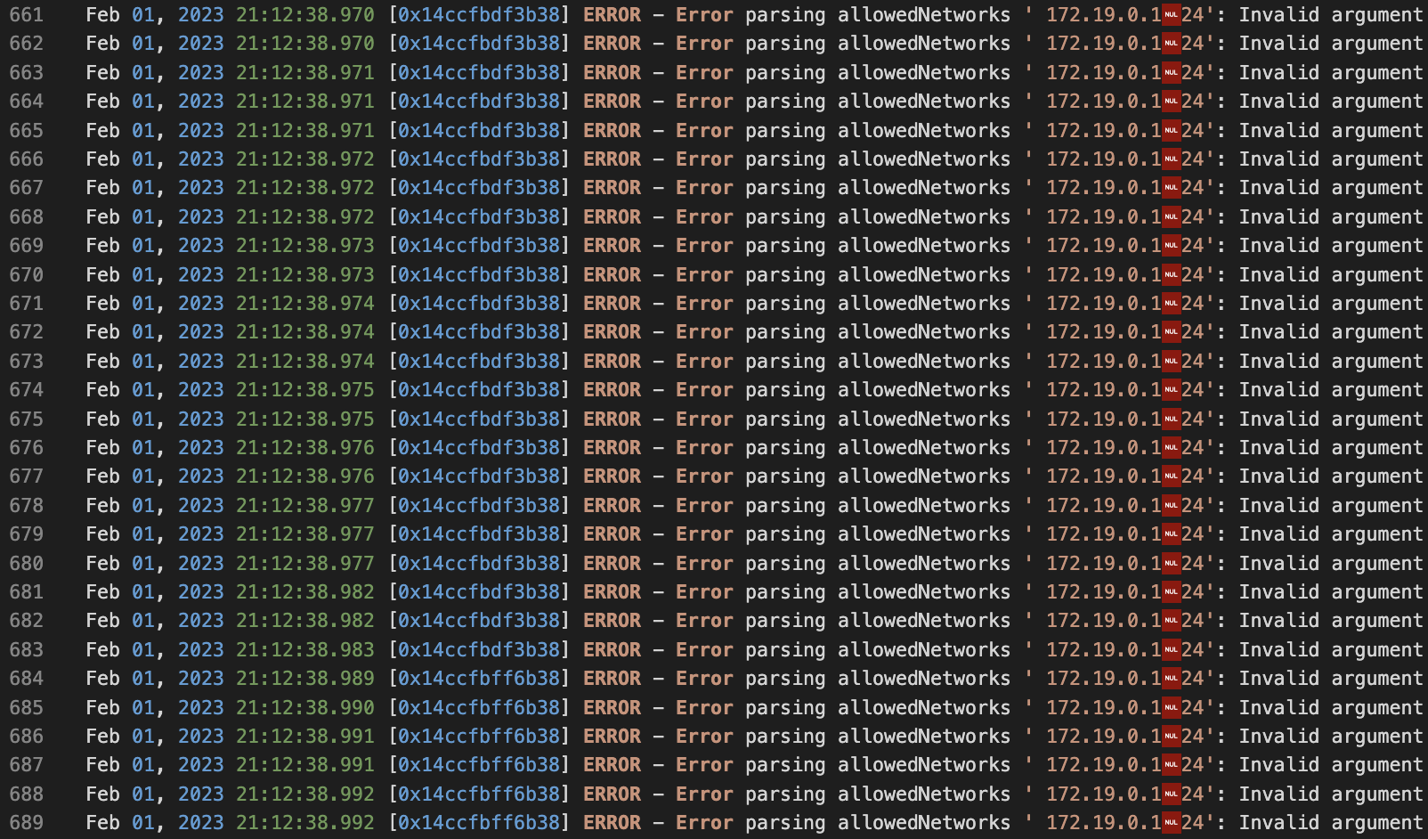

jackfalveyiv Posted February 2 Share Posted February 2 On 1/26/2023 at 7:04 AM, Luc1fer said: I updated my docker and it didn't come back up properly. I restarted it. The log now just shows: [migrations] started [migrations] no migrations found ------------------------------------- _ () | | ___ _ __ | | / __| | | / \ | | \__ \ | | | () | |_| |___/ |_| \__/ Brought to you by linuxserver.io ------------------------------------- To support LSIO projects visit: https://www.linuxserver.io/donate/ ------------------------------------- GID/UID ------------------------------------- User uid: 99 User gid: 100 ------------------------------------- **** Server already claimed **** No update required [custom-init] No custom files found, skipping... Starting Plex Media Server. . . (you can ignore the libusb_init error) [ls.io-init] done. When I go to https://ipadress:32400/web/index.html I just get: This XML file does not appear to have any style information associated with it. The document tree is shown below. <Response code="503" title="Maintenance" status="Plex Media Server is currently running database migrations."/> Any ideas where to go from here? I'm also experiencing this. No updates to the docker, and it was running fine earlier today (maybe around noon time). I'm seeing a series of the attached error messages in the logs. I found a link to an old Reddit thread suggesting that I make a change to the network settings in Server settings. The strange thing is I can load Plex in the browser, but content will not play and I can't get at any settings to make changes. I don't recall ever entering any IP address or range into the server settings. Quote Link to comment
Luc1fer Posted February 2 Share Posted February 2 On 2/1/2023 at 5:08 AM, kolepard said: I've seen this with several updates. In each case if I give it enough time it goes away, so my presumption is that it actually is doing some sort of database migration. With this most recent update it took long enough to make me nervous, but after a bit over an hour it disappeared and Plex started running normally. Does anyone know what is really going on? It doesn't seem like there would be very frequent database migrations, but I don't really know. Kevin It's funny you should say that, because I posted this message and went to bed while I waited for guidance. By the morning it had "fixed" itself. It would be nice to know what it is doing. Maybe a warning that it will take a while and to wait, as I rebooted the docker a few times and force updated it which probably only served to slow things down. Quote Link to comment

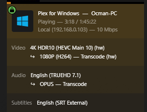

Ocman76 Posted February 2 Share Posted February 2 Hi all, I have had hardware transcoding set up with my server’s i5 -11400 for a few years now with no issues. Today I am suddenly getting the following error message (~30 seconds after starting a transcode): Server Version#: 1.30.2.6563 (Linxserver.io Docker, Unraid 6.9.2) Player Version#: Multiple (Web, Windows Desktop, Android) This does not occur all the time, but does occur every time I try to transcode 4K content and only some of the time with 1080p content. When I start trying to transcode the video playback stops, and ~30 seconds later I get the error. From the server playback view nothing appears to be wrong. Hardware transcoding is shown and the time for the video playing continues to pass even though the screen is blank. There is about a 30 second period between when I start transcoding and the error message shows up. In addition I am seeing much higher CPU usage during my attempts to transcode than I normally see when hardware transcoding is working properly. I have confirmed this happens with both remote and local connections to my server, and across windows desktop client, web client and android (which makes sense as the transcoding issue appears to be happening on the server, not client side). I already tried uninstalling and reinstalling the plex docker but no luck. Any help is greatly appreciated. Quote Link to comment

jackfalveyiv Posted February 2 Share Posted February 2 To follow up, my server is operating correctly and the logs are no longer showing these errors. If this is related to some sort of db migration like previous commenters have suggested, I hope Plex develops a method to control this action or at least schedule it for off-hours. Quote Link to comment

jackfalveyiv Posted February 2 Share Posted February 2 The problem has returned, and I suspect around the same time as it did yesterday. Any ideas on what's causing the issue? Quote Link to comment

Ocman76 Posted February 3 Share Posted February 3 15 hours ago, trurl said: Does it occur with some specific files and not others? It happens with on most transcodes but always with 4K ones. ChuckPa on the plex forums has confirmed its a bug they are working on fixing: https://forums.plex.tv/t/quicksync-hardware-transcoding-error-4294967279/829247/6 Quote Link to comment
