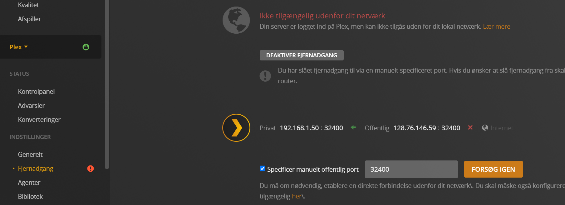

  • Dear Plex User, We have recently experienced a security incident that may potentially involve your Plex account information. We believe the actual impact of this incident is limited; however, action i
  • Go to the appdata share and look in Plex\Library\Application Support\Plex Media Server\Crash Reports You will find folders for your previous versions named as the release version.
  • Yep, seems like the problem.   Not to be outdone... google.  And what do I find.... Hoopster's post from over a year ago. I see your post here regarding the iGPU not being enabled corr

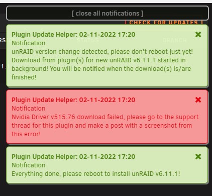

Hi all.
I'm having a problem updating unRAID from 6.10.3 to 6.11.1.
After doing the unRAID update, I get the following error:
The first time I tried to update unRAID, I rebooted and started the array. My Plex docker didn't start, so I tried to start it and it errored out, then the docker became abandoned. I restored unRAID back to 6.10.3 from my backup and restored my Plex docker.
I tried updating unRAID to 6.11.1 again and got the same Nvidia Driver plugin error.
Has anyone else gotten this error?
This time I will try going into the Nvidia plugin settings page, after rebooting for the update, and updating the plugin. Hopefully that's all it takes.
I've attached my diagnostics file for your review.
Any help is appreciated.
threadripper19-diagnostics-20221102-1728.zip
Spoiler
I was able to get my Plex docker to work after updating unRAID to 6.11.1.
After rebooting my server for the 6.11.1 update, I had to go into the nvidia drive plugin page and update & download the driver, then reboot my server again.
Once I did all that, I started my Plex docker and it worked perfectly.

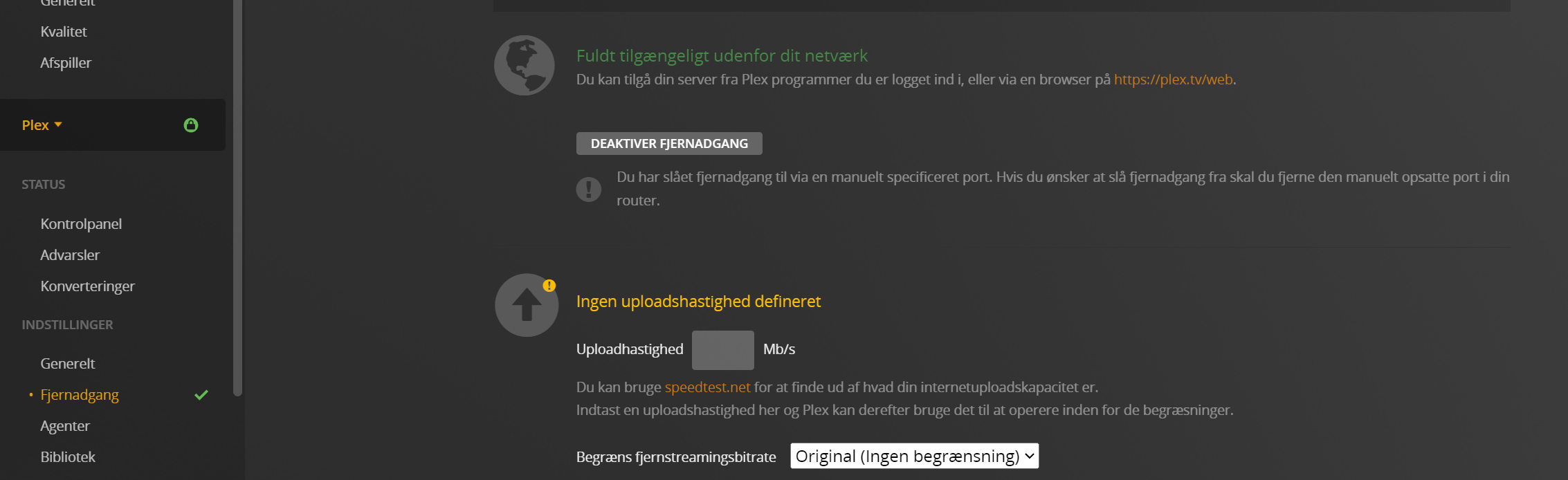

Hi all.
I can see somebody had this problem before.
I just tryed to reset my password and make a new token claim (signed out of all devices)
Checked all portforward.
Very wird i have been running plex in windows for years and never had this problem before.
I know it is danish hope it is okay.
It is like unstable in the connection. Works from outside my lan, then it wont work. Then work. What good things cut i try?
Plex:
Another try 1 min after
