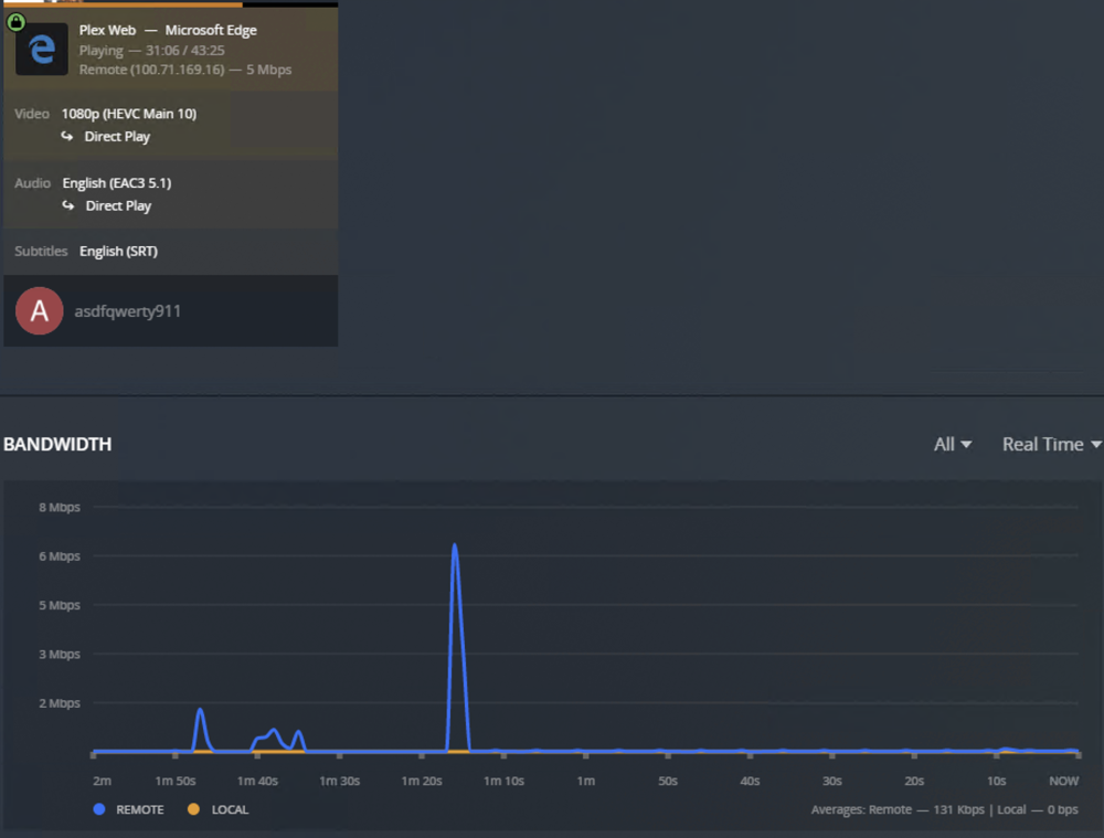

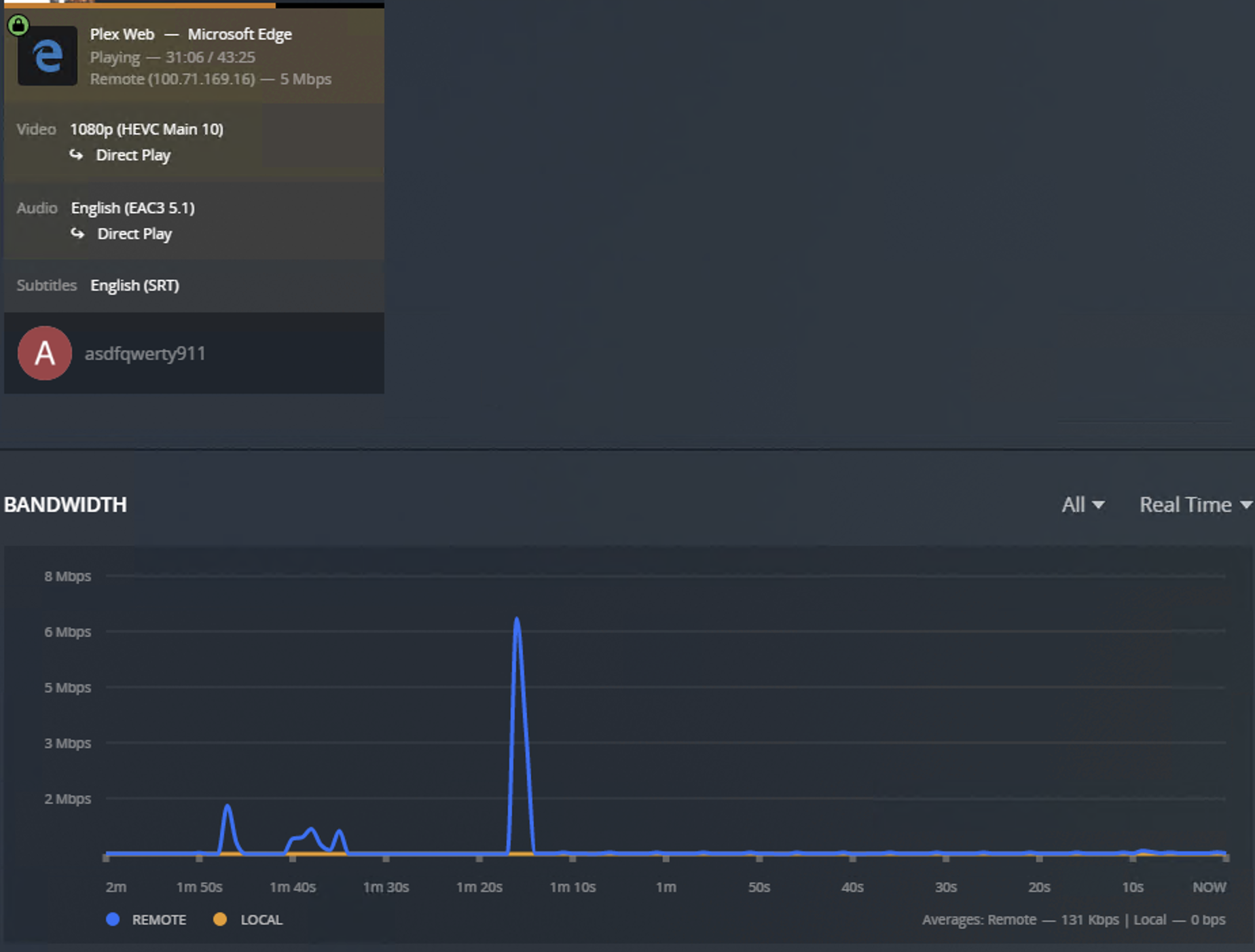

All web clients are failing to stream content from my plex server. When I try to play content on a web browser (Edge), plex shows a spinning wheel like its buffering, but nothing ever streams. This is true for all files in my library. This started in the last couple of days, but I haven't made any explicit changes in that time, so not sure what is causing the issue. Things I've done to try to resolve the issue
- Restart Plex container
- Checked database integrity (came back `ok`)
   - used the following command to check
./"Plex SQLite" "/mnt/user/appdata/plex/Library/Application Support/Plex Media Server/Plug-in Support/Databases/com.plexapp.plugins.library.db" "PRAGMA integrity_check"
- Ran the following cleanup: Clean Bundles, Empty Trash, Optimize Database.
I've poked around the logs (attached), but am a loss at what specific steps to follow to pin-point and resolve the issue.
Any guidance would be appreciated!
Web Player Version 4.95.2
Server Version 1.27.2.5929
Thanks!
Plex_unraid_stream_issue.log
Thanks!
Weird thing is, Plex thinks it is playing successfully, but that isn't the case (and you can see there is no remote traffic)   image.thumb.png.3c5977765c09beb22f21747b89027355.png
