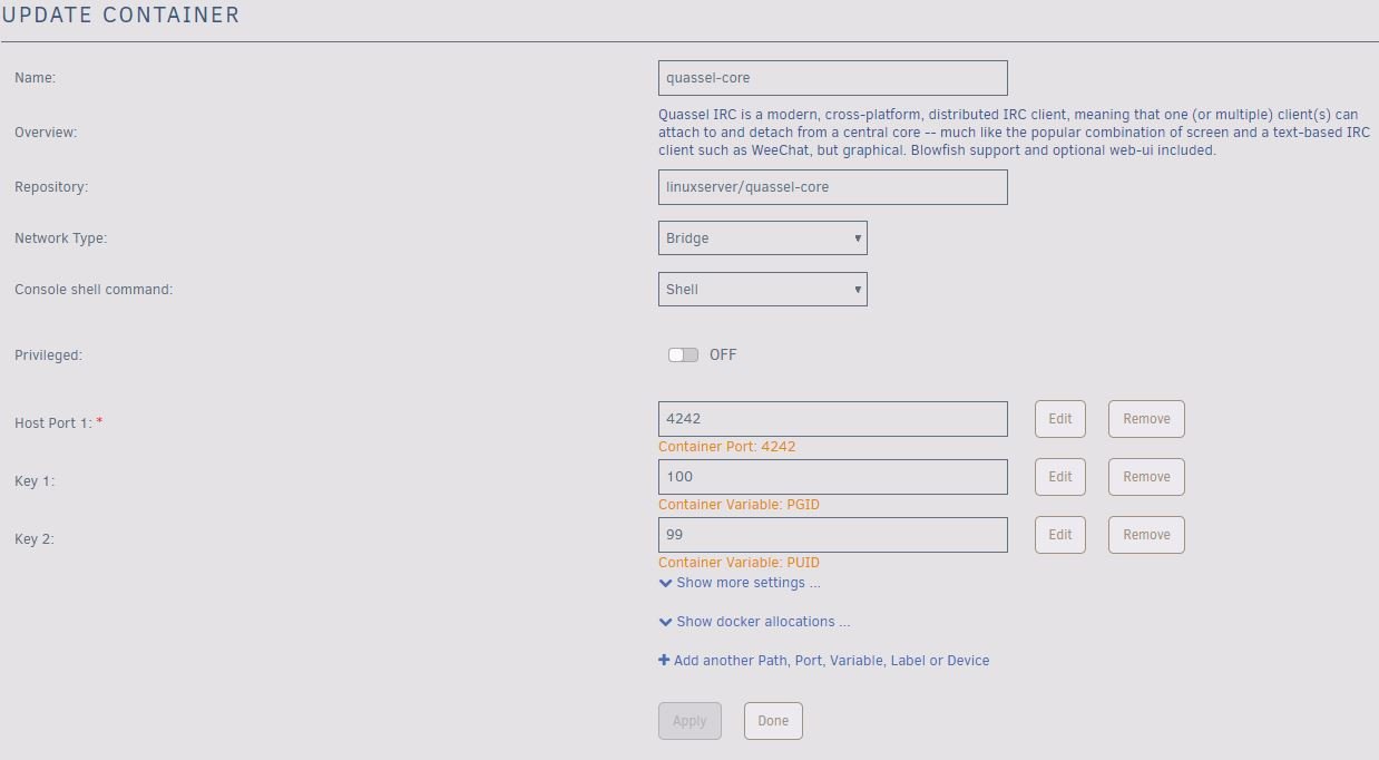

I'm new to unraid and dockers.  I'm coming from the world of windows and mirc.  I installed community apps and searched for irc and found 2 versions of quassel core.
quassel core
linuxserver
Network:Messenger
Quassel core
xamindar
Network:Messenger
I tried both versions but don't see an option in how to run it under the docker tab.   See attached for what I see.  How do I run this?
quassel-core2.thumb.JPG.b430e8cb8a71b427516898cff92df4f2.JPGquassel-core1.JPG.730bf591089516cc9f334b638816bf9e.JPG
