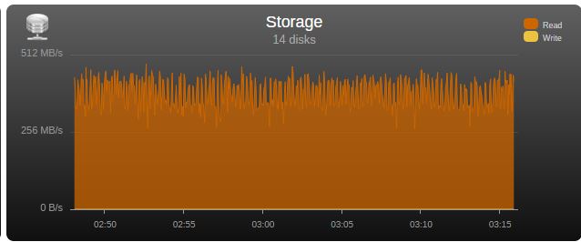

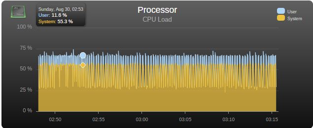

I actually just got the SAS2LP card to replace my older SASLP.  After swapping my parity checks went from 75-80 down to 35-40 MB/sec.  This is the case for 6.01 and 6.1  Tonight I just rolled back to V5.0.5 to test and the parity check was averaging 85 MB /sec.  So with all the hardware the same, there is something clearly different between the updates.
The only other thing I will add is I took these charts off my V6 with the SAS2LP installed and the CPU / drive speed jumps, its not consistent.  It was not like this with the SASLP card installed.  I wish I had kept those graphs but can get them in a day or so when I swap the card back.
Anyway, I really just want to know if its on the radar to solve. If so I'll wait patiently and help if I can.  If not I don't want to hold on toa $100 card for nothing.
