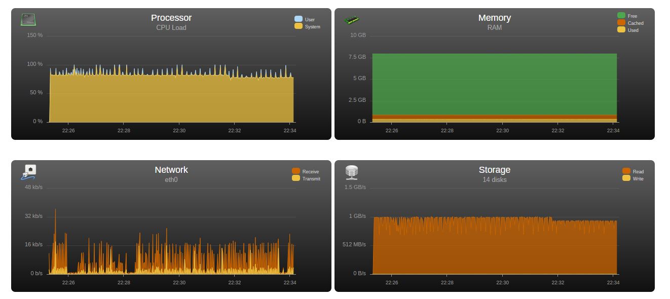

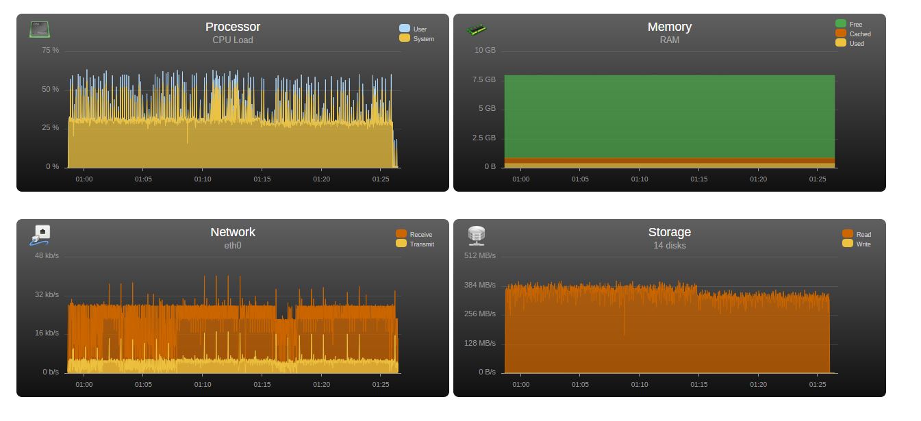

OK, I'm not sure how useful this is but I think it's noteworthy.
Earlier today I posted some copies of my system stats graphs during a V5 and V6 parity check with the SAS2LP installed.  It was not showing any appreciable difference in CPU usage, but the speeds of course were half(ish) between V5 and V6.  The graphs also show the CPU cycling during a parity check in V6, not in V5.  However it also did it at rest in V6 so I as assuming the cycling behavior had nothing to do with the card.
This evening I swapped back to the SASLP card and re-ran a parity check.  The speeds went from the 30's to the 80's, that was expected.  However: With the SAS2LP card in V6, the CPU utilization cycled form ~ 30% to ~65%.  With the SASLP card in V6 CPU utilization was ~ 80% with spikes to 100%.  When my first small (32 GB) drive drops out, you see a slight drop in CPU usage and slight increase in speed to around 90.
So as speculated earlier, the CPU cycling may be connected to this issue, but my guess is, that it has to do with how fast the data is getting off the card to the CPU, its coming through in batches not a smooth flow.  Anyway.  I'm above my pay grade and in speculation mode now...  So I'll stick to providing what might be some useful information.
Bottom line:
V6 w/ SAS2LP:
Parity check in the 30's MB/Sec
CPU Usage cycles from ~ 30 to ~ 65.
V6 w/ SASLP
Parity check in the 80's MB/SEc
CPU Usage at a solid 80 with spikes to 100.
Graphs below:  You can see in both the slight change when the 32 GB SSD drops off.
2015-09-07_V6_SAS2LP_CPU_During_Parity_check.JPG.f81669d5f7fa3800d0ac3cde97ea9d48.JPG
