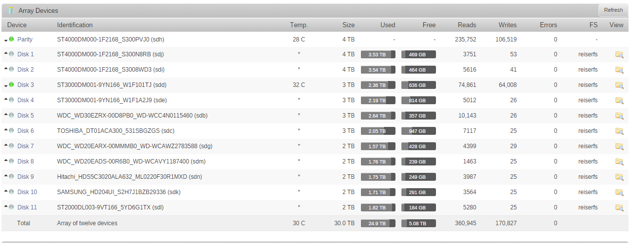

I was planning on making more tests before posting but I did find what looks like a correlation between the total number of reads and the speed of a parity check, i'm not talking about the different individual disk read numbers that we all assume are normal, but the total read numbers for the same array at the end of a parity check, for example:
version - avg speed - total reads
v6b1 - 125.1 - 2.612.645
v6b14 - 69.7 - 5.249.593
v.6.1.1 - 51.8 - 7.595.330
i'm going to compare all betas to confirm if it's true for all, also plan to test with a different controller like a SASLP to check if read numbers also change with different versions.
It makes sense that more reads = more i/o's = less speed, but this issue doesn't make much sense, so who knows, also have no clue why there's such a big variation and if anything can be done to change it.

By the way, that drive that red balled when I was doing a parity check rebuilt %100 and is running fine. I ran a long SMART test on it with no errors.
