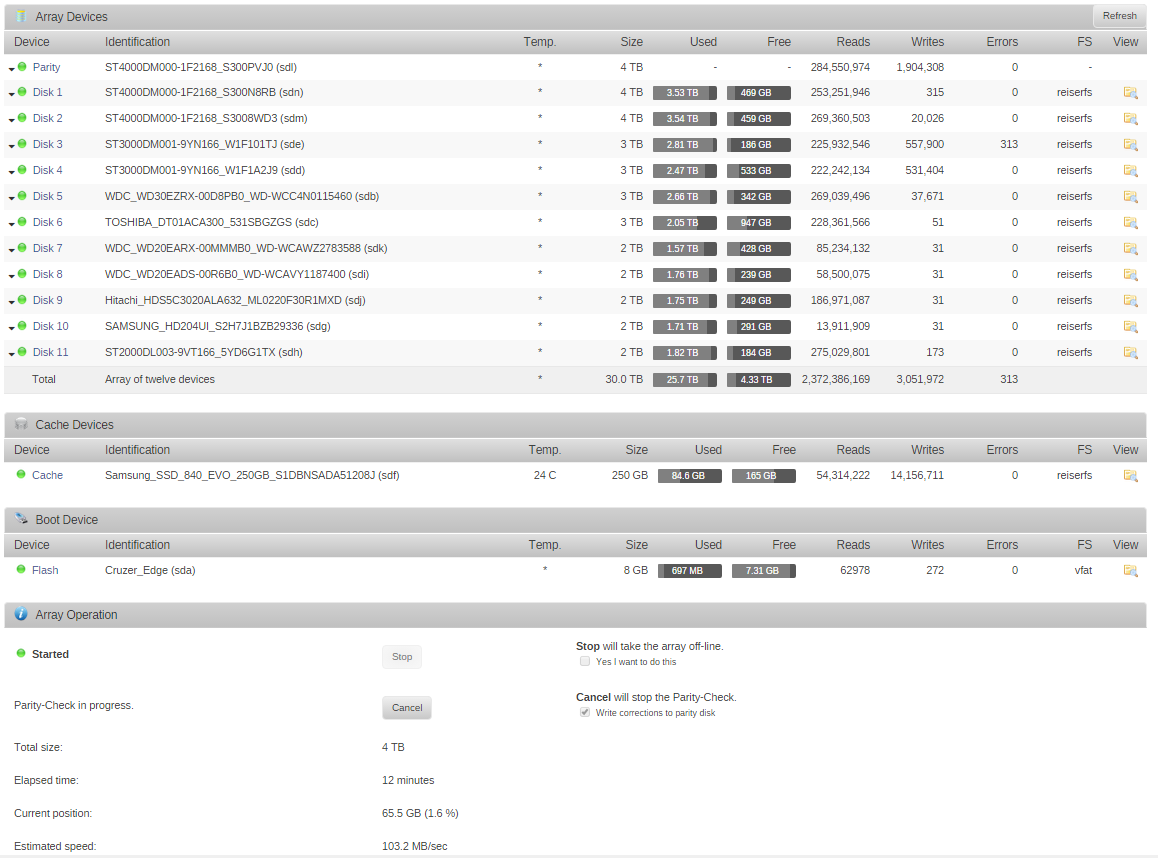

I don't have any SATA controller cards in my system but just as a reference point I just did a Parity Sync  and Parity Check on a new config for my #2 Server, see below.
The parity sync took 5 hrs, 7 min, 10 sec, avg speed 108.5 MB/s.
The parity check took 5 hrs, 5 min, 22 sec, avg speed 109.2 MB/s.
So my check, correcting, was slightly faster than the sync.
My older, 6 yrs old, 1tb drive must be a lot slower than the newer 2TB drives because once it gets past it the speed goes from 63 MB/s or so to more than 115 MB/s.
... My older, 6 yrs old, 1tb drive must be a lot slower than the newer 2TB drives because once it gets past it the speed goes from 63 MB/s or so to more than 115 MB/s.
Clearly the older drive has much lower areal density ... it's likely a 500GB/platter unit (or perhaps even 333GB/platter).    Your newer 2TB drive is almost certainly a 1TB/platter drive.

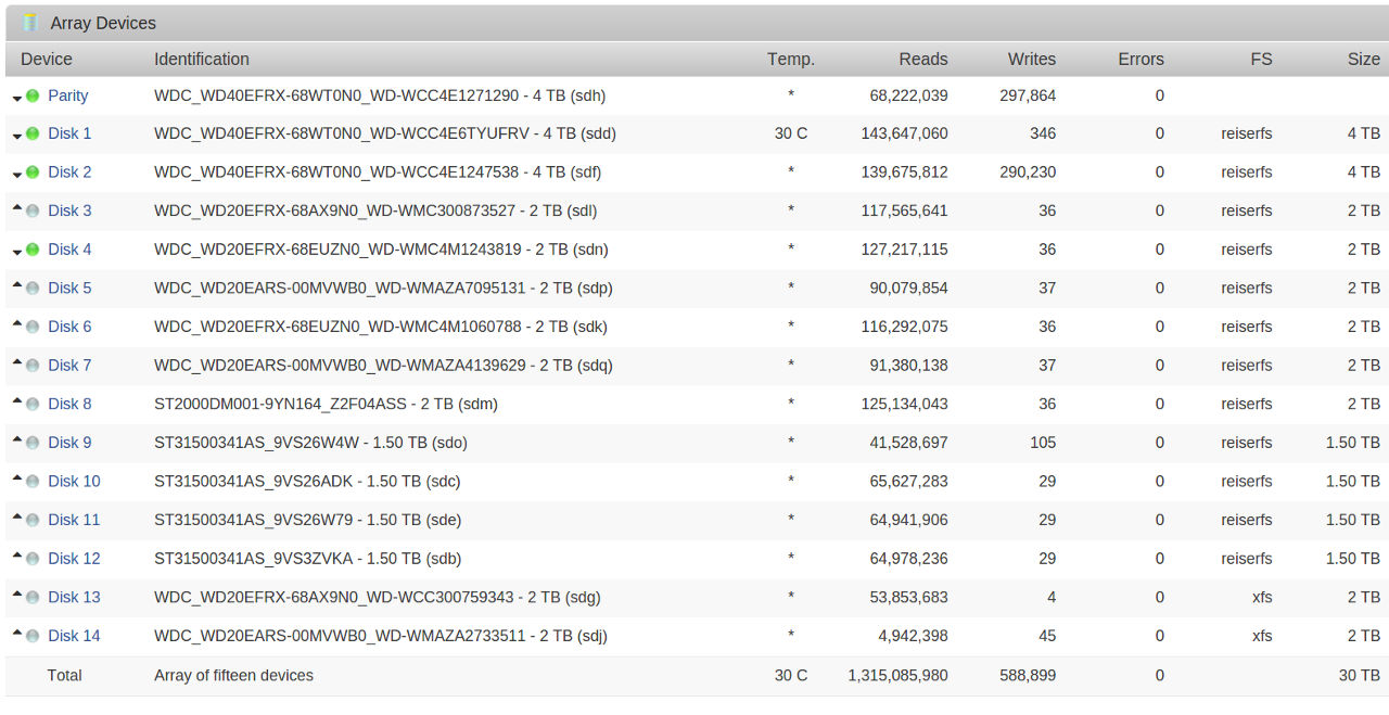

I have 3x3TB and 5x2TB drives on my card, as well as 3x4TB and 1x3TB on motherboard SATA ports.  I applied the above changes and instead of starting sync at 40MB/sec, I was getting 105MB/sec.  The Storage graph on System Stats page showed throughput of about 1.25GB/sec when before it maxed out around 750MB/sec.
HOWEVER, 3 minutes after starting the parity check, it slowed down to 40MB/sec for a few minutes, and now is back to 95MB/sec.
My last parity check had an average speed of 65.7MB/sec - I will report back when the current one finishes with the new result, fingers crossed.

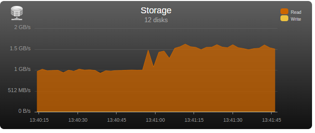

Another server with 11 disks total, 4 on the SAS2LP, you can see the jump in the graph as I entered the commands:
... This will limit the requests each hdd (in the array) is trying to handle at a time from the default 128 down to 8.  No need to run it on cache devices and/or SSDs.  This seems to make a HUGE difference on Marvell controllers.  I suspect earlier versions on Linux (hence unRAID 5.x) had lower defaults for nr_requests.
